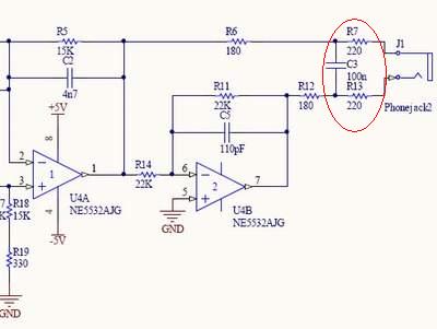

              Here is SD2000 audio output. I assume GP series couldn't vary much in this stage, most probably those have pretty similar audio stages. So, on this particular schematic; lowering R7,R12 and R13 (do experiment very carefully with R7 !!!) i am sure this audio stage can drive directly speaker . So instead headphones; high impendance speaker can be plugged in to socket. On second thought; more better is to add audio driver, MPSA13 or simillar, base via 27k to pin 7. on NE5532JG, collector via 22ohms to plus rail, emitter to speaker + and gnd to speaker -. There is plenty room inside GP box for so few components.

                        Ivconic, The audio cct on the gp is kind of similar to the 2000 but not the same. It is best not to try and get more from the existing audio cct. The problem is if you start drawing more current from the internal +-5v supplies you will effect the operation of the other ccts and start causing inter modulation. If an external amp is used running off the detector battery, it must be connected using a high impedance audio transformer or capacitors in series with the audio lines. The amplifier will be on a different voltage level as to what the detectors internal amplifier runs at which is why the transformer or caps must be used. Alternatively if a small amp is made up and runs off of its own battery the audio can be directly coupled to the amp.

                            Conventional audio driver, like on other machines, can pull descent momentum current and affect supplying on the rest of machine.
                            Also speaker can produce loopback interferences and intermodulations through power lines.
                            To void that; more serious approach is desired. I would experiment with Musketeer/Relic Hawk audio kind, including famous (mentioned few times here on forums) audio transformer. Such audio driver usualy can pull not more than 15-20mA with strong signal and less than 10mA with average signals. Hopefully it will not affect much power supply.
                            Of course; audio should be supplied directly from accu, from own regulator, but not through existing regulators on GP.
                            However, all this means more components and more space. Additional box than should be considered.

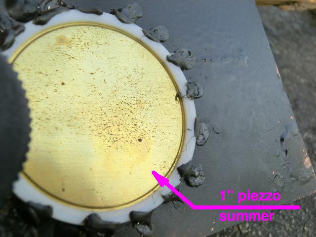

                              I am trying to avoid this by using metal housing and pop-up bigger (5cm dia) piezo ceramic summer outside.
