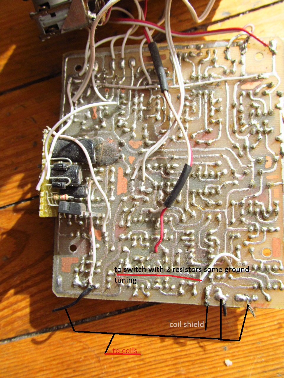

    Hello, I have(had) an old but nice detector, after i gave it to friend it came back like this.
    I don`t know where to connect the power suply, the coil(s), etc...
    In two words I want to put it back together. Will appriciate any help.
    The IC in red is with broken leg
    linking photos:
    This will be hard to set right without another unit to compare or a diagram. You are very generous to still call this person a "friend."
    -Ed
      looking for on PCB the biggest electrolyte capacitor + and -.

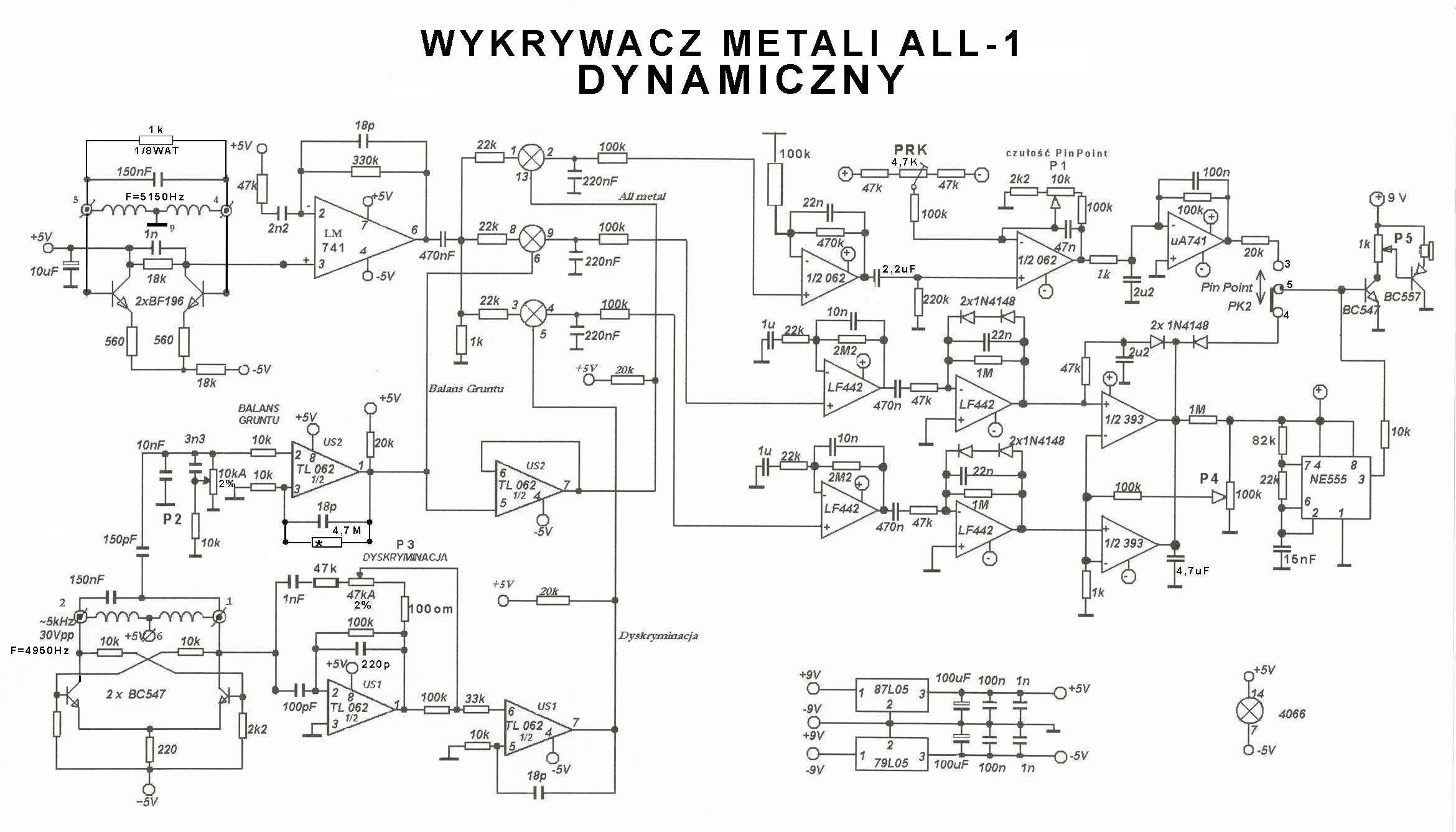

                Carl,
                this is popular in Poland ALL-1 schematic based on old Fisher design. model 553 or 555 - I do not know what they took. no 4046.
                  some Progress
                  Found where to connect the coils, battery, disc knob....
                  todhay will start the restauration and post results.
                  Thank you again for digging into this
