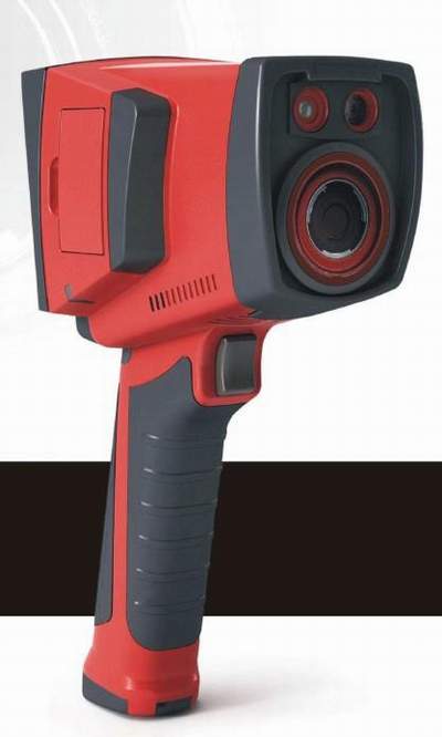

    The other day i had chance to meet and test one thermovision camera made in China.
    Model was EasIr-4.
    Spent 1 hour playing with it.
    One huge remark i can put; is on it's tft display.
    I couldn't see clear picture at all on daylight. Not because of camera itself but mostly because that tft display is having very bad contrast and it is almost impossible to follow it on daylight.
    Only in dark room picture is getting viewable.
    Seller explained me that main problem is exactly in that TFT display and if camera is hooked on regular TFT, via proper cable, than such problem does not exist any more.
    Other impressions; nice! Fast firmware, real time displaying. Sensitivity is pretty good.
    I walked through a space and observed various things.
    First i made small paper "ocular" to protect tft from direct light, to be able to see least something.
    Seems seller was right, because sensor and machine inside really work nice.
    I was able to see power installations through walls.
    Tried to observe outdoor facillities through window, yet without much of success, because sunlight was potent at that period of a day.
    Camera have memory card and with a single press on button everything can be saved.
    Another button allows you to see real "non thermo" picture in real time.

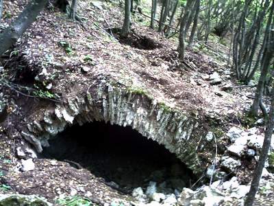

    Most of Roman tombs (for example) are not that deep, barely 1-2m underground.
    Those i have seen so far are made from ceramic bricks, large ones.
    Inside there is usual space approx. 2x2x1 (to1.5)m.
    So, pretty large "anomaly".
    Hopefully such anomaly will significantly disturb temperature on soil surface, enough to be "detected" and monitored using thermovision camera.
    That's theory, but i miss practice for now...

                      Things like this will not work well, real thermovision in something cryogenically cooled, (liquid nitrogen or something), capable for 1\1000 deg. C resolution picture or so, not for xxxx E and not portable, even then very of limited use in this situation, FLIR imaging capability is limited by temperature difference resolution and many other things. X-ray imaging works only thru object, not for surface scan. We still need metal detectors.
