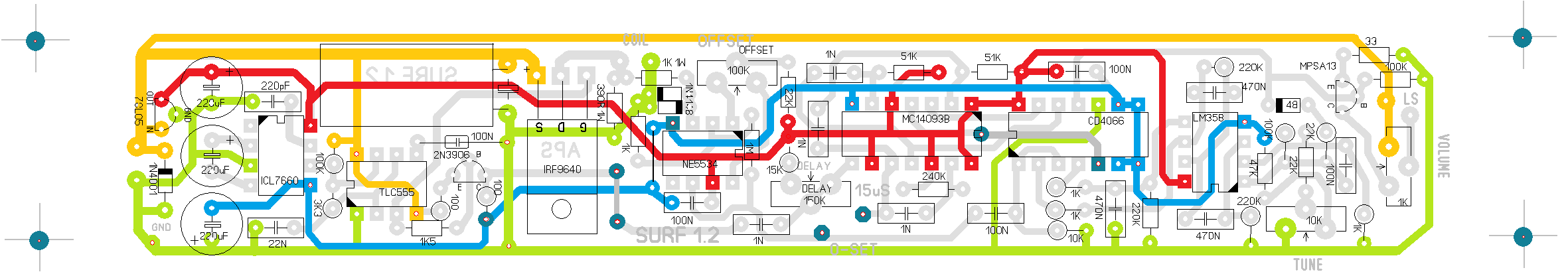

        look at the png, orange = +batt
        red= +5volt
        bleu= -5volt
        green= ground
        there can be some small differents with you board...and I just made it so not checked !!
          RED ISN'T REALLY MY COLOUR BUT.... ))

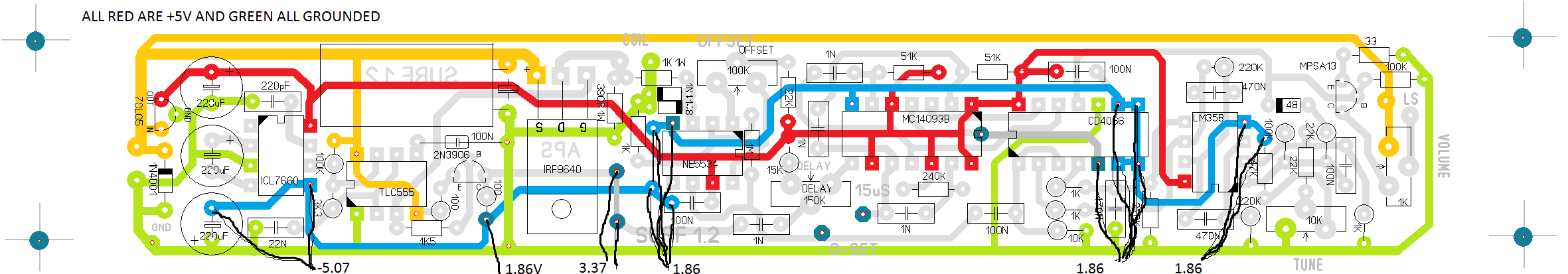

          now for the board you send me. orange is 12.48v all of them are ok
          for red all of them are +5v
          and for the blue where i think the problem is we only have two places that i have -5.07. the rest are 3.36v and 1.86
          http://i1161.photobucket.com/albums/...vlos_x/srf.png

                  between 7660 pin 5 and R5 is a direct track
                  how can one end be -5v and the other +1.86v ?
                    this is the reading i get, i've checked it so many times, am wondering the same thing. what do you think the problem is silverdog?

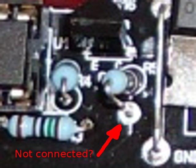

                      Maybe the lower end of R5 is not connected.
                        when i take out NE5534 the measure is 4.20v, when on is 1.86v. R5 is connected, i tried again gluing it but is the same result.
