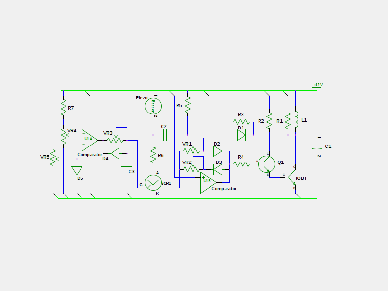

Do you think this will work? My PI Circuit.
  • Do you think this will work? My PI Circuit.
    I got an idea a few weeks ago and I wanted to make up a schematic,I got a program called gschem and it works pretty good.I made the schematic,I am still learning,I think this circuit will work.What do you think?If I have to use a voltage doubler to get above b+ for the reference voltage I'm ok with that,but I was going for minimum parts count.I figure the coil voltage at flyback Vin,will rise above the b+ supplied voltage divider Vref. Give me a lesson Carl.

      It would depend upon a comparator type. With 393 it can't work - there is no biasing at output.

          I think Davor is referring to the missing pullup resistor on the comparator output. Have a look at the datasheets for the LM393 and LM339. They both have open-collector outputs, and require a pullup resistor, usually 3k.

              Hystereses, and adding pull-ups where there are open collectors, are two totally different animals. Not even close.

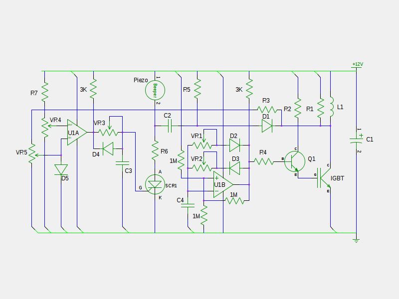

                  I see what I have done wrong here,the comparator is intended to sink current being an open collector.I intended for the comparator to source the current/voltage to drive the scr and npn. That is what the pullup is for right? so the 3k resistor sources most of the current to the load at output high.Correct me if I am wrong,I will mod the schematic right now.
                    Circuitry around U1B is wrong. There is no time base and inverting input is too high.

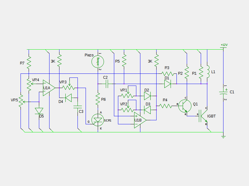

                      Sorry,hows this?
                        Now many of the parts look familiar, but does it really work? I'd have to translate it to LTspice first to analise what's going on.
                          This gschem program I am using has a simulator,but I just got it and I havent got that far yet. I plan to just put it on a breadboard and try it.
