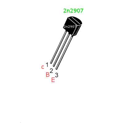

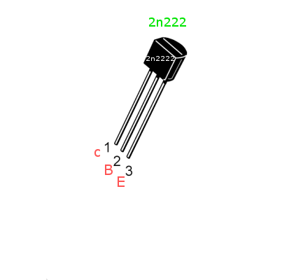

        ok,before i go to the uni and recheck the oscillator,i will make sure that pinouts of the trs are correct,this photo show what i had doing,is this pinouts correct?
        • #79
          If those are in plastic case than answer is: most probably NO.
          It is EBC than.
          Besides; why are we trying to solve this like that? You can use hfe measurement at your uni and distinguish proper pin assingments.
          Only when properly inserted - transistor will show some hfe.
          Give it a try.
          • #80
            Use a multimeter with an facility to measure transistor hfe. Athough testing in this way is no guarantee that the transistor is any good, it does enable you to easily find the correct pinout.
            • #81
              guess what i found,when i focused on the number of the trs,i found that it's not P2N2222 and P2N2907 it's PN2222 and PN2907 and its datasheet shown that its pinouts EBC not CBE,and you use P2N not PN,what is difference between them in the performance,can that effect on the circuit and -5v?
              • #82
                The P2 versions are in a metal can TO-18 package, whereas the PN versions are in a plastic TO-92 package. Otherwise they're exactly the same.
                  It is EBC than.
                  Give it a try.
                  Ivonics we have had this discussion before the plastic ones i have are CBE thats why if you look at my project photos somewhere on TGSL my transistors all look the same way round unlike some other plastic 2n2907/2n2222 on other engineers projects that are kissing each other, im not going down this road again like previously, just warning the lad not to take pinouts for granted.
                  • #84
                    My findings were that with the metal housings type trs made the detector chatty like when moving wires around, any movement gave the symptoms of dry joints, when replacing back to plastic to92 everything was back to perfect stability. This again I posted in the TGSL forum in the early days.
                    All this is going back to what i said earlier on this thread, read the ...... TGSL project pages and do your homework, its all there in black and white.

                    • #85
                      So who or where did you get the pinout connections from?, they may well be right, but theres just so much chance either one or both could be wrong so theres a 25% chance your right, so hope now you get my meaning, its thing learned from old, you cant take things for granted in the component world, even the manufactures sometimes get it wrong let alone the constructer.
                      My gut feeling tells me this could well now be at least one of your problems.
                      • #86
                        You are absolutely right!
                        There are indeed numeorus manufacturers which do obey different standards.
                        Situation is even more complicated nowdays when we have many unknown manufacturers from China!
                        I met mostly EBC pin order at plastic ones, but that doesn't mean that all of those must be the same.
                        Most probably there are different ones. And i guess that also depends of local supplier and it's sources.
