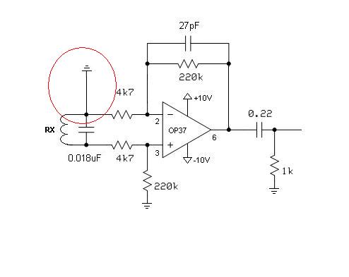

    Well, I think that ACE250 schematic floating around here has quite a few errors.
    The only problem with this design is that it is not truly differential. The non-inverting input impedance seen from the tank is 224.7k, while impedance seen from the inverting input is roughly 4k7/2 (due to feedback). Such opamp is amplifying a voltage across the tank, but also E-field phenomena, such as touching it, electrostatic discharges etc.
    It is quite easy to make it better. Resistors in the non-inverting branch must be replaced by much lower values to make the opamp work as a true differential amplifier. I'd replace 220k with 2k2, and 4k7 with 47ohm. Tank loading should not be a problem because total impedance seen from it should be over 4k, which could only be beneficial regarding noise.
    Whit true differential opamp you should not have problems typical for unshielded coils.
      Not to mention the fact there is a 27p cap across one of the 220K resistors, and not the other....
      I would recommend running your tx oscillator at 6.5KHz, and tune the rx coil to 8.5 - 9KHz.

        Also, thanks Davor on that input....this is what I understand to be a Differential Amplifier but from what I remember years ago....one has to work at getting close to a workable Diff amp. I'll play around with your ideas, but I almost copied the circuit from the design that Qiaozhi showed me....I think that design has been verified as very good....However, I recognize that I'm not using a JFET op amp. So I think I'm going to need to order the LF353. The input bias current of the LF353 is in pAmps...my OP37 is typ 8 nAmps. So the LF353 is more sensitive by a huge amount.

          I looked at a differential amplifier circuit on the web...It looks like my Rx circuit is fine as far as the resistor matchups.

            You better aim at some opamp that has good noise performance in input impedance range your application calls for. NE5534 or dual NE5532 and such. E.g. your coil is ~4mH, and at 17kHz its reactance is ~400 ohm. With 4k opamp input impedance you have some room for moderate Q resonance, however, it is much better to tune a tank a bit above the Tx because Rx coil's voltage response will be flat up to resonance, and phase response will be very timid.
              Regarding the true differential amplifier please check the attached PDF document and seek "The True Diff Amp". You'll also find here my LTspice simulation you may play with, and some ready values for some chosen gains.

                But, how are you planning to fit a LF353 dual opamp into a OP37 (single) slot? You would want a single LF351 or maybe a premium IC like LF357. (Or maybe just leave the opamp alone for now?) OP37 has LOW bias currents, maybe not as low as your JFET amp, but it's LOW. If your preamp quiescent voltage is around +/-50mV, DON'T WORRY ABOUT IT.
                Make sure to reduce your input resistances as suggested.

                      Ivo, this circuit has an input impedance of well over 200k, and it doesn't do anything to suppress a common component, e.g. E-field, static discharges, grass etc. Grounding the noninverting input you get the same, yet with 4k7 input impedance which is much better for noise. With 4k7 || 220k at noninverting input, you obtain a good offset balance as well. But the best of all is a true differential input that annihilates a common mode signal. Such true differential amplifier is achievable with opamp and shows a finite input impedance, while the instrumentation amplifiers do that exact thing with impedance >> ∞.
                      It is not too difficult to find some nice values for a true differential amplifier and benefit from simple and effective means of common mode rejection. I'm not too excited about shielding coils if I don't have to.

                          Shielding will not hurt your coil, but if everything else is done properly it is not doing much good. I intend to use a center tapped bifilar wound Rx coil and a true differential preamp stage. I expect it to be as effective as a good shielding, and I'll surely do some further experiments with it. Wire tap connected to signal ground or not etc.
