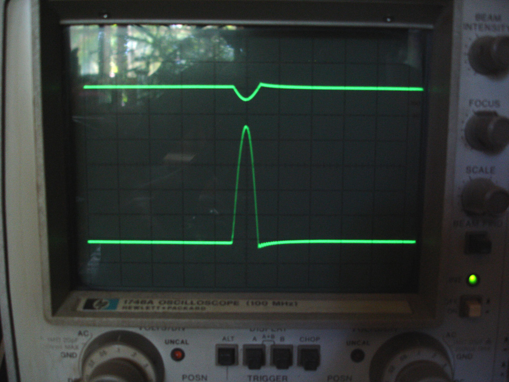

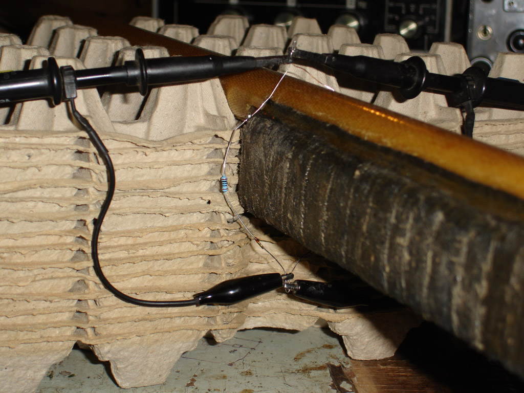

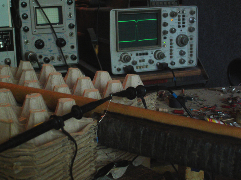

                      Guys , it's OK with professor , don't blame him What he told in his lecture is completely according with Faraday's law . You just forget here about one important thing - we have a deal with non-conservative force . So the voltage polarity depends on the direction of the movement along the loop . And another thing - all wires that aren't a part of the loop with changing magnetic flux inside does work only like a conductor , not an inductor . So we can connect two voltmeters to the same two points of the circuit , and they can show different polarities , and that is the thing that Faraday's law describes .
                      But it's all a "theory" , so let's go to a practice We can easily perform just the same experiment that professor Lewin did , and only what we need here are the good inductor coil with rapidly changing magnetic field , 2 resistors ( let's use the same values - 100 and 900 ohms , just for fun ) , and instead of 2 voltmeters we can use one dual-trace scope . But what about the inductor , where can we get it ? In order to provide a proper shape of magnetic flux we can use a ferrite stick with a coil wound on it , and quite a simple circuit with a pulse generator and high-voltage switch ( mosfet or bipolar ) , that pumps a current to the coil and abruptly shuts it down , providing a very high and short voltage pulse that can move the electrons in our circuit . In another words - we need a PI metal detector with the ferrite antenna . And I have PI detector exactly of this kind - http://www.geotech1.com/forums/showthread.php?t=19273 , why don't use it ? If it can do the job , I can save the time
                      Here on the photos we can see the pulses on the both sides of the circuit with two equal voltage probes . On the left side we have 100 ohm resistor , and on the right side 900 ohm resistor . And everyone can see that both probes really connected to the same points , and the signals does really have opposite polarity and pulse amplitudes does have ratio approximatelly 1:9 , according to the resistance ratio ..... so I think that professor is completely cleared now
                            I'm afraid you've lost me here. If you have two scope probes connected to the same point in the circuit, then you must display the same voltage. Unless one of the channels has its probe set to 10x and is inverted.
                            What is there in your setup that defines which probe is measuring which resistor? From what I can see from the photos, they truly are connected to the same point. So what gives?
                            Edit: What happens if you move both scope probes to the same side of the ferrite coil? I suspect you are picking up a signal from the coil directly into the probes.
                              Of course it would be so , if we have a "usual" circuit . But now we have a strong magnetic flux piercing our circuit just in the middle , and being the "motor" for the current without any battery . If the electrons being driven counterclockwise around our loop , for example , we'll see a negative charge on the upper lead of the left resistor and at the same time on the lower lead of the right resistor - it explains the opposite polarity on the probes ( or voltmeters ) .
                              They shows the same polarity and voltage , I checked it of course . And the scope itself cannot inverse the pulse because the "inverted" button on the scope panel ( near the channel B input ) wasn't pressed ...
