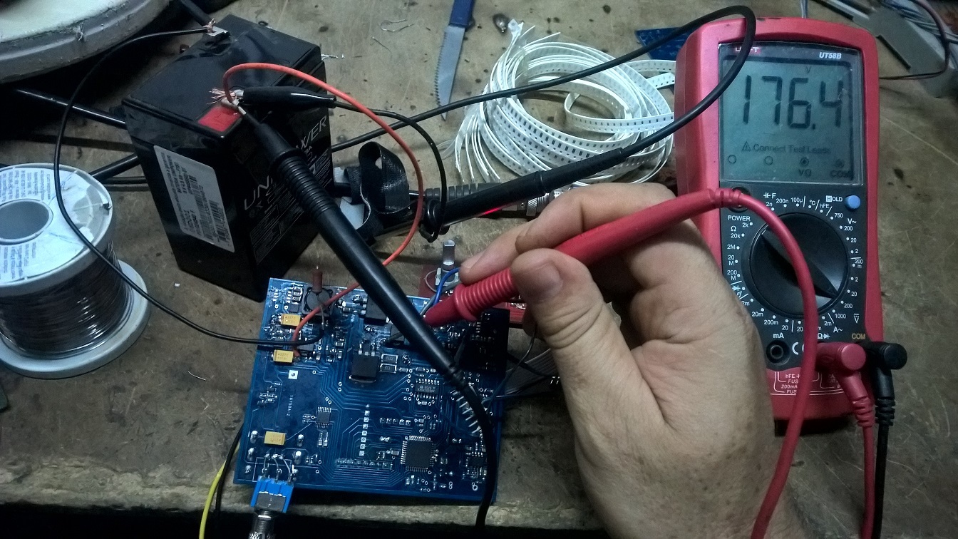

        • Did someone build this circuit?
          Hi Folks !
          If there is problem in posting this please delete.
          I finished 80% of the circuit but it is already starting to work.
          there is no reference to build this and it is very expensive the components to buy.
          the smps -v circuit still failed to make it work.

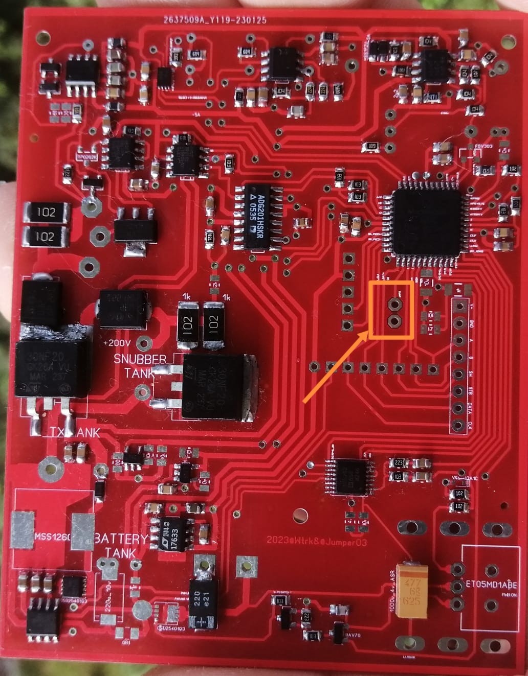

                      • A friend sent me 2 complete QED pcbs this summer.
                        One was "plugged in" and immediately had problems and burned out.
                        The second one is intact, all the components are on it, but nothing is broken or burned, because it was never connected to the power supply.
                        Since I got them; I didn't do anything about them. I talked to a couple of people on that topic, but I haven't moved on from the beginning.
                        As far as I can tell; there are many versions of the QED detector, each with some small (but vital) change from the previous one.
                        I remember that someone once said that the author of QED was a very quarrelsome man who, with every version of the code for the processor,
                        managed to have an irrevocable quarrel with the programmer, and because of this, he always continued to work with another programmer... who would write the code from scratch.
                        That is why we now have a general confusion about QED detectors.
                        Because we don't have a logical and regular code sequence for the processor that matches the hardware!
                        In the meantime, there has been some "final" version of QED which is commercial and it is impossible to get that version for free.
                        Of course, these are all just empty ramblings I've heard from "this" and "that". But I don't know what is true or not.
                        I have QED. New. Never powered on. It's 100% with inadequate code written into the processor, so I don't dare to try it.
                        Pretty schizophrenic talk around QED... I don't think even God knows the real truth!
                        Point: don't be sure that you will be happy if someone gives you a HEX code.
