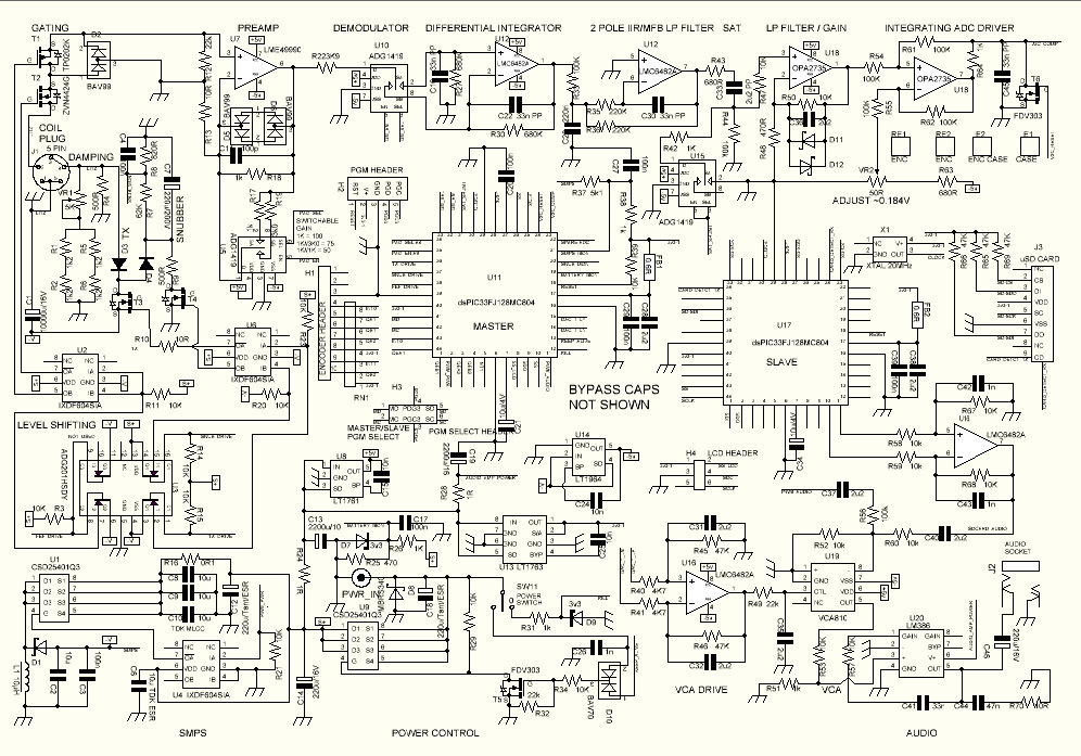

      • The QED schematic. If any circuit elements are copyright or patented, please let me know and I will change it.

              • hey bugs,
                Thats pretty neat, from what it looks like your slave dspic handles the "house keeping",
                the audio, SD card etc etc. i guess writing to the SD card with the main dspic would kill the timing,
                on my project, i'm going to try a 14 bit dac to a vco tied on the same spi bus i use for the
                16 bit adc and nest the routine in the TX pulse
                Philip

                  • Originally posted by bugwhiskers View Post
                    Making a successful PI detector is not rocket science.
                    Not really, but the PUDs are running about 0-for-5 right now. Not a stellar track record.

                      The slave is 100% micro SD card audio. It can be omitted completely and 2 * passive LCD screens hooked up to H4 LCD HEADER for the user visual interface. The only controls are 2 Optical encoders that allow a myriad of user adjustments. It's a detector tinkerers dream with so many opportunities to learn. All user adjustments including GB are stored to the micro's flash memory at switch off.
