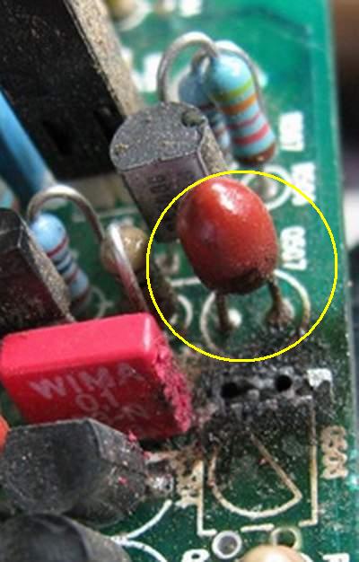

    I need help for my old fisher 1266XB (year 1994); after a coil replacement and 1hr of good work the component No.Q508 (4 pins) labelled as:
    IRFD
    S41 RF3
    9210
    broken, compromising also a red component labelled as:
    WIMA
    0,1
    63-N
    E3
    I do not find the broken component on the schematics and the electronic components retailer doesn't understand what it is; in the next post I will attach a photo;
    someone knows the specifications/characteristics of the two components or an indication for an equivalent one?
    may be there is a relation with the new coil however it is specified as “suitable for X series mod. 1225, 1270, 1236 e 1266”?
    thankyou for your time and cooperation
    Piero

    After your first post you can add attachments. The Wima component is a capacitor (100nF), but we will probably need to see a photo in order to identify the other one.

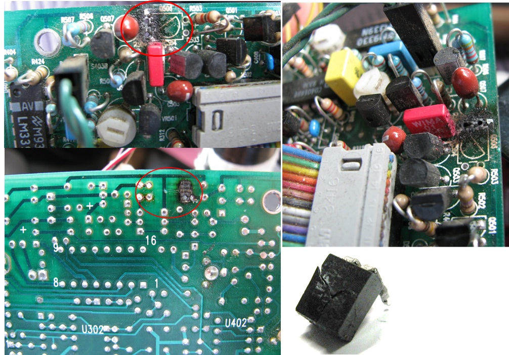

      thanks for the answer; I've attached a photo composition of the components;
      Piero
        It's IRFD9210, fet.
        Nothing special with that component. You can obtain it at local supplier, i suppose...

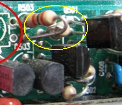

              Pay attetnion on those two resistors, maybe they are "touching" each other and form occasional "short" there?
              Estrange them to prevent touching.

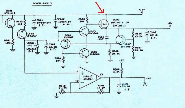

                thanks ivconic; I've just found a schematic on this site in a 2010 message:
                Fisher 1266-X Schematic 10-5-1993 (Rev. I) 300dpi scan
                but I'm not able to interpret it...
                I didn't touch anything on batteries or connections but I'll verify whether it happened accidentally along my internal cleaning after the coil replacement;
                good idea also the short between the resistors; I'm going to verify this evening

                  I have to disappoint you; it is schematic of old 1266 version, not the one you have there.
                  Seems you are having one of the latest 1266 revision...
                    Damn i am getting blind!
                    Yes that schematic will do just fine!
                    And i had it already but i never really analyzed it up to now!
                    Yes it is fet used in power supply stage.
                    In case you haven't previously changed nothing there; than must be about those touching resistors!
                    If you previously opened it and by accident moved one resistor towards another; than it is very possible that you made a occasional "short" between them....
                    Along with fet; do check and change those tantalums also!
                    Cheers!
                      you were right ivconic: I verified a short between resistors.....

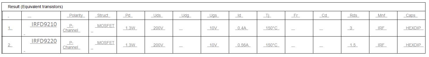

                      I called 9 big retailers close to Milan: nobody has a IRFD9210; on alltransistors.com seems that there is an equivalent in IRFD9220, this found in two specimens

                      can I try with the equivalent one or is an highly hazardous venture?

                          Yes you can, no problem.
                          Just to remind you: check and replace tantalum capacitor too.
                          Cheers!

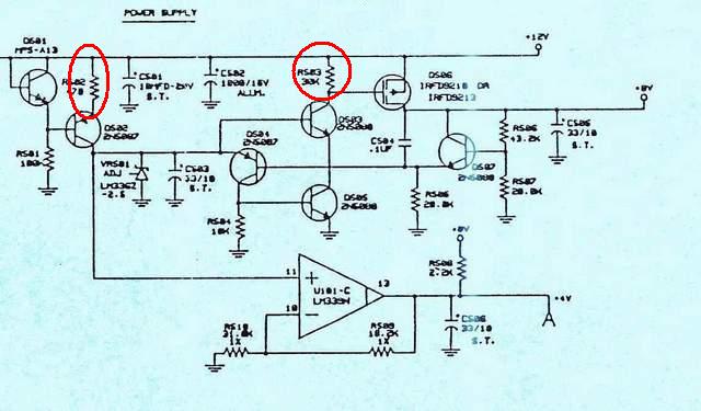

                            Before you switch it ON and check detector:
                            we must be sure about those resistors, as i see those are R502 and R503.
                            If those made "short" and caused fet to burn; THAN we must know for sure which sides of those resistors actually made "short"?
                            Because there is a chance that Q602 burned also (not likely; but worth to be checked).
                            That depends on which side of R502 resistor touched which side of R503.
                            So before you switch it on; make sure that Q602 is ok.
                            As i see it; most probably 30k (R503) resistor is shorted and that caused fet to burn.
                            Cheers!
                              just to inform you that, after a long test period, repairing works
