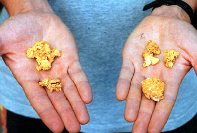

                      • Gold nuggets in Guyana
                        The jungle in Guyana is not very accessible, but this is where the gold is.
                        These nuggets could easily be detected with a metal detector.
