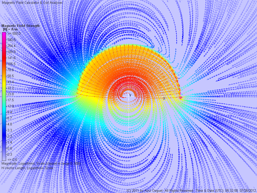

                        • Half Toroid
                          Hi Tinkerer,
                          see below (if I have understood it correctly). Not much promissing IMHO.
                          Cheers,
                          Aziz
                          • Thanks Aziz,
                            I am quite happy with what I see on your visualization and it is a good step towards what I am looking for. The vector arrows are excellent. This shows us the angle of incidence on a flat target like a coin that will give the strongest response.
                            The idea is not a deep penetrating field, rather it is to see if we can make a focused field while at the same time make it little susceptible to EMI.
                            With the half toroid, we see some asymmetry in the field.
                            With the full toroid, the whole field stays inside the toroid. When we make a small opening, the field still stays inside. Opening more, there is some point, where more and more of the field comes outside.
                            We do have some way to control the field.
                            Now, when we look at a horseshoe magnet, we see that they usually have a half circle that is extended with 2 longer legs. These longer legs have the purpose of directing the magnetic field to the extremes of the legs. The field then stays mostly inside the horseshoe, but is very strong between the ends of the 2 legs.
                            I hope that the toroid in the horseshoe shape will give some similar results.
                            Then there should also be a difference if the angles of termination on the legs of the horseshoe are different.
                            Another way of directing the field vectors, would be a solenoid in an hourglass shape. The hourglass shape is also used as a ventury in hydraulics. The resulting field should then be more pumpkin shaped, as opposed to the oval shaped field of a normal solenoid.
                            Now what happens if we apply the hourglass shape to a toroid? Or to a horseshoe? How will it influence the field shape between the ends of the legs?
                            We appreciate very much your help Aziz. Thanks a lot.
                            Tinkerer
