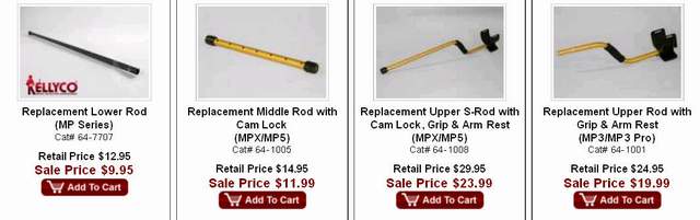

      Solid enclosures. Good first choice.
      How do the prices and quality compare with products from China?
      We must at all times keep the eye on the cost, because it is maybe THE most important factor.
      Tinkerer
      Example:
      Lower rod= $ 9.95
      Middle rod= $11.99
      Upper rod= $23.99
      $45.97
      I like those:

          So is $45.97 for complete "shaft"!
          And it is 3-part shaft, my favorite!
          It is cheap indeed.
          And it is even a sale price!
          Would be significantly less if 100 pcs are about to be bought.
          Some discount always can be negotitated with provider!
