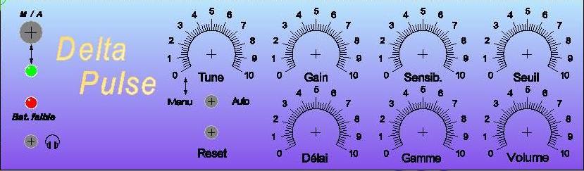

    If you Have Frontdesigner trial version, you do not have the function save, print ...
    It is nevertheless possible to print beautiful fronts.
    - You create your front panel and you click once on Printscreen (next to F12)
    - You open "Paint" or other design or drawing program and you click "paste"
    Than to put in size, print and cut or print and cut .
    The result:
