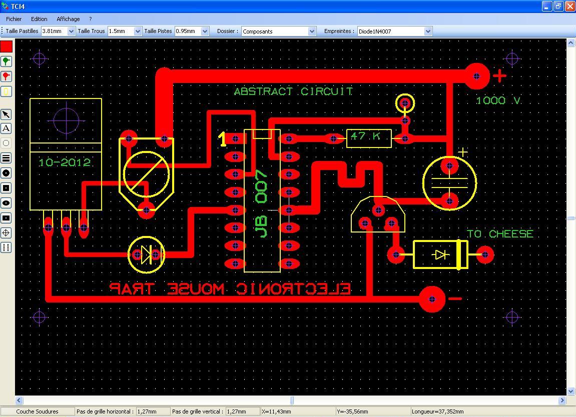

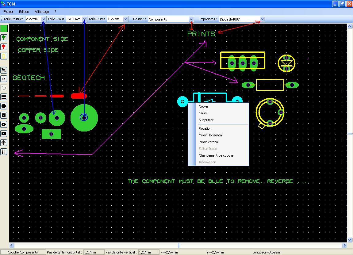

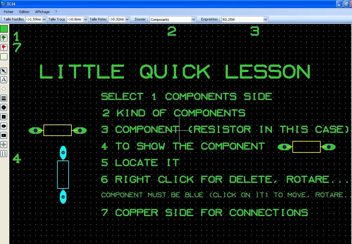

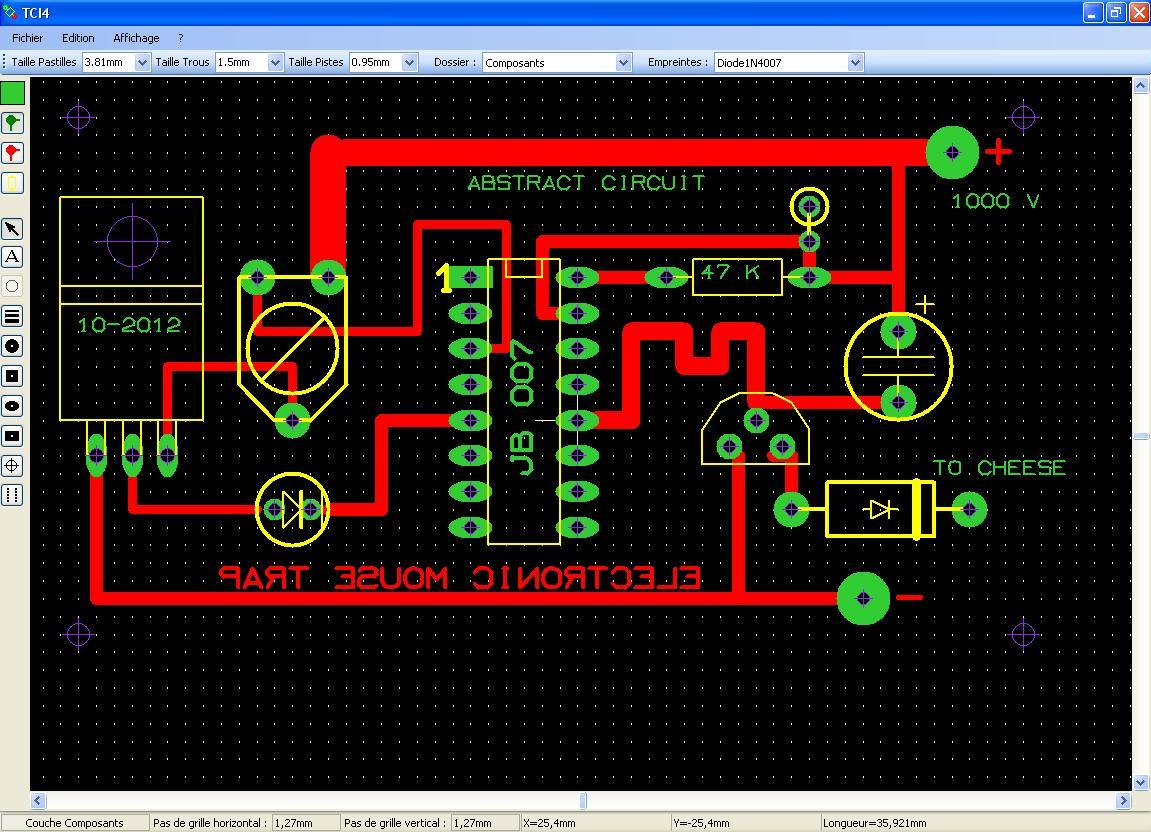

    Hi everyone
    I use this software to draw my Pcb. TCI is free and full, but only in french. http://b.urbani.free.fr/pagetci/tci.htm.
    Additional prints are available on the same page.
    The operation is so simple that everyone understands.
    We draw on the component side and (or) copper side. You can print the black pcb, component side and even drilling holes. Circuits can be exported Gerber or Excellon.
    Remaining at your disposal ...
    Greetings

      Yes, nice chance to learn some French, thanks Freddy.
      What about schematic drawing and converting it to PCB?
        Kein Problem Bernte. Sie müssen auch ein bisschen mit rechts click arbeiten aber Übung macht den Meister
        No problem Bernte. You have to work a bit with the right click, but practice makes perfect
        WM6 To convert Pcb, go to File> Print (fichier > impression)
        Select "black for typons" (en noir pour typons)
        Then select one after the other:
        components side (côté composants)
        solder side (côté soudures)
        components printing (sérigraphie)
        drilling plan (plan de perçage)
        centering cross holes (croix de centrage des trous)
        and Print (imprimer)
