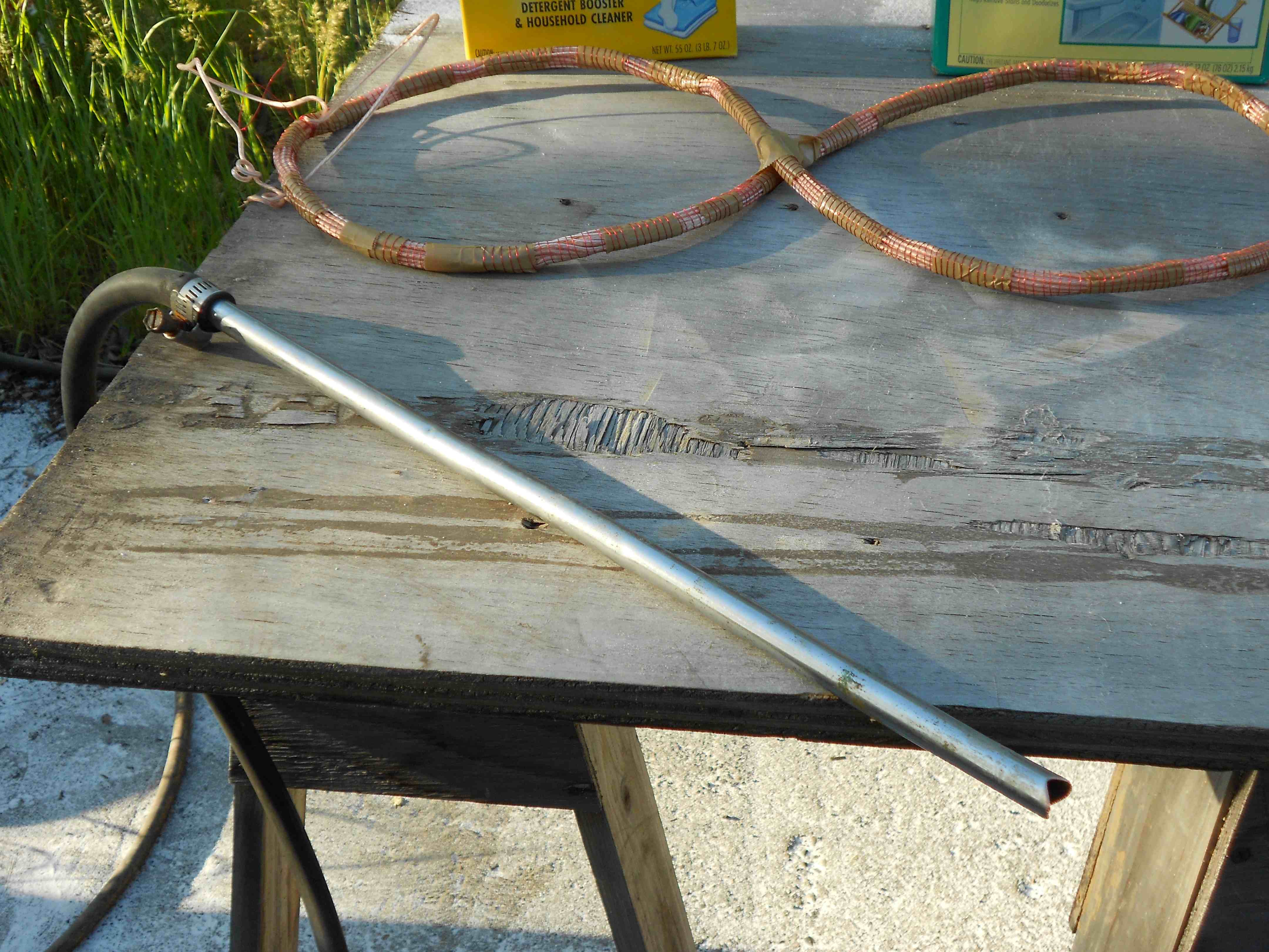

What I did was take my Dads OLD sand blasting unit, 40-50 yrs old???, and disconnect the hose from the 10gal Tank.
I then took a peice of 'Scrap' Chrome Plated Brass water pipe 0.5"(12.7mm) dia. x 18"(45.2mm) and ground a V into the pickup end.
this allowed me to place the end in ANY Box of Soda I wanted to.

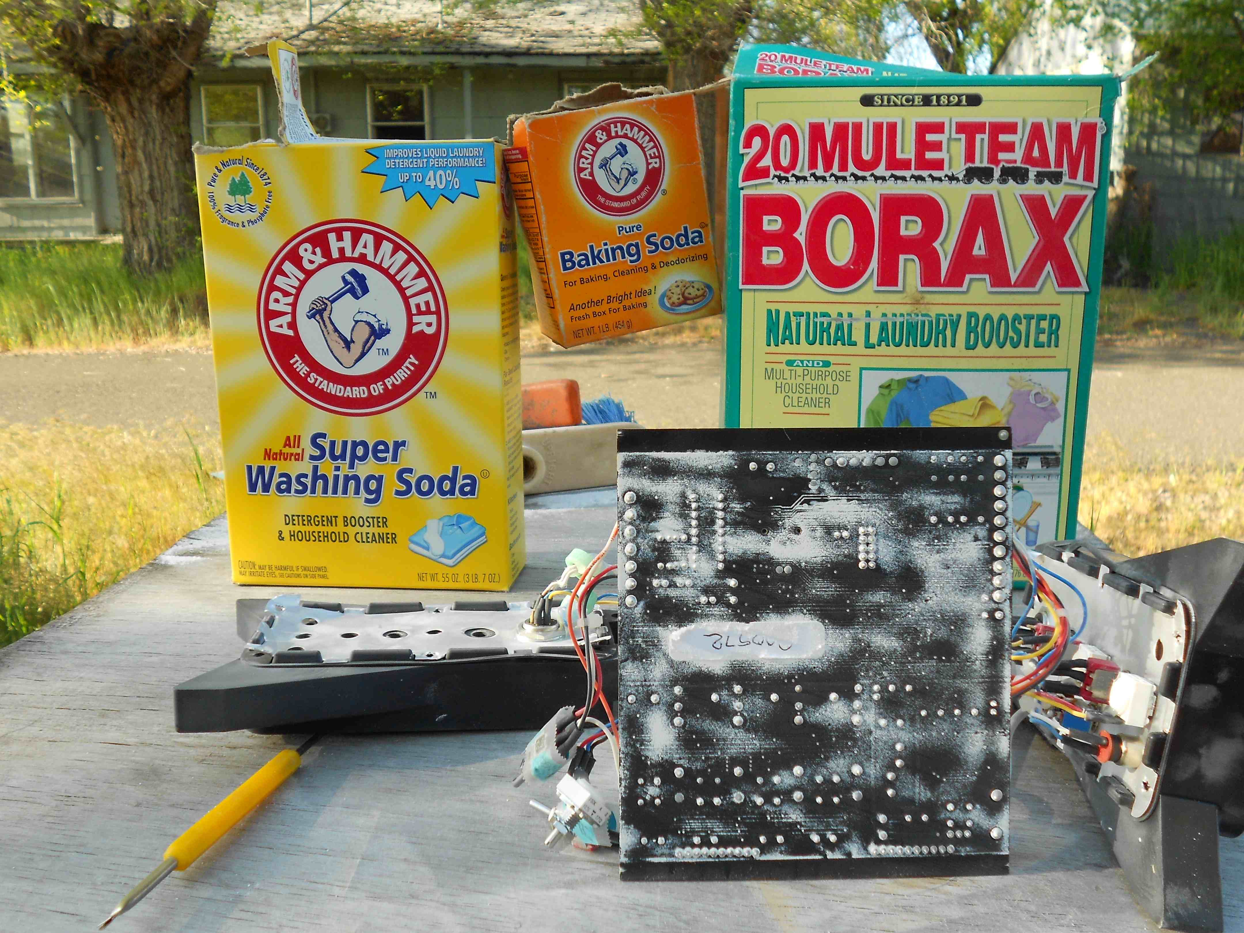

In the ABOVE Pic is a box of BORAX, DO NOT US this stuff as it Builds up on any surface it us shot onto. I don't know if this was due to the box setting in the Shop for the Winter an Absorbing Moisture from the Atmosphere or it is inhereant to the Borax. I have not tried to dry the Borax out in the Kitchen Oven. I assume that a good Temp would be 130-140deg F for an hour or so.
I found out from a lady I talked to in Cash 'n Carry Store that she used Baking Soda to make her homemade SOAP, and that was the techneque she used.

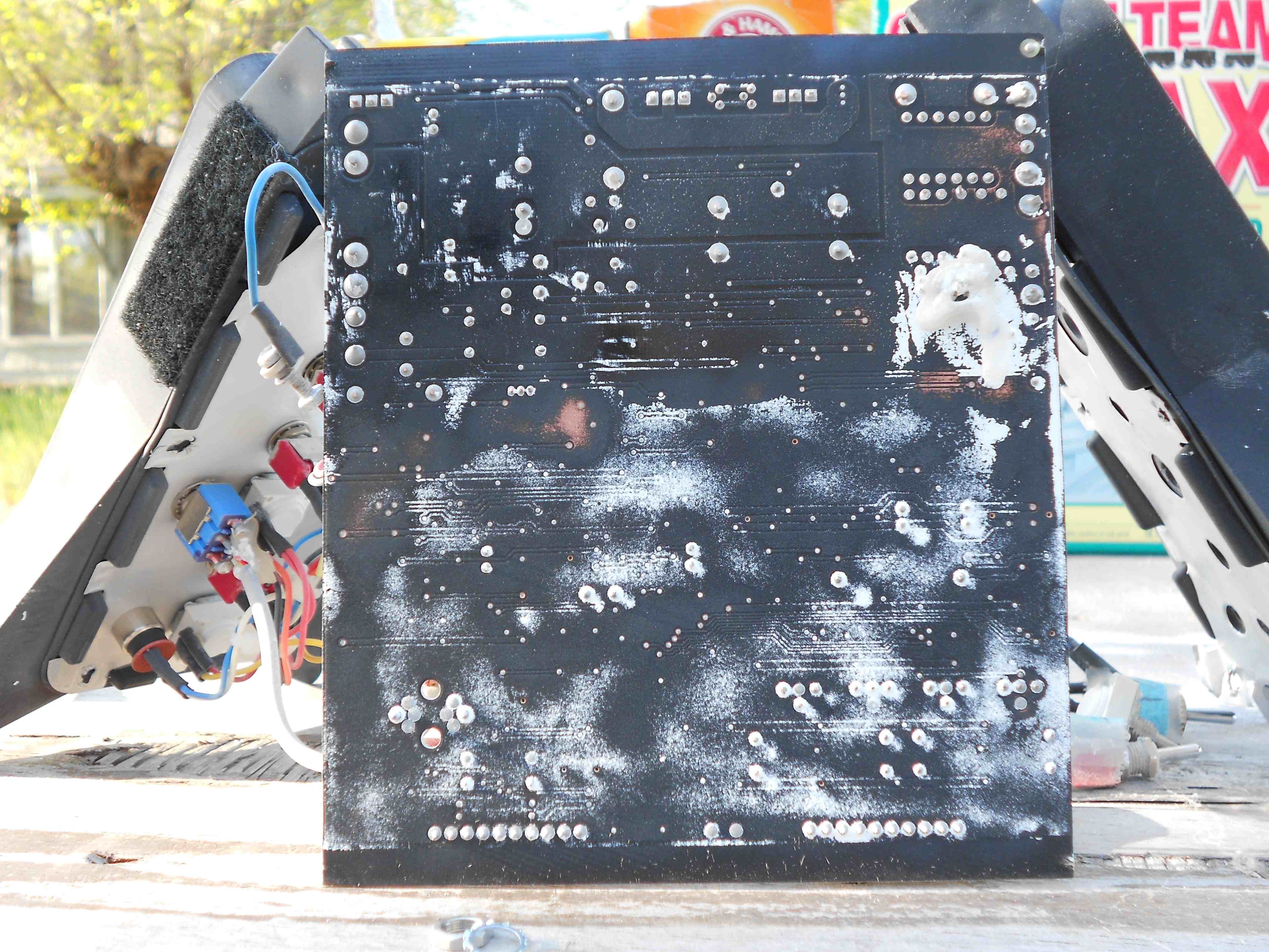

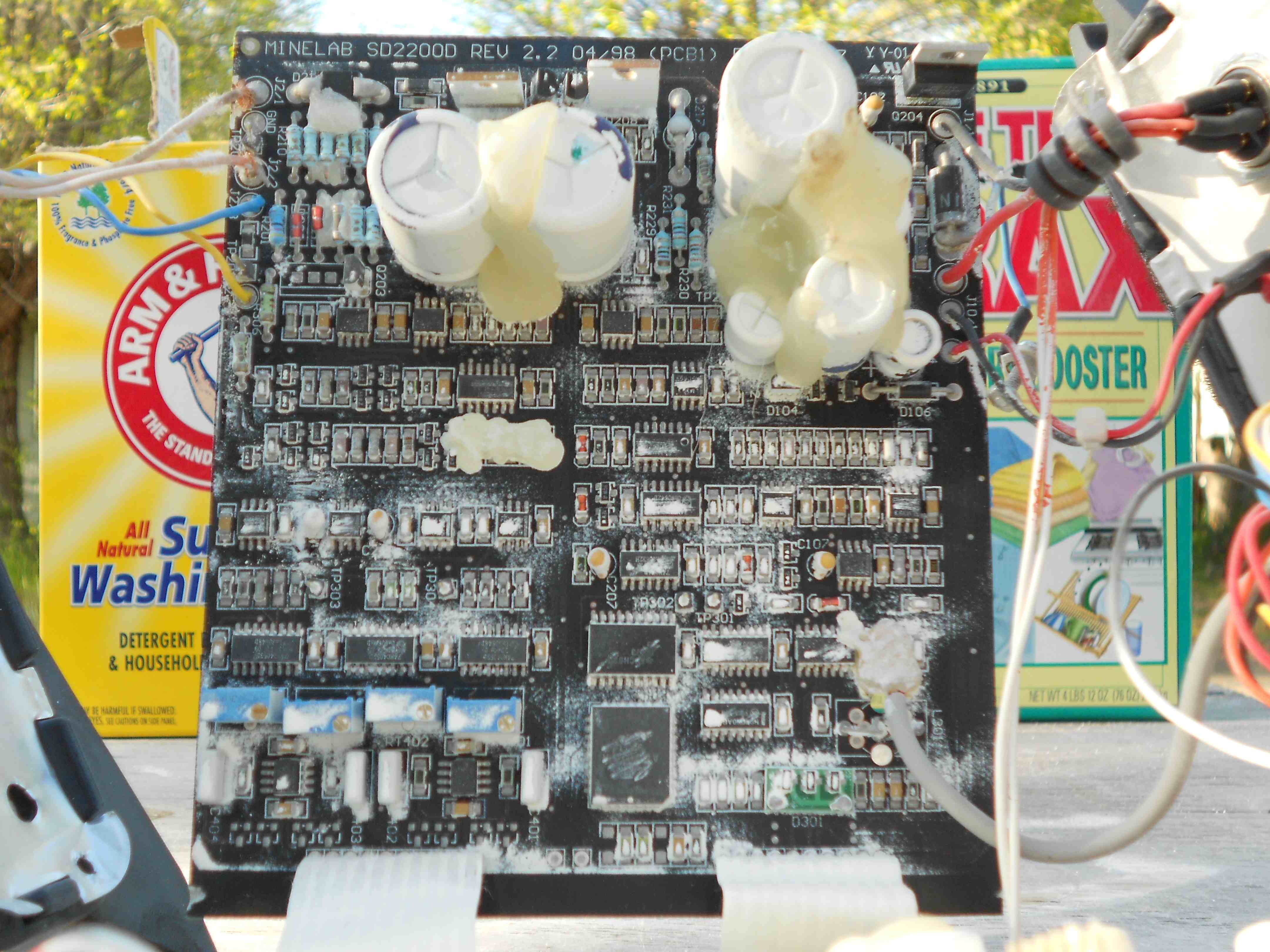

Here is what the cct brds look like when i got done.

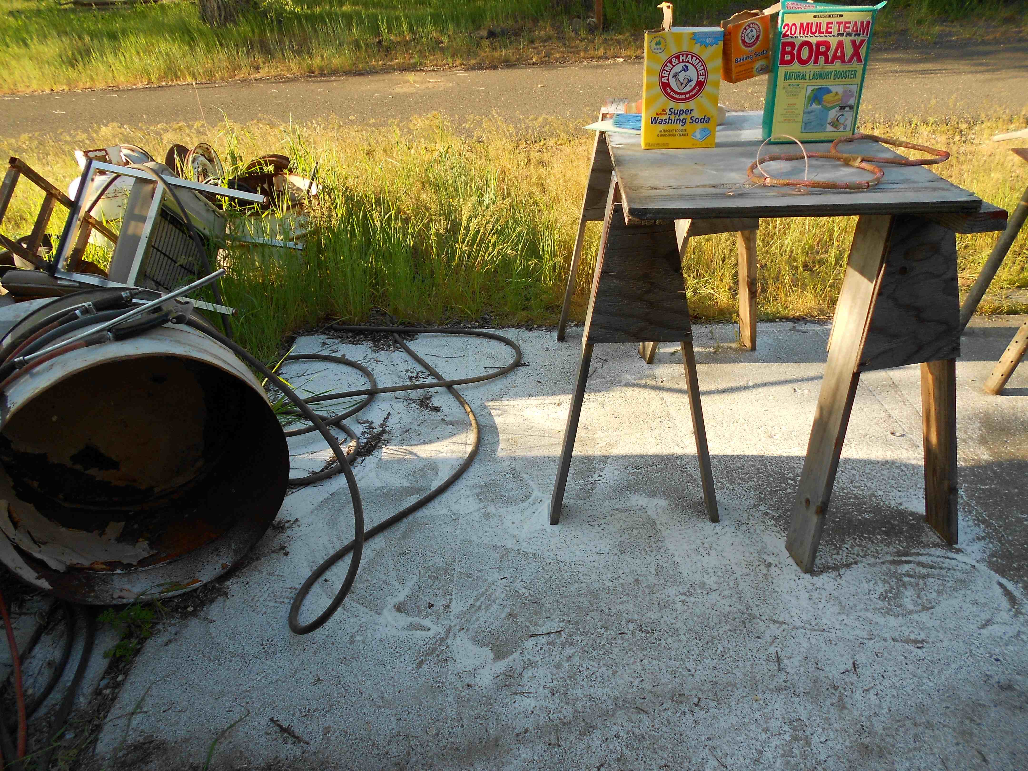

In this pic is of the mess after I got done.
