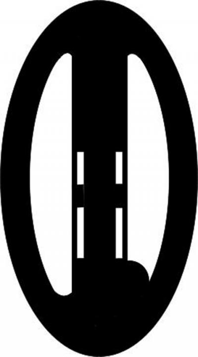

    I have been thinking about the coil housing for my Hammer head Pi and there are a lot of easy ways to do it and harder ways i suppose.
    I have been looking at shapes people use and found this template ,after printing it out and seeing if i got the size right my coil fits with in it .
    So i am going to cut this out and use it to cut out some plywood 2 copies and sandwich the coil between them, i will cut out the brackets for the slots as well then i will fiberglass around the thing .
    I was thinking perhaps just cutting out the shape from a card board box with the fiberglass it might be strong enough as well ? perhaps i will try both to see .
    some of the lads on here seem to frown on ply, but if coated in resin from my tests its fine.

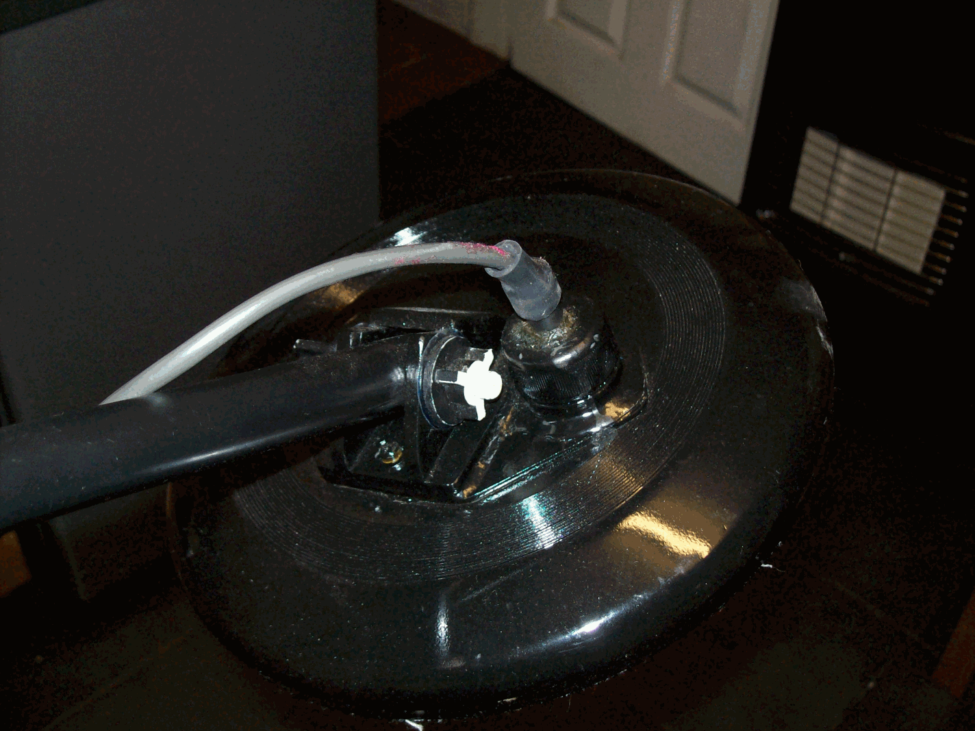

    i also used frizbees as well, i added a plastic clamp to mount to the handle on the top , fitted in my home made coil (potted with epoxy just enough), then epoxied in a flat disc of plastic in the bottom, when this was dry i drilled a small hole in the bottom disc and filled with expanding foam.
    once that dried i put a blob of epoxy to seal the hole, and spray pained it with black plasicote, super light and robust.

      Hi the thing with making stuff if you don't try you never know and i see you have given it a go ,i am only using very thin plywood and it will be incased in fiber glass just like a surfboard .
      I think you could use any thing that holds its shape for a fiber glass version ,perhaps even the card board from a old packing box might be thick enough...depends what you have handy most of the time when you make something .
      I was going with the Frizbee idea but could not get it out of my head theres a frizbee at the end of my metal detector if i do it ,the one i have is again spot on for my coil.
      I think like most of the people on the forum you end up making more than one coil ,this will be my first .
      My idea is i cut out the print out of the template i then glued it to my plywood then jigsawed it out (which i have ) need to cut another out for the bottom ,i will sandwich the coil between the plywood layers.
      To not make it look to thin i may use some Styrofoam to give it a better shape between the plywood ..then its just a matter of fiber glassing it and panting it black ...in my head it works so far so good ; )

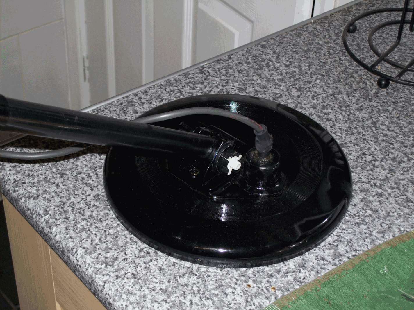

        the mounting bracket is made from pieces of perspex superglued together into the right shape glued onto a flat shaped piece of plastic, proper "plastic" super glue is a must.
        the outlet for the coil wire is the neck and top of a pop bottle (in the pic is the first i made), the next one i made is identical to that but has a proper strain relief fitted, using those just requires soldering the coil to the wire the only metal in the coil head is the two tiny blobs of solder connecting the wire to the coil, the shield connects to the negative side of the coil.
        i chose frizbees as they were the right shape, size and cost(way cheaper than proper coil shells), ive made two 8 inch coils for the baracuda this way.
        i'm still looking for something about 12 inches for a basket coil i have made but not found any thing as yet.

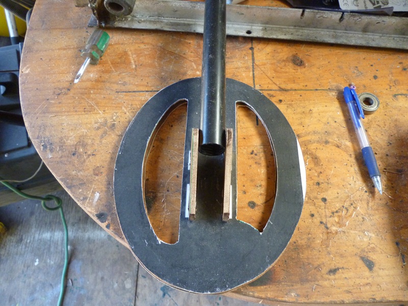

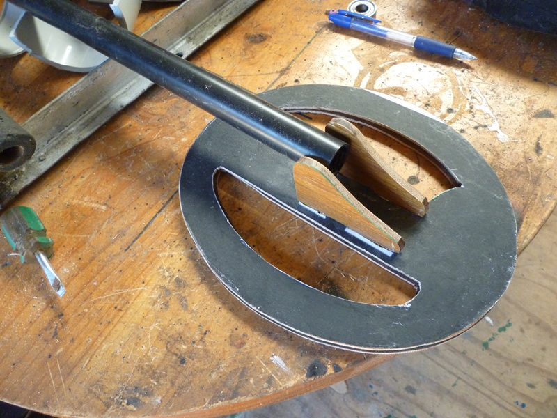

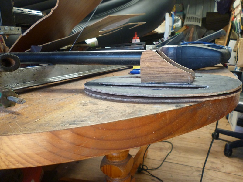

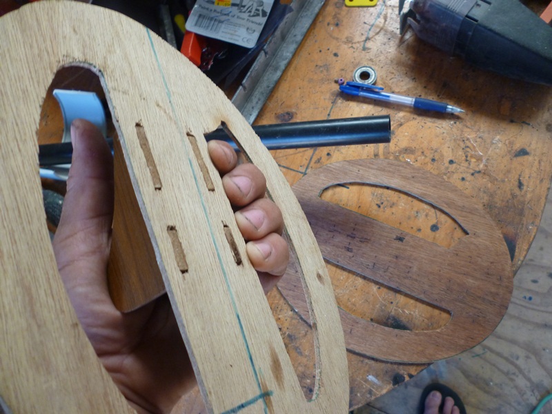

          I worked on mine again today Click image for larger version

          I think i can fiber glass soon
            once its got resin on you will probably find that its fine, as i said mine is a baracuda and although the 8" mono works fine as does the 12" basket thats actually the wrong way round, the original coils were 8" basket and 12 mono.
            i have not done yet though i plan on making a 8" basket but i am short of a good build plan, i bought a silverdog baracuda and returned it back to original specs, so i would like a proper 8" basket coil for it.

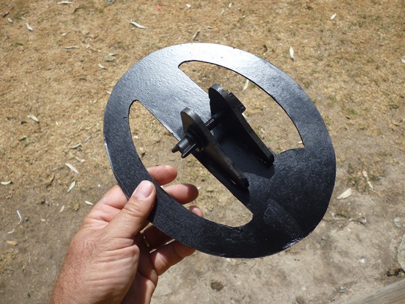

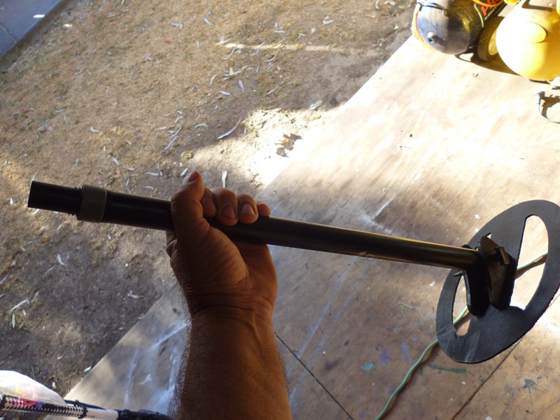

                  I didn't do to much today just drilled the bracket holes and glued those in and painted the bolt and nut washer and brackets black .Click image for larger version

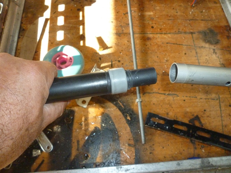

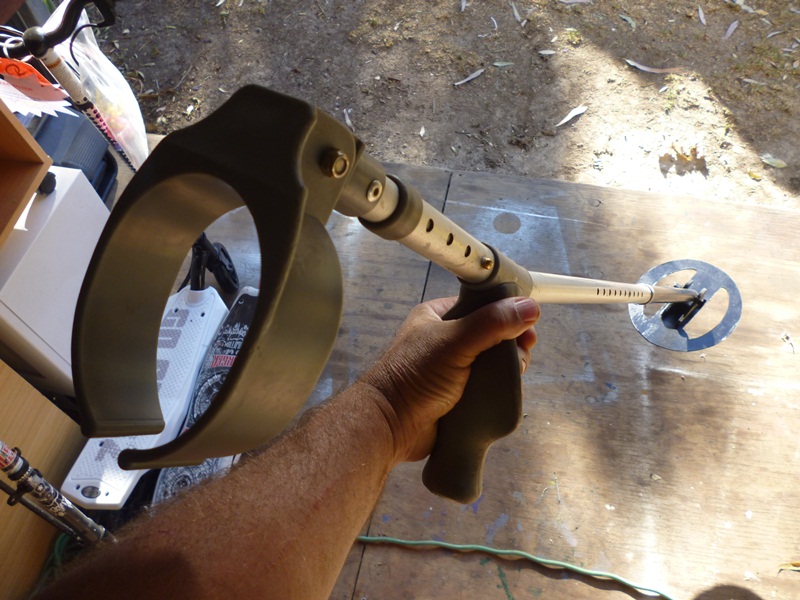

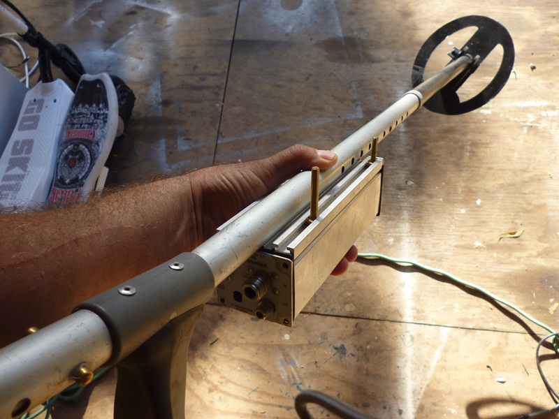

                              Heres a quick mock up of ideas Click image for larger version
ID:	339008Click image for larger version
ID:	339009Click image for larger version
ID:	339010Click image for larger version
                              i was just seeing what bolts will work to bracket the real PI case on.
                              It comes apart ...funny how half a rubber boat oar and a half a crutch fit together so well .
