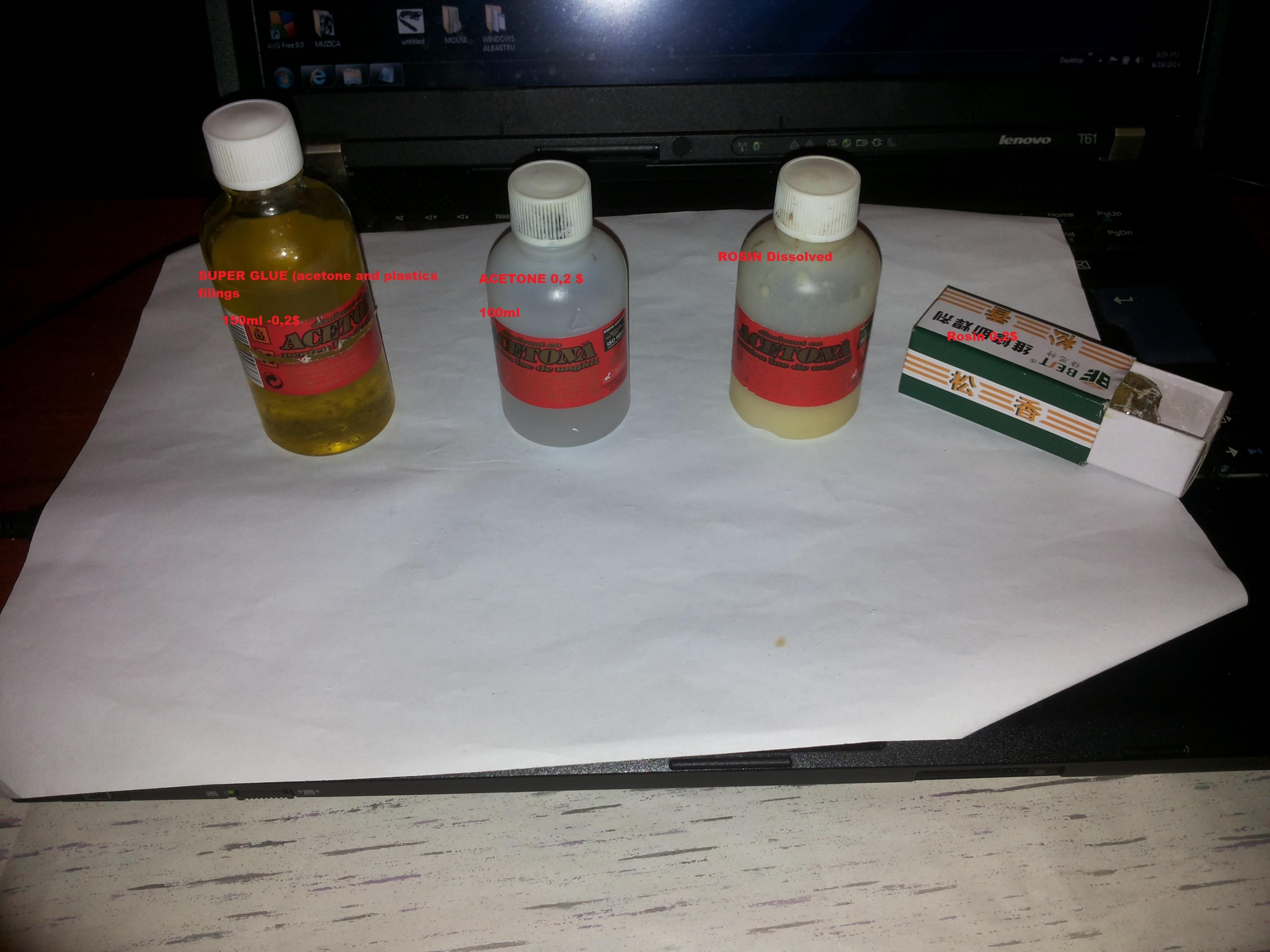

    How to make cheap glue equivalent (super glue ) Plastic filings25-35 grams and 100 grams thinner( acetone ), For Coil...All the best

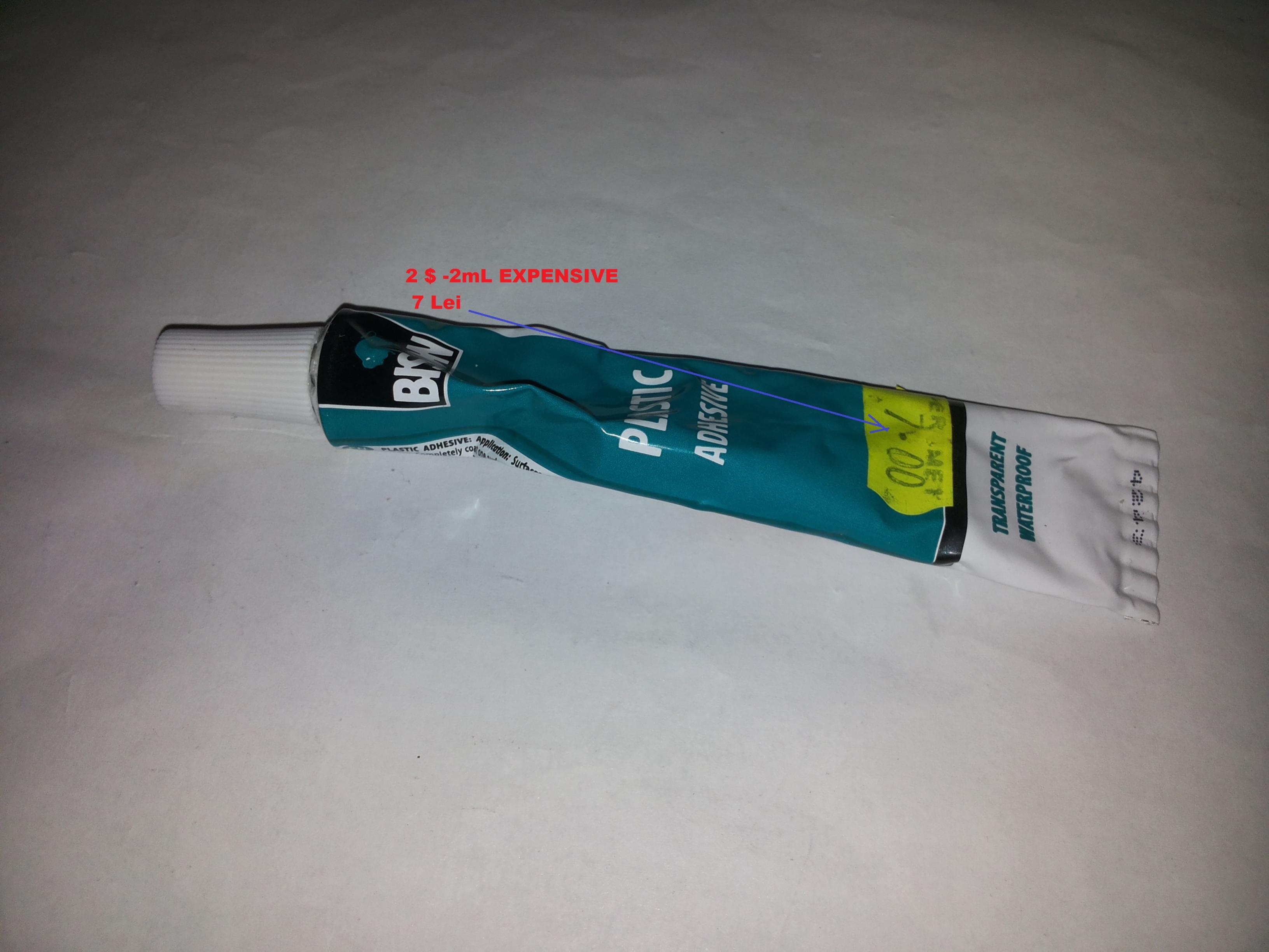

                  Sorry to intervene, this method is the dictator Ceausescu, I live in Romania and that time there was no super glue, so we did (acetone with plecsic) but try and you and you will see that it will not happen anything email (put more than plecsic diluted in acetone or acetone reacts not ...) and now everything is quite expensive to buy super glue the coils, the average salary here is $ 250 and a super glue is $ 2,acetone in Romania is cheap ... and electronics is a bit expensive in Romania .. Best regards
                    take a look..Click image for larger version
ID:	341053Click image for larger version
