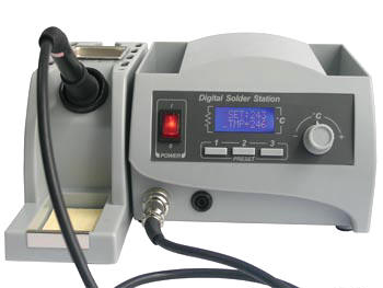

                I respect the fact that some of you have had good results with the economical non- temperature controlled irons, like the Radio Shack 15 watt Grounded model 64-2051 that was selling for around $8.00 and tax when I bought mine in 2006. This soldering iron has a 1/32" pencil tip and the price has gone up to $12.00 - $13.00 on the RS website.
                However, for those of you, like myself, who would prefer a temperature controlled soldering iron, I found an economical soldering station on Amazon, the Aoyue 937 + Digital Soldering Station, that has temperature control accuracy of +/- 1 deg. Celsius (+/- 33.8 deg. Fahrenheit), with a spare element and Free Shipping for $63.99. If you need finer accuracy, the cost goes up of course.
                Have any of you owned and used the Aoyue 937 + and what is your opinion of this unit ?
