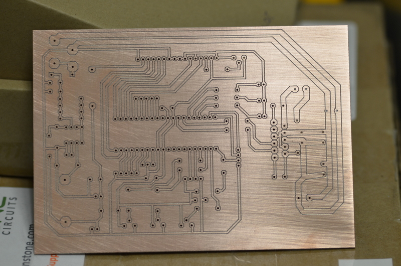

    I have just acquired (secondhand eBay purchase) a CNC3020T CNC router engraving machine. After struggling with the Chinglish User Manual (followed by lots of Googling) I've eventually figured out the tuning parameters for the stepper motors, and the Mach3 software is now successfully controlling the machine. However, I still have a number of questions that I hope some of you can answer:
    The best software I've found for converting Gerber files to G-code is FlatCAM (version 7), but the same questions will apply to any program used to create the isolation paths. I found that LazyCAM makes a lot of mistakes, and often gets the pad sizes wrong.
    1) What size (diameter) and shape engraving bit do you use to mill out the PCB?
    2) How deep should the cut be? (i.e. cut Z.)
    3) What feed rate is best?
    Also, as a side issue - have any of you tried to engrave a key fob? The machine came with several plastic, and a few metal, key fobs. But so far, every attempt has ended in a mess. Presumably there's some simple free software available to do this?

      It appears that he uses a 15 thou (mil) flat end-mill instead of the usual angled isolation bit. The main advantages are that it removes the criticality of Z-level touch-off, and doesn't affect the trace widths. This seems to be a reasonable idea, and I think I may have some end-mill bits in the box.
      Recommended track spacing for pcb milling are 16 thou spacing (using a 15 thou tool) with an 18 thou trace size. This is claimed to provide good results.

                      Using a 20 degree bit may make sense because you can cut deeper than nessesary without making a wide cut.
                      Cutting deeper will compensate for low spots on the pcb. For $10 each you can buy a set 20 and a 60 degree.
                      While learning you will break a few bits, so it won't hurt to have extras.
                      I found that PCB material is not uniform in thickness, plus warping and bowing. So depth of cut is the biggest challange.

                        My engraving bits are 30 degree V-shaped, and I've eventually calculated all the necessary parameters for the CNC3020T machine. The result looks quite acceptable, and I didn't have to oversize any of the tracks or pads. The layout used 15 mil tracks and 10 mil spacing.

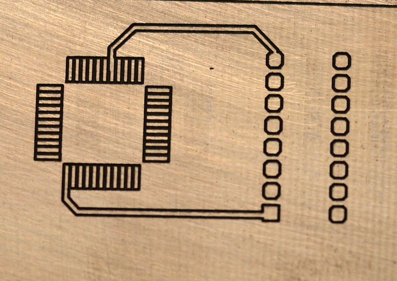

                          In theory the software should calculate the tool offset. So drawing oversized traces and pads would not be necessary. I may have my tool diameter set wrong in Kcam, which is causing the under cutting. I've got my setup and method working so well, that I have not tweaked it lately. So it's time to take another look.
                            Typical copper clad board (1oz) has a copper thickness of 1.37 mil (35um) and a board thickness of 60 mil (1.5mm).
                            I have 30 degree V-shaped bits available.
                            Clearly, given a particular V-shaped bit, and a fixed copper thickness, there is a limit on the minimum isolation path width than can be achieved.
                            Using some simple trigonometry:
                            where , z = depth of cut, and
                            Hence, for a 30 degree V-shaped bit,
                            The minimum recommended space between copper features (for 1oz copper) is 3.5 mil (89um). In this case
                            Therefore:
                            In other words, you need to make a Z-cut of 6.53 mil to achieve an isolation path width of 3.5 mil.
                            A more practical value for the path width is 10 mil (0.39mm), which requires a Z-cut of 18.66 mil (0.73mm).
                            For a 60 degree V-shaped bit, the depth for 10 mil isolation is 8.66 mil (0.34mm).
                            Likewise, for a 20 degree bit, the figure is 28.36 mil (1.16 mm), which is getting close to the overall thickness of the PCB.
                            Conclusion: A 30 degree bit is preferred for general PCB milling, and provides the best control of isolation path width. A 20 degree bit would be better for finer features (such as SMD) if the router is up to the task.
                            For the CNC3020T machine, I have the Mach 3 tuning parameters set to 400 steps per mm, velocity at 120 mm per minute, acceleration at 30 mm/sec/sec, step pulse = 0us, and dir pulse = 0us. In the General Logic Configuration menu, Motion Mode is set to Exact Stop.
                              Your math is impressive.
                              I changed my tool diameter to 6 mils. I had it set too small. See attached photo of 44 tqfp test.
