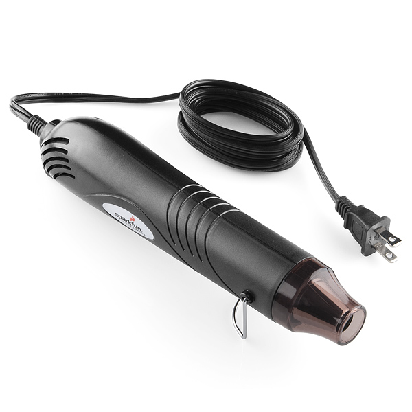

    What do you use to shrink heat shrink tubing?
    I have been using matches, small lighters for the most part for years.
    Tried a larger paint stripping heat gun, just throws too wide of a heat pattern good chance of melting anything near by.
    I found the perfect tool at a local thrift shop for $3.00.
    Originally bought it for my wifes hobbies.
    It's a Embossing Heat Tool for scrapbooking and rubber stamp embossing.

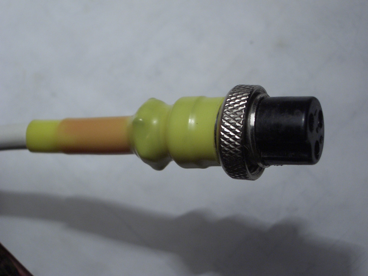

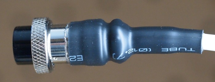

    Had an idea this morning. Decided to try it on some cable connectors.
    WOW, this tool works great, small nozzle heat pattern, you can hold the nozzle within 3/8" from the tubing and it will not melt.
    Perfect shrink. Even on 26 guage wire without melting the jacket.
    Specs for our tool is 350 watts, Temp 650 degrees F
    I looked on the web and the only company that sells these for shrink tubing is Sparkfun https://www.sparkfun.com/products/10326
    Their's is 300 watts.
    Any craft stores probably carry this tool in stock, as well as on ebay, Amazon, etc. Prices range from $16 to 27.00.
    So if your tired of using matches, lighters etc. give this a try. Think you'll like it.

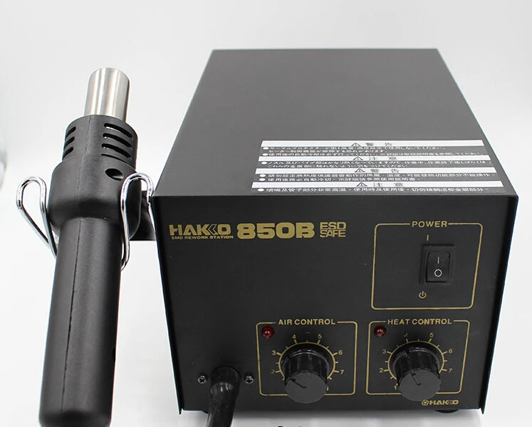

    I have used one of those guns before as my partner is into scrap booking also, they do work nicely. However, my favourite tool for this is my hot air re-work station as the temp is controllable. About 230c is good. For bigger jobs I have a temperature controlled hot air gun. But both of those are more expensive than the one you use. However, your missus would like a hot air rework station for the embossing she does as you can set the air speed low and the temp high and not blow the embossing powder away

                    That SparkFun tool looks nice, it's a shame it doesn't seem to be available in 220 / 240 Volt version.
                    There are alternatives: this Docrafts Papermania tool for heat-embossing, though:
                    And one sold as Dovecraft
                    You are correct about commercial guns being too powerful. There is definitely a need for something more modest in a workshop.

                      Skippy, on my last official work i had an air gun soldering station HAKKO (real Japan) and had not problem with the shrinking. but i left it as left the work...

                          Yeah, i have access to an expensive hot air SMD rework tool at work, too, but it's no use when I'm at home. At home I have a hobbyist heat gun, it's intended for shrinking film covering ( Solarfilm etc) on remote-control model aeroplanes, but it's fine for general heatshrinking. I just liked the look of the smaller ones, and the price was reasonable.
