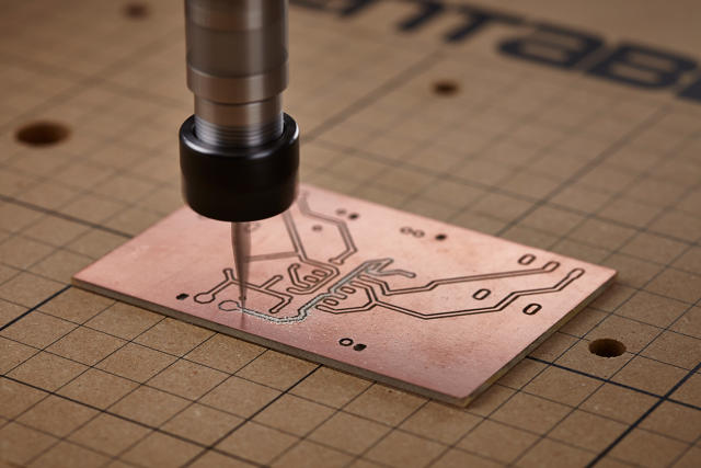

    I recently stumbled over this little machine here: https://www.inventables.com/technologies/carvey
    It seems interesting since it's really precise for milling PCBs and maybe one could directly mill coil housings out of plastic with it, although this would require multiple steps since the working area is limited to 20x30cm.
    What do you think? Personally I'd prefer such a machine over a 3D printer at the same price.
    The results on PCBs are not bad:
    That looks nice, from the site
    Can I mill circuit boards? Yes. You will need to source your own PCB milling bits and a software solution like EAGLE to make software files optimal for milling circuits.
      Looks very nice.

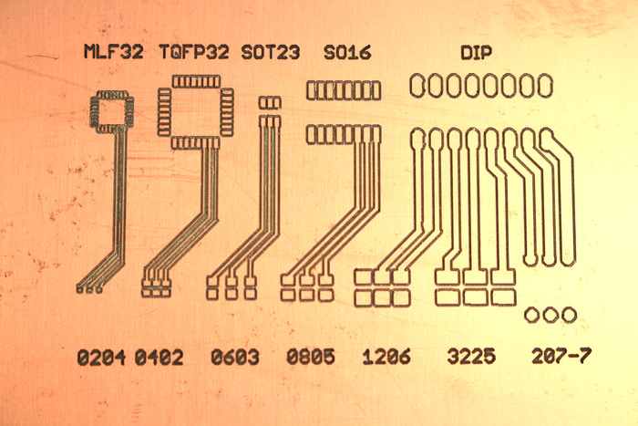

        The results from the Carvey machine don't look any better than I achieved with the cheap CNC3020T Chinese machine I bought off eBay.
        Calling all PCB CNC Milling Experts
        Save the Carvey 3D image, and then zoom into the detail.
        Note that the MLF32 (0204) looks like a disaster area, and some of the pads have been completely milled out, and the TQFP32 (0402) is close to its accuracy limit. Also, there must be a fair amount of backlash in the system, as there are still some anomalies visible in the DIP outline.
        It's quite expensive too, plus you will need to add on the cost of the software.
          [ATTACH]32282[/ATTACH]
          "MLF32 (0204) looks like a disaster area" not even worth taking a photo of
          looks like somethings wrong with the left right flex / backlash.
