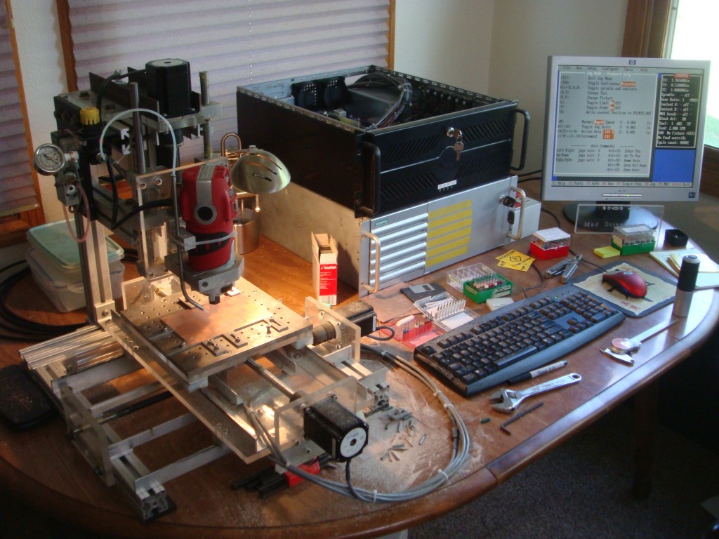

              This is like the CNC machine I have ->
              although I bought mine secondhand for about half the price.

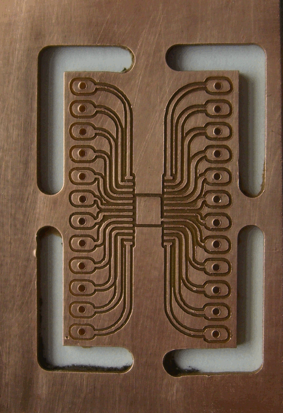

              Here's a small adapter I created using this machine:
Name:	TSSOP to DIP24 Adapter.gif

                        Im just wondering, why Mill the traces, why not mask them and etch them as it always been done ? BTW your set up looks Good! Well done.

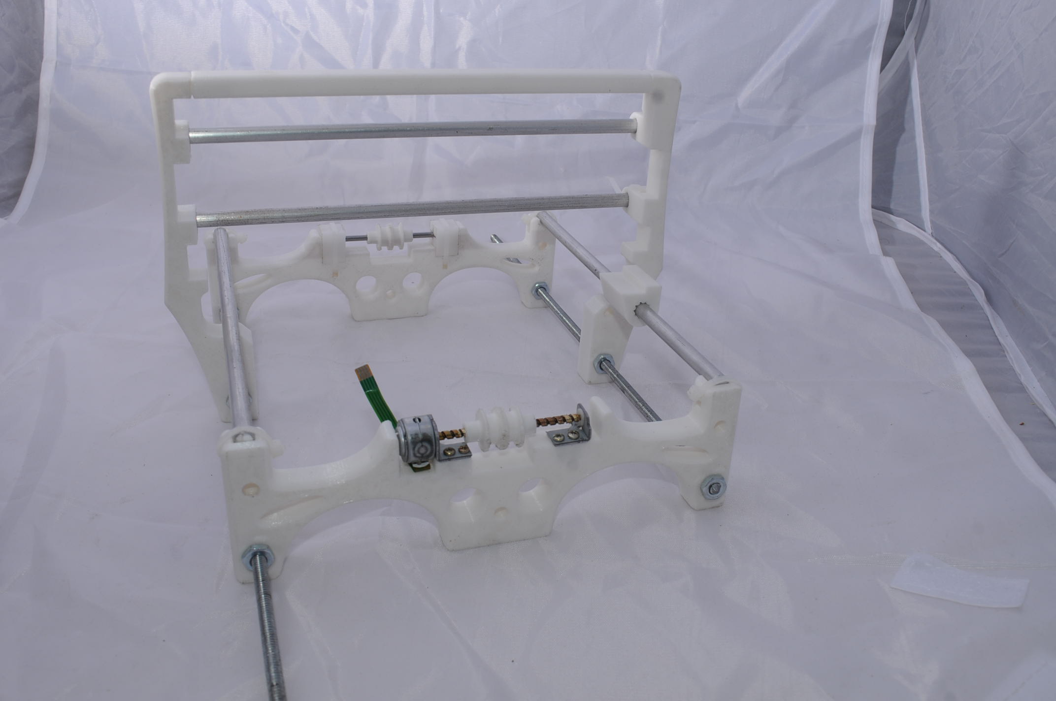

                        This is what i've been working on, should be up and running with in a few days . It will shapie mask and drill holes, pcb size that will fit is 170mmx170mm

                          On my heavily modded 6040 I use a spoil board and a fly cutter to initially level the bed. Also I use a spring loaded head which gives a constant cutting depth. Good results but I cant be arsed as I can have 10 prototypes made in China for $1 each for delivery in 12 days, why waste my time milling ONE in two or three hours? I've better things to do with my life.
                            That's not my rig.
                              It's perfectly adequate for drilling holes. Milling is the main issue, as it's difficult to get the bed flat for intricate tasks.
                              'Nuff said!
