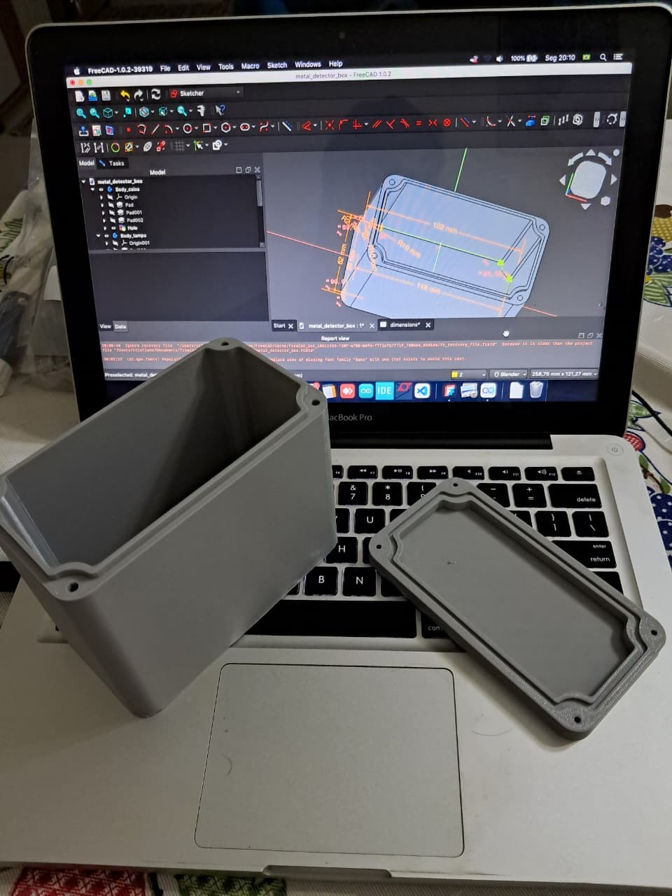

                        This is my first 3d print of a generic box for my homemade detectors.
                        Used a Elegoo Neptune 4, with PETG filament. The box 130mmx70mmx100mm toke around 3 hours to complete, the lid about 1hour.
                        Design was made using Freecad.

                          Will you share .stl file ?

                            Here are the files for the box and the lid: https://drive.google.com/drive/folde...cB?usp=sharing

                              Wow that's a fast print!

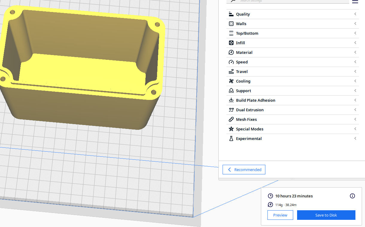

                              • #45
                                I just checked on the local classifieds; Elegoo Neptune 4 is nothing particularly expensive?
                                It is very slightly more expensive than the Ender 3. They are also structurally similar.
                                So what's the secret?
                                Is it the material? I've never used PETG and ABS, I've been exclusively using PLA for years.
                                Just checked in Cura with my standard profile, 11 hours at least!!!
