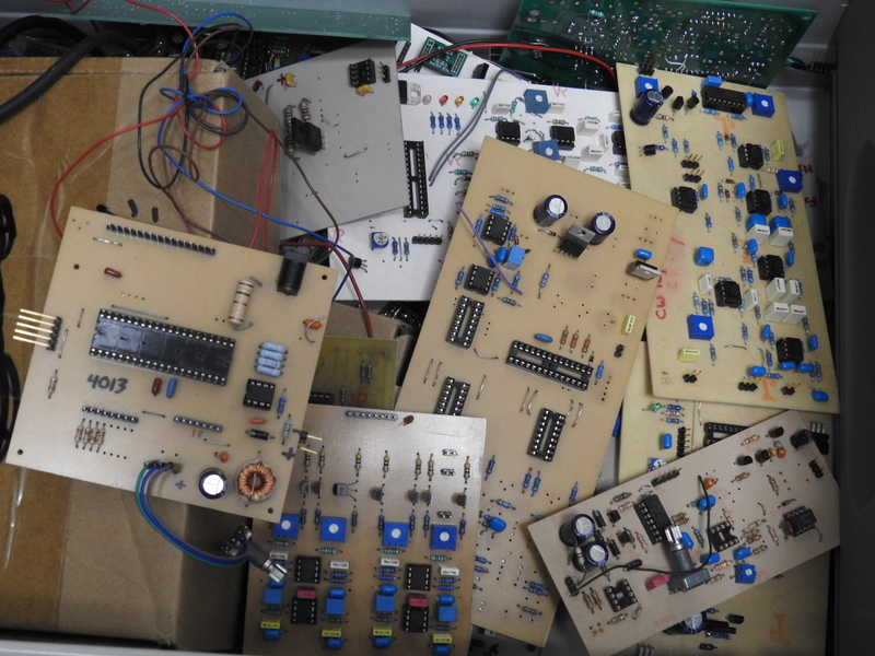

      I have been milling pcb's for a number of years with great success. It has limitations when it comes to surface mount and double sided. Surface mount needs solder mask and double sided need plated through holes. Solder mask and plated through holes can be done at home, but requires chemicals and time consuming processes. For single sided it can be very productive. I can mill and drill a large board in about 30 to 45 minutes.

      A drawer full of milled experiments

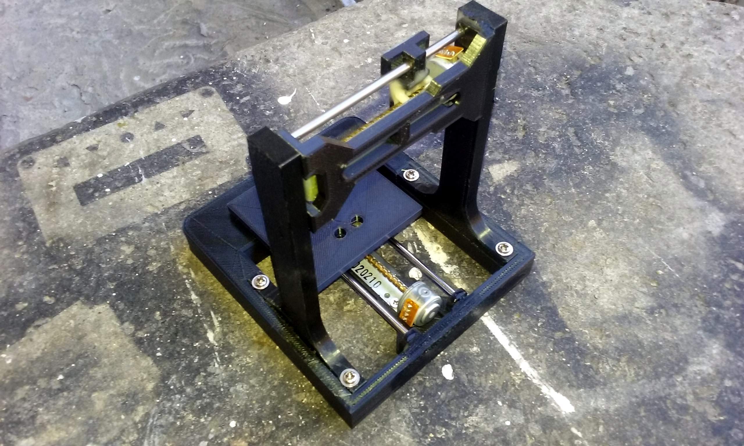

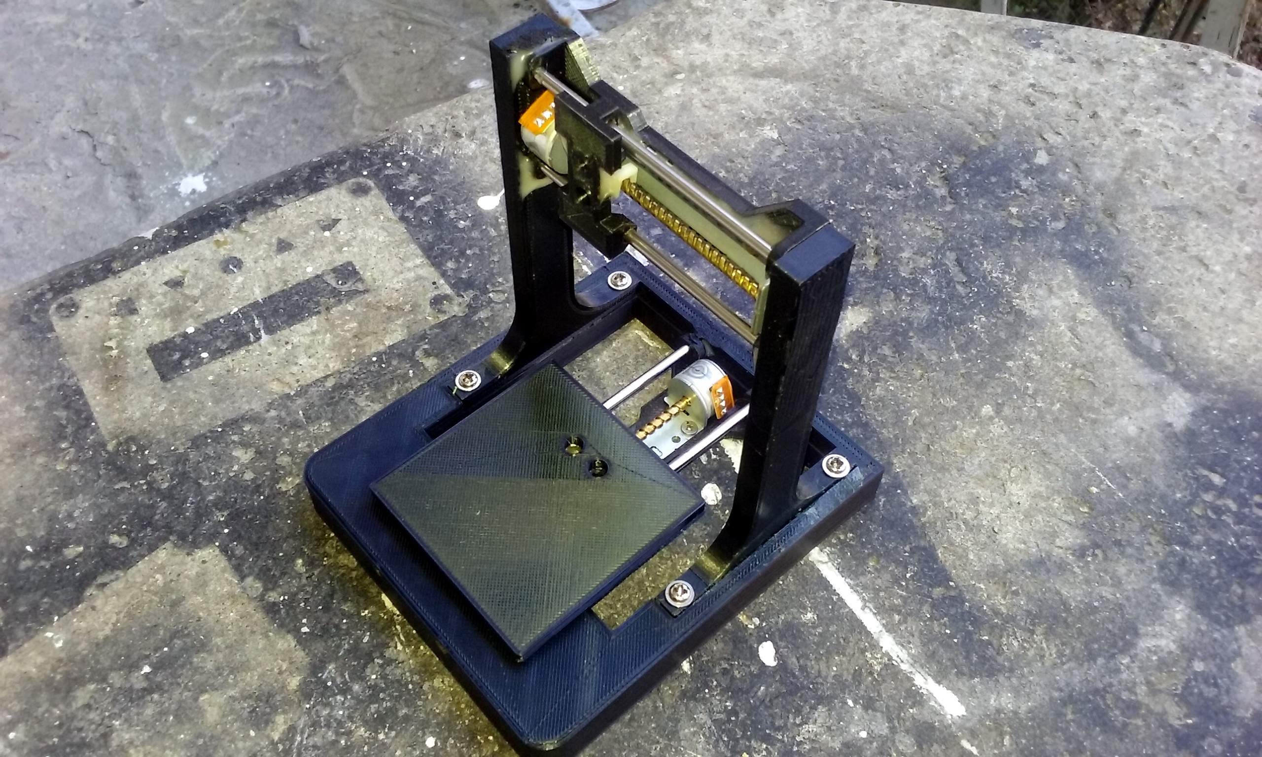

          Recently i made this for fun.
          Intend to mount laser on it.
