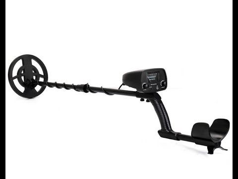

    this is my testing about china metal detector compare with diy project

    But you should know that it is not proper testing.
    Since there are few electronic devices on the same bench, close to detector and coil, probably producing lot of noise and affects detector behavior.
    Most proper air test would be if you step outdoor in your backyard, obtain plastic table or something similar, ~80cm above the ground.
    Than place detector the same as you did on your video, on that plastic table.
    And perform the same testings.
    Check out if there is any close electric, magnetic or electromagnetic source of noise in vicinity.
    Try to place the testing bed as far as possible from power lines and electronic appliances, gadgets, devices etc.
    Detector you are showing up on video; resembles me on one similar which i had in the past; Black Knight.
    Actually i had several of those in the past. Very interesting detectors. Not very deep, but rock stable.
    And also with pretty stiff discrimination.
