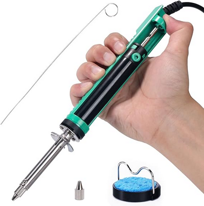

    Anyone with experience with this tool?

    I don't have it, but I've seen it with my colleagues. Correct thing.
    My best experiences are with copper braid when desoldering and cleaning the pcb of excess tin.
    There is no competition, especially if you work with SMD pcb and very small areas.

                My workmate bought a vacuum desolderer. I was lucky enough to use it. It claimed to be 24v and 90w, but was too slow to heat up to be 24v. My FNIRSI usb-C PD iron is 20v 100w and it takes 5 - 10 seconds to reach 350 - 380.
                The vacuum desolderer has a loud pump built into the main unit, attached through a hose to the iron. It made very short work of a through hole LCD display of at least 16 pins. About a second per pin at 320 degrees C. Braid and solder suckers are not suitable for me, for that kind of task. The vacuum solderer is the only thing that’s worked
                the plunger style soldering iron would not be as effective as a constant vacuum source. Pump based irons are incredible
