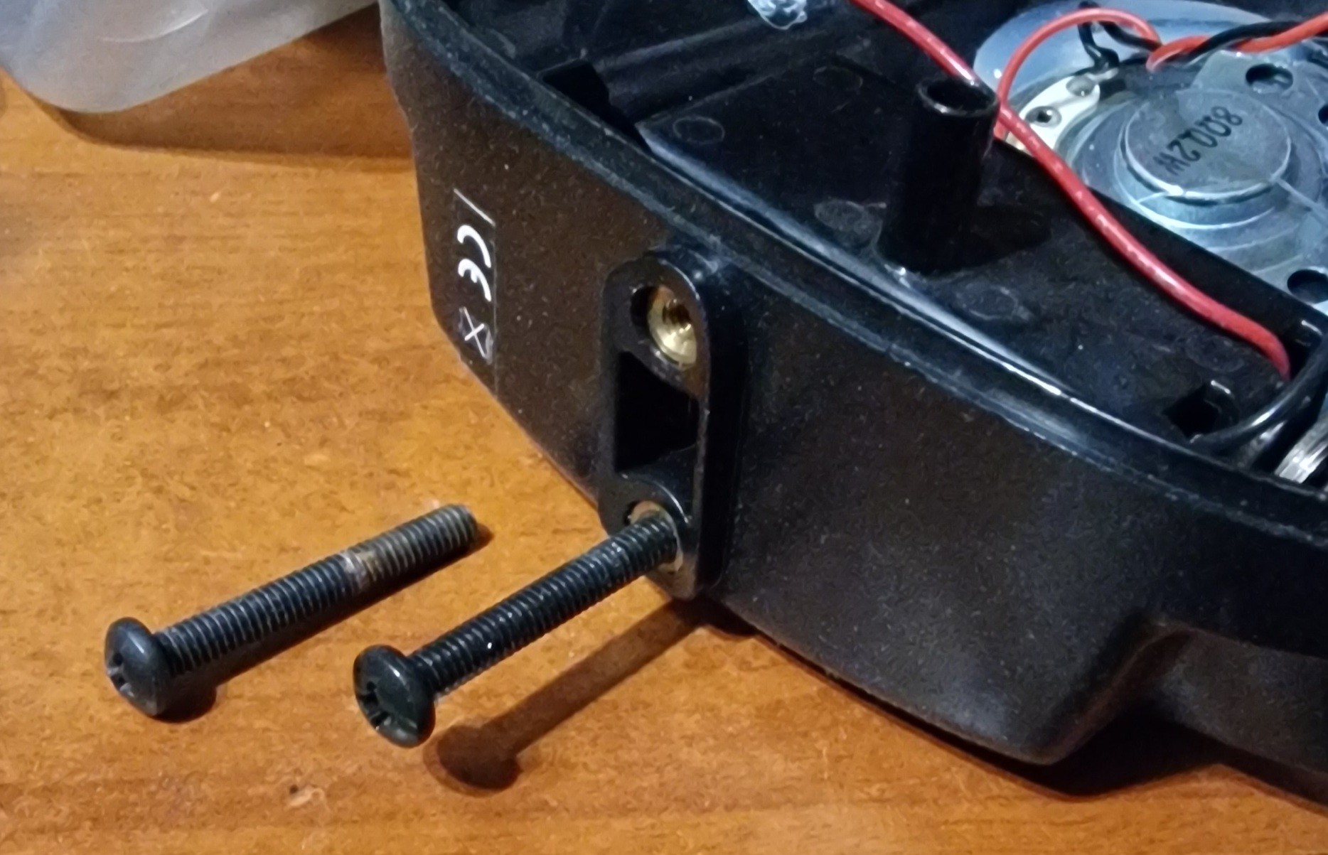

    Dear US colleagues,
    I need to know the type of US thread used in Teknetics, Fisher, and Bounty Hunter detectors, as shown in the picture.
    Can anyone help?
    I am only familiar with the metric gauge.
    Thanks in advance.

    yup, those are inch metric screws, USA. they have more thread step vs EU metric.
      I think they are 8-32, which is a #8 screw with 32 threads per inch.
          Thanks Carl,
          You are right. I got it locally and it fits.
