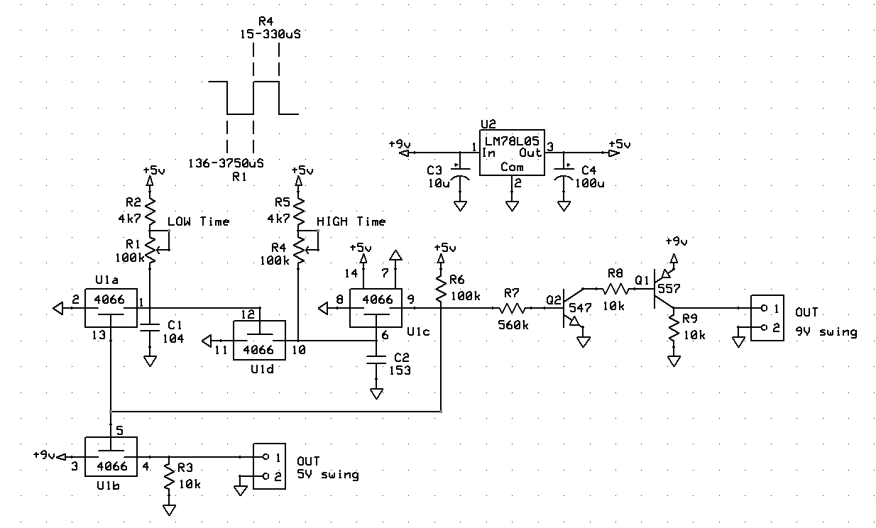

            How about this crazy thing!
            "Poor man" high precision pulse generator!
            8-10mA.
            How about this clocking the PI TX ... or VLF I/B ?
            Click image for larger version  Name:	image.png Views:	0 Size:	19.0 KB ID:	431515​
              Sure, that will work. I'm not sure how stable the 4066 turn-on threshold is. Personally, I would just use an 8-pin micro. BTW, the lower 5V swing is actually 9V.
                Not that it's hard for me to write simple code for Attiny to do the same (and much more)... but this is so crazy and unusual that I couldn't resist!
