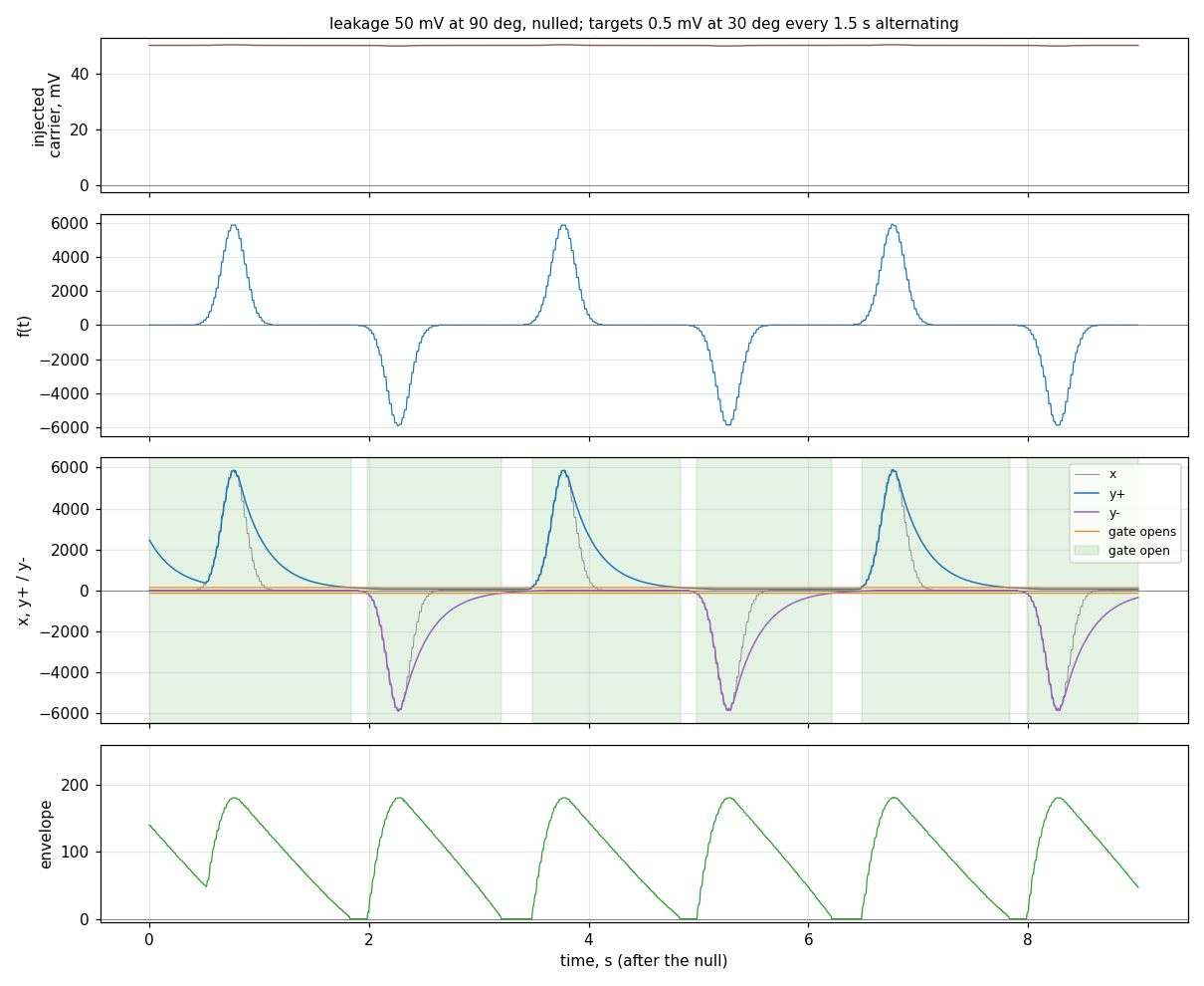

                  LOL .... its only an ADC ...not a metal detector. The only point is that the noise floor is below what any reasonable amplifer can achieve with around 10 to 20 nanovolts of sensitivity but a dynamic input range of +/- 3.2 volts.
                  Of course the transmit signal leakage is going to be there ... but its not going to be near 3.2 volts ... so as long as the ADC does not overload its just math.
                  Below is coil leakage ( on the detector using this ADC ) at 50 mV with a 0.5 mV target at 30 degrees .... on the actual hardware = no problemo.
                  The envelope is the audio output response .. red lines are thresholds etc
