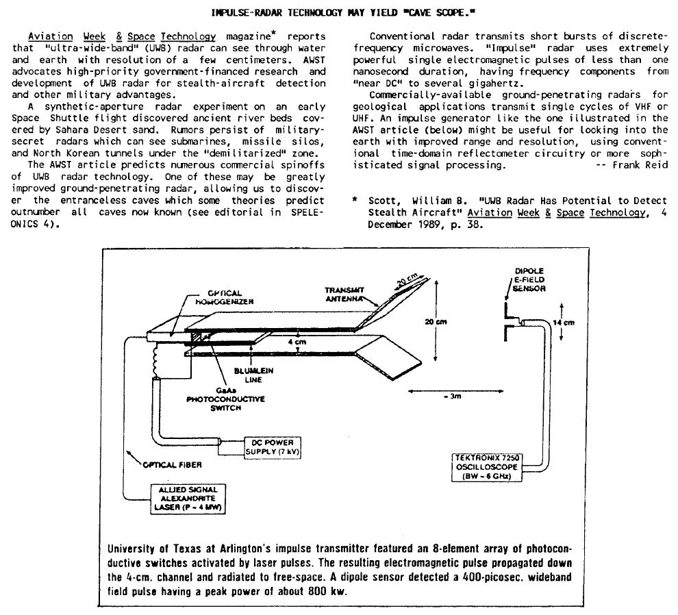

      Ultra-Wide-Band Radar
      I heard about a camera(perhaps of USA military)that can show under ground objects (metals or others )very well
      Probably this is it.
      Technique developed a lot since then, but not for us mortals...
      From Speleonics 14 Feb. 1990

        maybe it was UWB radar .but it was very portable and price about 500000$. are you have more complete information about that ? is it dangrous tool?
            100MW lasers used at this experiments are surely dangerous . There are other types of Impulse Radars already developed, like MIR - M for micropower, surely this is the future of GPR.

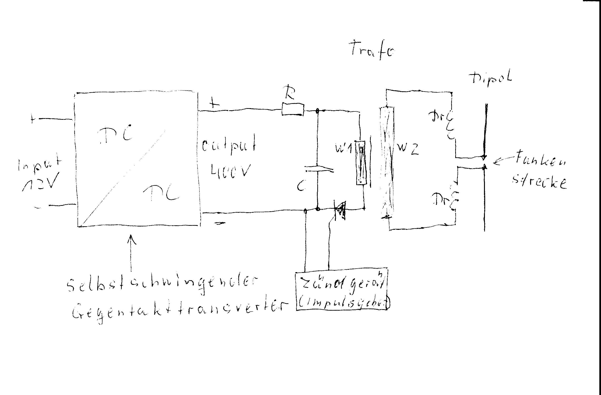

            where the schematics?
            sorry to you too: I sticked my head too close to that Alexandrite Laser - erased my memory at once ...
              ok, so i´ll do it.
              but, it´s nearly the same.
              sorry, file emp.pdf is in german.
                EMP
                Thanks schatzsucher for this.
                I never saw better description (in such detail) of EMP project.
                ..and good for me as I can read german.
                for all the others translation from last paragraphs:
                ...Here shown device can with proper constructed antenna destoy computers and semiconductors in distance of 600 meters. Please do not point the device towards humans or electronic devices. ..

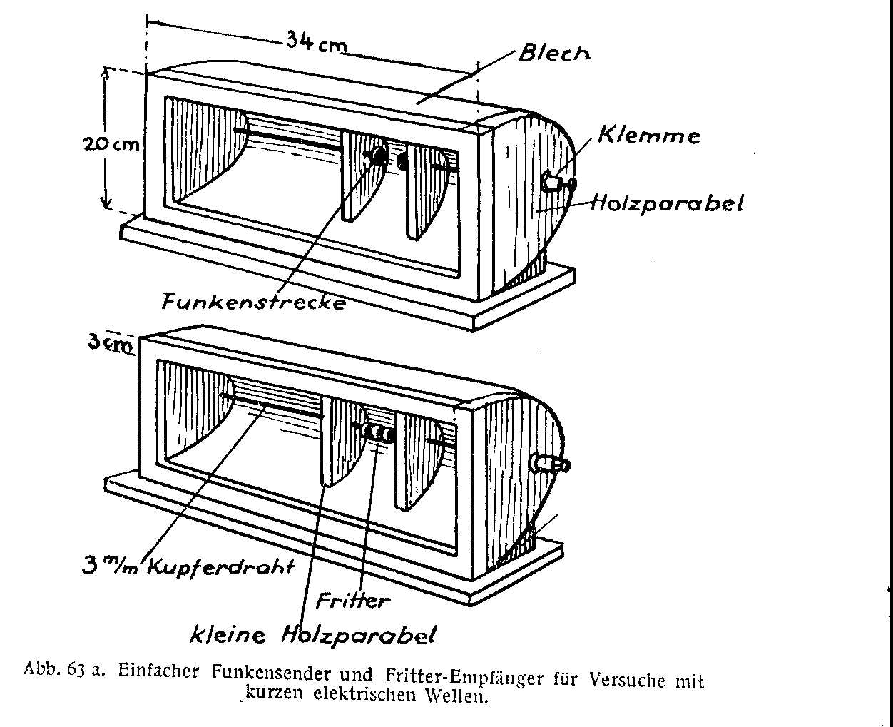

                  at those files has pictures of first TX and RX invented by Heinrich Rudolf Hertz in XIX century.Of course not with semicomductors , but the same principle.
                  So , that TX can't produce single EM pulse , but only burst of hushed waves.
                  For single pulse see ZETEX's applications of avalanche transistors .
