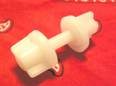

    If you are in trouble looking for plastic screws and nuts, this could be a nice and cheap solution.
    I’m pretty sure that in every hardware store you can find spare parts for TOILET SEAT (…).

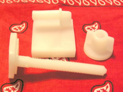

    You’ll get two sets like the one you see in the first picture.
    The second picture shows your goal.
    You just need to cut the screw at the desired length and use both the butterfly nuts.
    Cheap and effective, it works great!

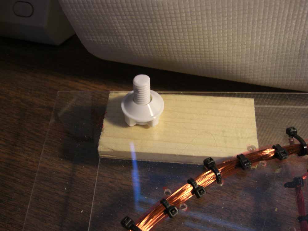

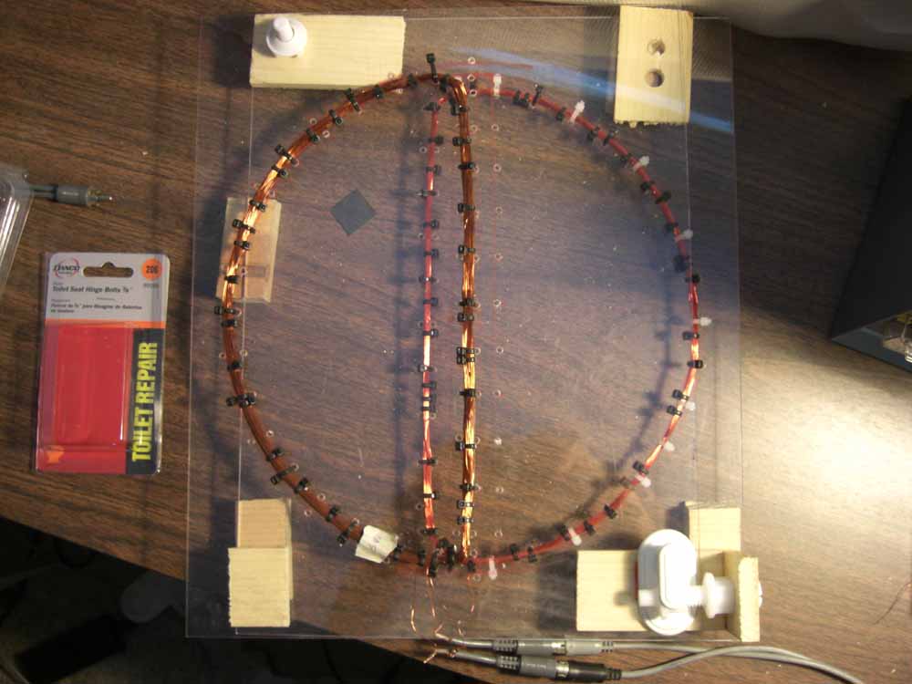

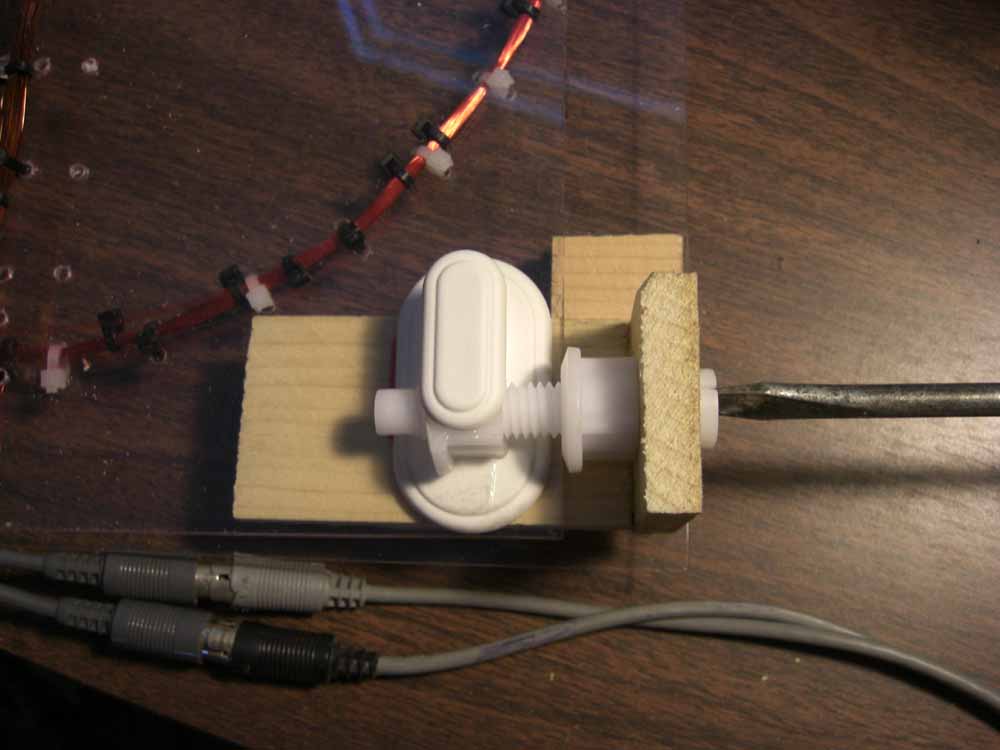

        Photos are of crazy nulling machine for experiments. Each coil is mounted on separate plexiglass sheet, attached with cable ties through drilled holes. One plastic screw is in upper left corner for pivot. Other plastic screw is part of worm gear in lower right corner to move the coils tiny amount. The nut for the screw is glued in a plastic wall hook with adhesive backing stuck to top plexiglass. Wood support for screw is stuck with silicone bathtub caulk to bottom plexiglass. Not shielded yet for experiments.
