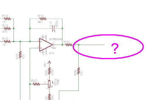

            Hi Tinkerer,
            I highly appreciate your work on "tinkerer PI" projects, but there are too many threads inside your projects and partially uncler circuit for most of us, to be able to put all this circuit puzzle togheter.
            Maybe you can make some résumé and put all parts togheter in one finaly thread? Thank you!
            Example:

                WM6,
                thanks for the feedback.
                You are absolutely right. I need to clean up and post the final version.
