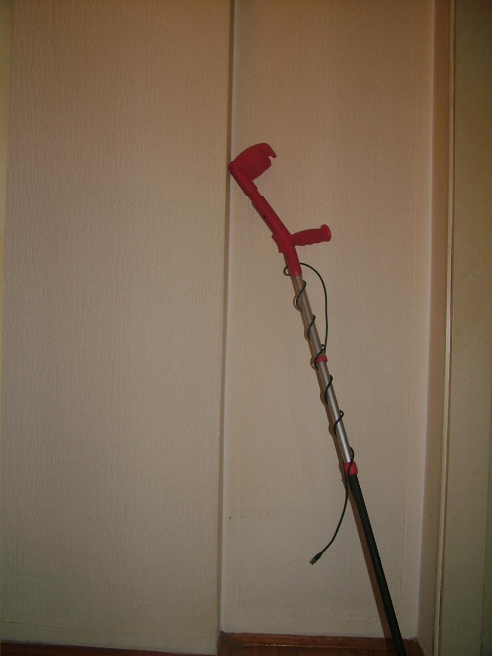

                        This is my favorite "low labor" one: Upper part is from elbow crutch, thin wall Al alloy, 19mm inner diameter. (local cost 11E). Lower part is from "beginners" 3-section carbon fiber fishing rod (5E), diameter fits luckily. Two sections used, inner one wrapped whit glass fiber (boat repair kit) and 2-component resin and inserted in outer section. When hardened, only drill few holes for length adjustment on upper side, and grind down lower side to fit "ears". 10min. of work, very strong and lightweight, even not looking that bad.
                          I have one of this as well but I have turne around handel so the upper shaft is bent in "up direction". I was lacky becouse the Minelab lower shaft was perfect fit for it.
                            I'm using this in "inverted" position for most of the time too, seems to be more practical.
