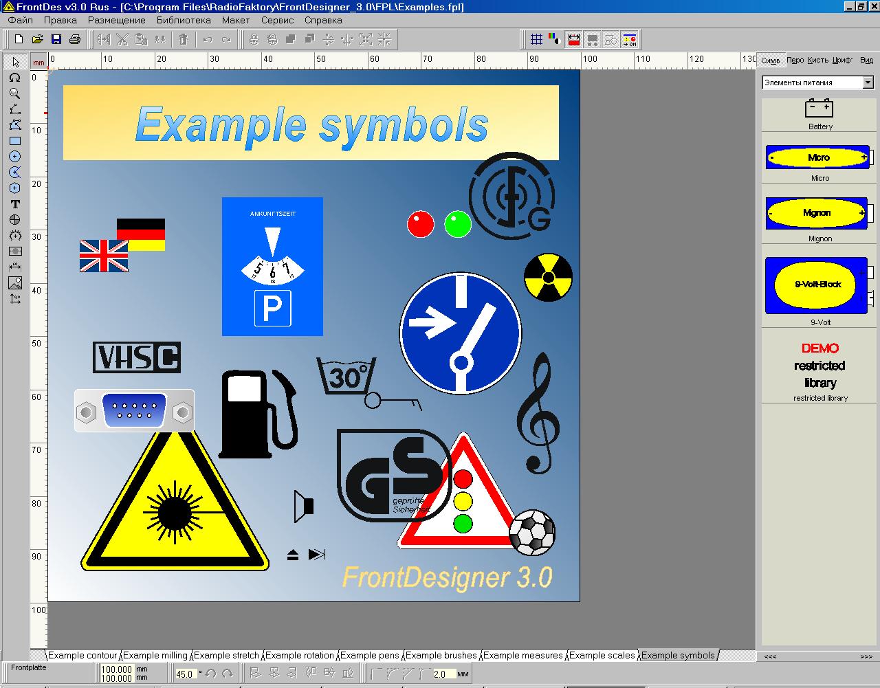

          Dave,
          in our part of the world... we use popular design soft FrontDesigner 3.0, translated in russian. i do not know better for drawing the panel...
          good luck
            Anatoly, do you use plain paper or laminate
              search at igsl thread for posting of selim he linked a free version of front designer

                I work with frontdesigner 3.0 and i use your method N01. I want something better but not difficult. I am a little Lazy......
                  Front designer etc
                  Is the Front designer that Senmon posted fully loaded or the demo version with restricted libary
