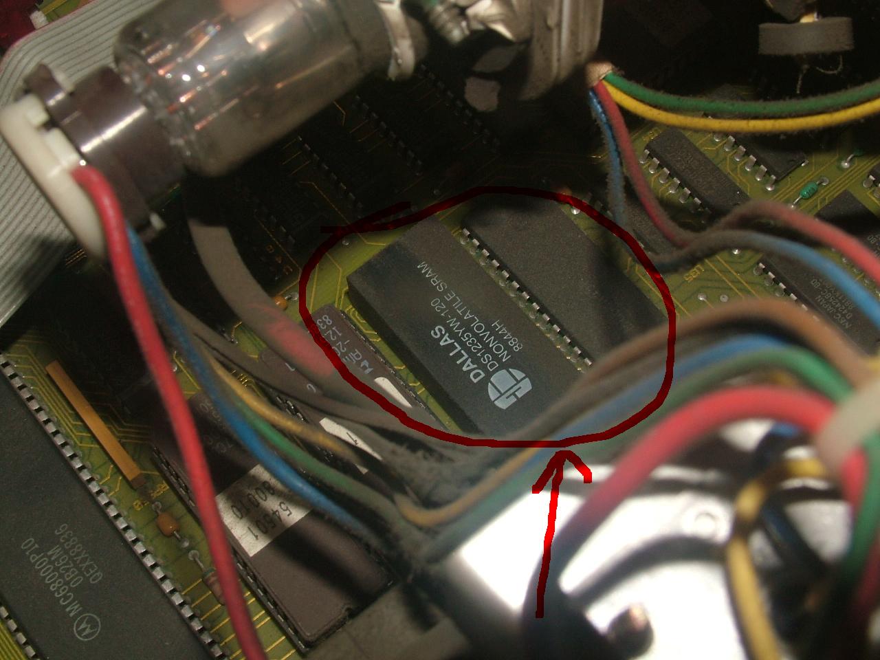

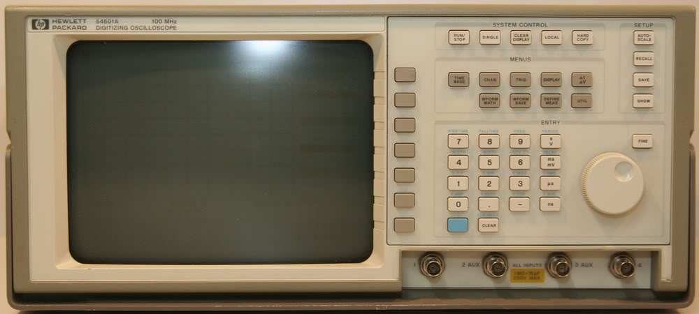

      Instrument on pic below is HP 54501 4 channel 100MHz scope, circa 1988-89 design, average Ebay price around 300$ or so for working one, but there is a catch, see another pic. Machine itself is typical “last forever” HP design, based on MC68000 processor and lot of memory for its time (Amiga 500 style...), two old 8bit MC10319 ADCs and fast ECL acquisition logic, providing 10MSPS per channel sampling rate, but with all 4 channels turned on ADC is multiplexed giving 5MSPS per channel. Equipped with two analog, and two “digital” inputs (with lower sensitivity and limited attenuator range, not standard 1-2-5), large CRT and GPIB interface built in, markers, w-form measurements etc... Service manual is easily available but useless, no schematics, just how to isolate mainboard, PSU or monitor problem. Most imminent one is not mentioned at all.
      Instrument is equipped with 32K NVRAM battery backup memory to store calibration data. Guaranteed retention time is 10 years, instruments are now over 20, so problem is obvious, question is only when, not if, memory will fail. Memory is old Dallas DS1230 type, not yet obsolete (Maxim still made replacement). Battery failure will loose cal data, prompting error message, also frequently cause some other failures, like ADC fail in self test making instrument useless, not responding to any applied signal at all. Instrument in this condition may appear on Ebay in “for parts only” status, for less than 50$, even20! Calibration can be performed with failed memory, but will be lost when instrument is turned off.
      Quick fix: replace memory and run internal calibration. Or, patch it with ordinary 62256 memory, PC motherboard battery and two diodes. You will need to unscrew and dismantle everything to get mainboard out for repair, and some careful soldering on multilayer PCB. Lazy man's way: switch rear panel calibration switch to unprotected, recall default cal data from front panel utility menu, and you will have working instrument. Not fully calibrated, but good enough for normal use, much better than usual modern day plastic toys with screens, called low end oscilloscopes, and slightly cheaper.
      I rescued this one for my friend, also i have somewhat newer HP 54601, obtained time ago, but i cannot recommend 54601 as a good decision to buy. 601 is newer generation instrument, with similar performance, lighter and more portable, but Ebay price is too high, better choice can be made for that money. Old 501 however can be very good low budget choice, i hope this post can be useful for someone to make “opportunistic buying” One useful advice is to carefully check instrument condition, this model was frequently used in ATE systems, remotely operated under computer control, so 20y old instrument may appear as new because no one actually physically manipulated it. Watch for CRT screen burn marks, may be visible after displaying same image for 20y. Interestingly, HPIB command was provided to turn off CRT when operated remotely, but apparently no one ever used that feature.
