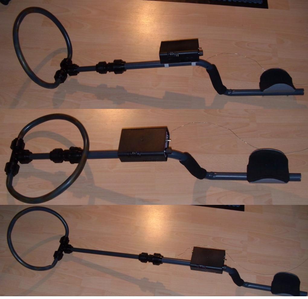

    Hello i have a question have anybody the dimesions (Wide angle an so on) for a normal detector stem the best with a picture thank you .excuse my english im German
    hello from berlin
    i think you will get no other question like that
    there is no standard stem
    if you want build your own use some plastice pipe and bend it with a hot air gun
    to the angle you want and best fits to yout arm dimensions
    if you want to put it in you back pack then modify it so that the longest part fits in there and want build together it is lng enough for you body

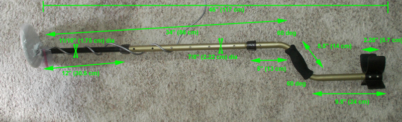

      No my Question was the Dimensions for standart stems (Fisher Whites and so) with a Picture (or a Painting) with dimensions Angle and so on thank you
        Hi Vermeer ,
        So etwas ?
        I've copied it somewhere from Geotech , can't remember who posted it for sure ( -SB ? )
        kind regards ,
        Dennis the Mennis

          Exact genauso was habe ich gesucht exactly thank you very much
