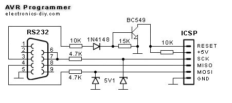

                      According to Dave's post below (and the attached diagram), it is clear that he is using an RS232 connection for the In-Circuit Programming (ICSP), and not USB.
                      What I'm suggesting is that the PC may need to have CTS and RTS linked together, and the programming board will require a separate power supply.

                      Built this programmer to flash hex atmega 8 via ICSP on the minipulse 3 and my computer says theres drive missing.
                      Using pony 2000
                      Connected 5v via usb, lcd screen light comes on but thats it
                      Have I done something wrong ?
                      Tell you now im a novis far as programmers and programming
                      Thanks in advance
                      Dave
                        As a correction to my last post:
                        I notice that the RS232 connection already has pins 6 and 7 joined together, which are Data Set Ready (DSR) and Request To Send (RTS). These signals also go to the ICSP connector, as does the Clear To Send (CTS) and Data Terminal Ready (DTR) signals. So presumably this means that a handshaking procedure is required programming. I assume this must be correct, since the Receive Data (RD) pin 2 is not used. If the programmer is not supplying the required handshaking, the PC will simply wait forever for a response, and no data will be transmitted. It looks to me like the System Clock (SCK) is generated by the PC using the RTS and DSR lines, and then it expects the programmer to latch in the data from RD and reply using either CTS or DTR. This appears to be the handshaking sequence. You should be able to check this with an oscilloscope.
                        Also, it looks like the programming board is expecting the +5V supply to be supplied externally, as the 10k resistor is a pull-up to the BC549 transistor.

                          Still had no luck even with the setup a few of the lads used with the pulse3 even on laptop using xp on lpt port, so ive sourced another atmega 8 from different supplier narrowed it down to the 2 chips, the power led comes on and the r/w light flashes for a couple of seconds but nothing is transfered, wont even read, the plus side to this is ive learned alot and ive 4 different avr programers.
                            What type of error ponyprog reports? It is “device missing or unknown device (-24) “ or something else? Note that if you are particularly unlucky to set configuration bits very wrong, you can actually lock down the chip and be unable to access, reprogram or even erase it using this programmer. I used this on XP, not tried onW7, works fine.

                              yes it is -24, it says cant comunicate, i did the settings as off the designers minipulse3 web page, ive even made a second standalone circuit around the atmega8 as the circuit in the minipulse 3.most of the programing i tryed was as your instructions, or someone with the same name.
                              I do think now i may have buggered these chips myself because found a trace between to pins on the main pcb directly in line with the atmega 8 that shouldnt of been there, oviously a error when I was making the pcb.
