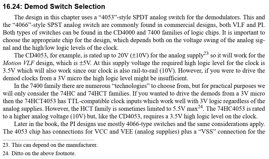

          The HIGH and LOW levels for controlling of the switches of 74HCT4066 are defined in table 8 on page 8/21of the datasheet as >2V and <0.8V at Vcc (4.5V-5.5V). For me it is not clear from all datasheet is it allowable for 74HCT4066 to work with power voltage more than 5.5V an what will happen with levels of control voltages in this case. Misunderstanding is provoked by the table 4 on page 4/21 where absolute maximum power voltage for both HC and HCT variants is defined as +11V, but in the table 8 on page 8/21 no information for switching levels of HCT variant in case when power voltage of HCT variant is more than 5.5V.
            Both the 74HC4066 and 74HCT4066 have an absmax VCC-VEE of 11V. The HCT is characterized at 5V because it's intended for TTL-compatible circuits, which are 5V. But it will run at 10V.
            If you pretend that VCC=10V and VEE=0V then for the HC version the logic swing needs to be 7V (VIH). But the HCT has a VIH of 2V which works nicely even with a 3V micro.
              Still I not see information in the datasheet for switching levels of the HCT variant when power voltage is more than 5.5V. Maybe you are right but there is no explicit information for this.
                No, you won't find that in the data sheet. But it works just fine.
                  Congratulations for the manufacturer! Thank you!
                    New information for me. The company TI also manufactures 74HCT4066 (the name is CD74HCT4066M96). In the data sheet from TI, absmax Vcc is 7V. So, the mystery continues. Have you really tested the 74HCT4066 from NXP with 10V supply?
                      It's not unusual for different manufacturers to have different absmax limits so it's possible that some will run at 10V and some will not. The oddity is I am using a TI CD74HCT4066 and it runs fine at 10V. Here is what ITMD3 says on p315:
