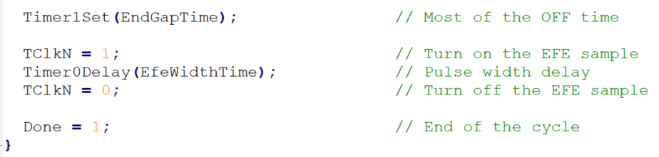

          Firmware for Pulse-2 & 3 (Improved PI) is now posted. It defaults to Pulse-3 (EFE pulse enabled); to run it as Pulse-2 simply comment out the "TClkN = 1;" line:

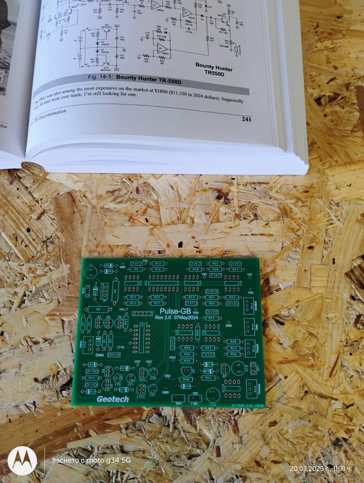

                              Hello everyone.
                              I was thinking of using the Bipolar board - the power supply doesn't work.
                              This is a better option - I'll try another pumping method.

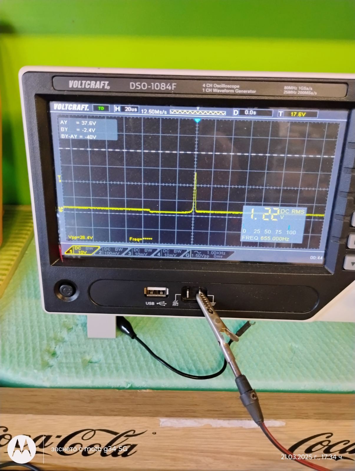

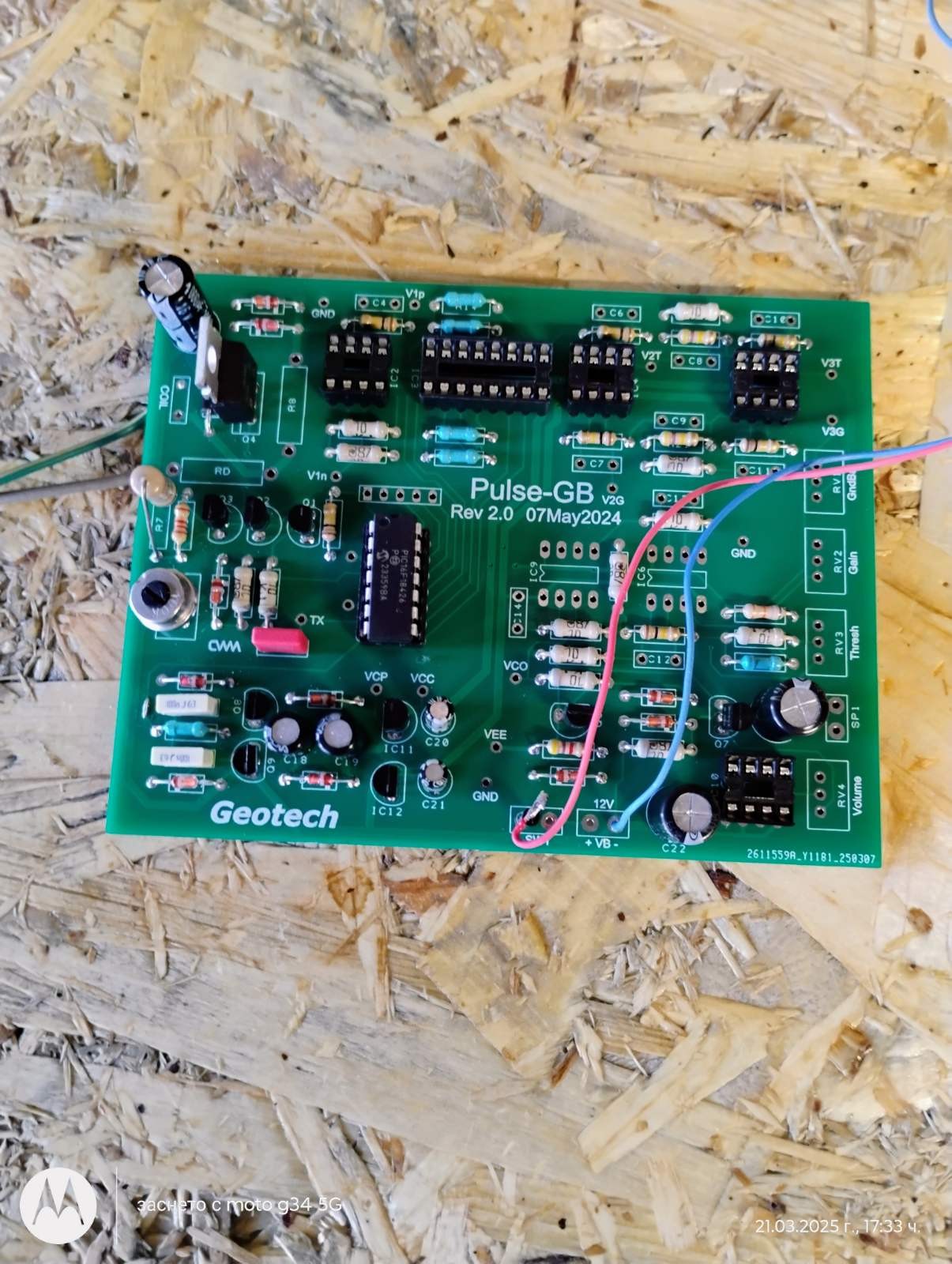

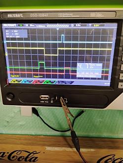

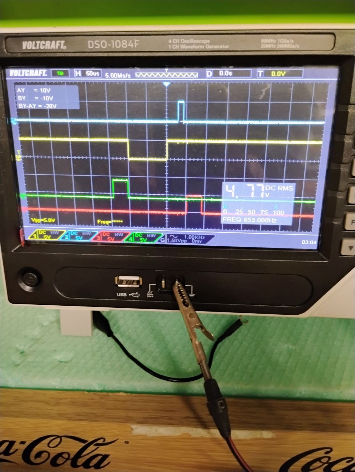

                                Hello everyone.
                                Here's what happened.
                                Click image for larger version  Name:	viber_изображение_2025-03-21_17-34-53-892.jpg Views:	0 Size:	299.2 KB ID:	435560
                                Click image for larger version  Name:	viber_изображение_2025-03-21_17-34-54-698.jpg Views:	0 Size:	364.3 KB ID:	435561
