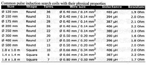

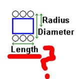

    What is the "Length" of coil used in these calculations?Click image for larger version
    • not.
      you use probably one layer coil calculator. you have choice several layers.
      then you have to operate by:::
      core length
      coil depth
      core diameter
