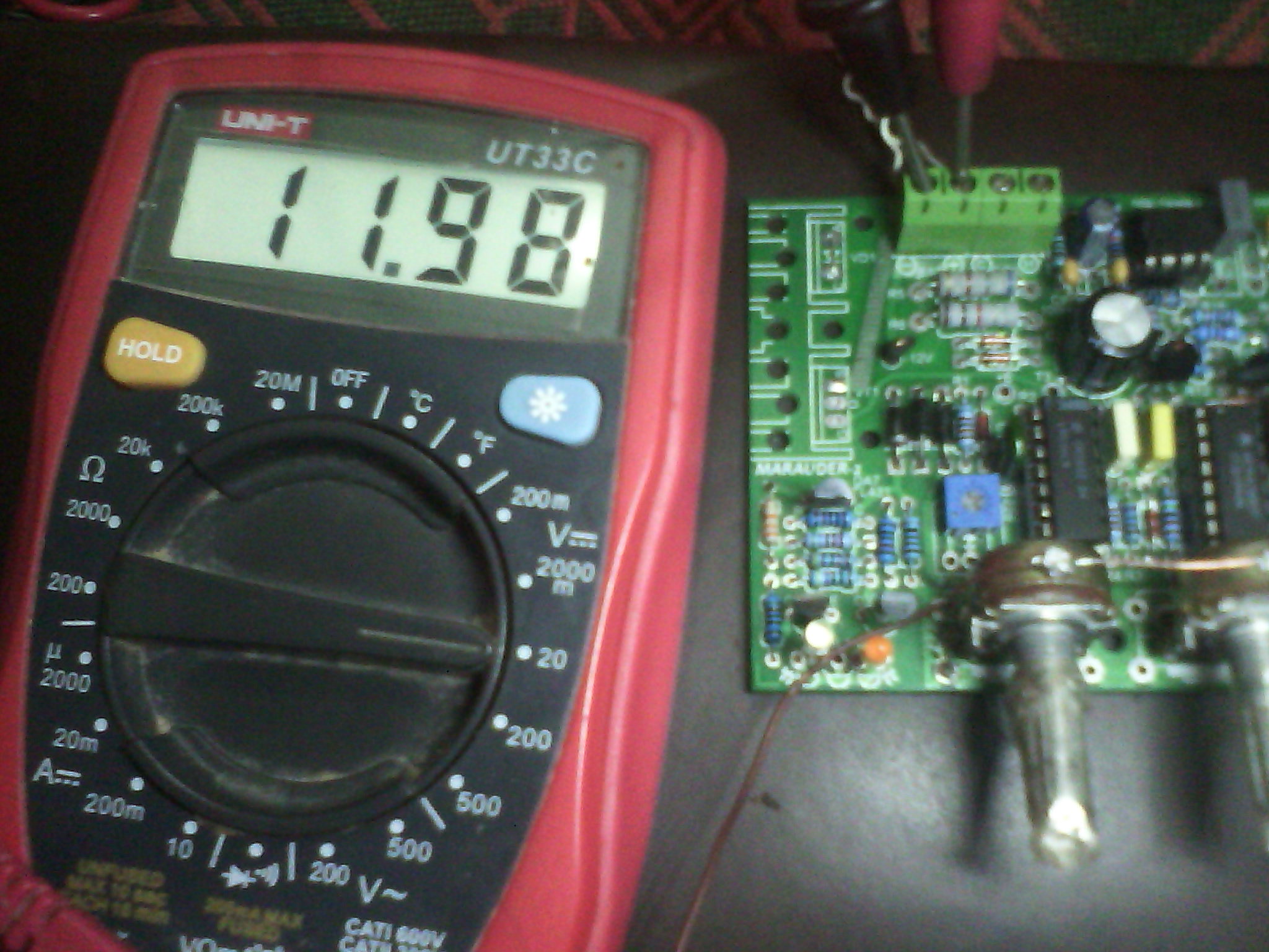

                        • measure voltage on terminal block, ON THE ITS SCREWS DIRECTLY.
                            [ATTACH]48152[/ATTACH]
                            The voltage here is 12 V DC.

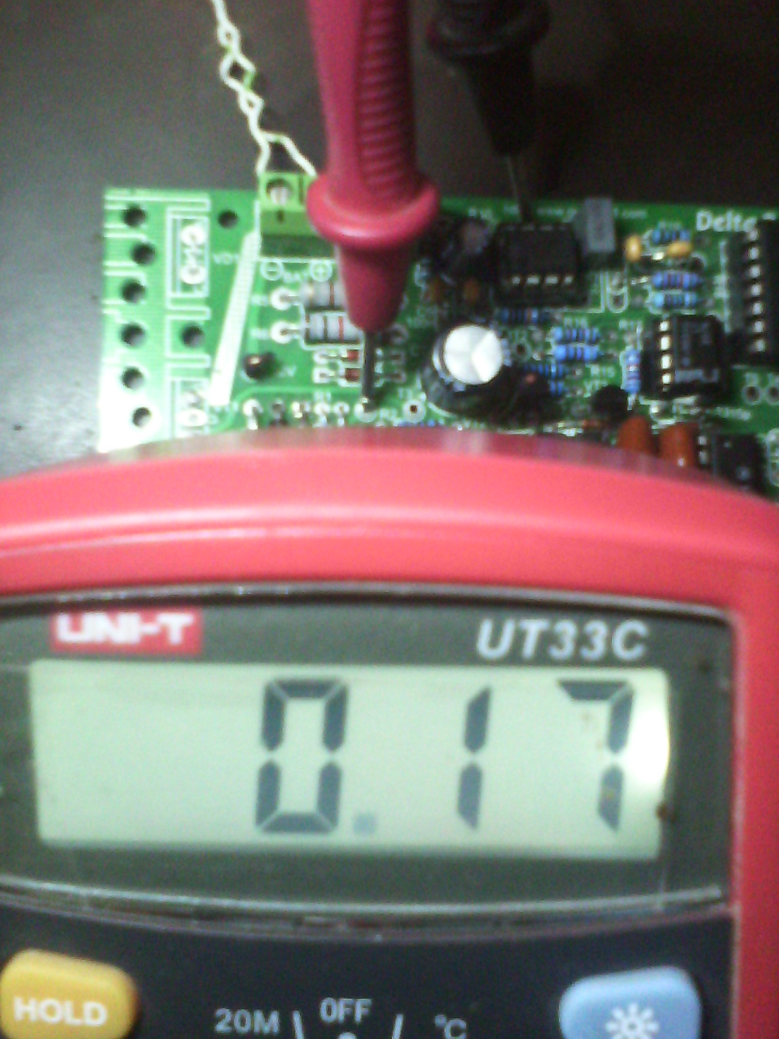

                            Next i measured +E 0.17v DC.

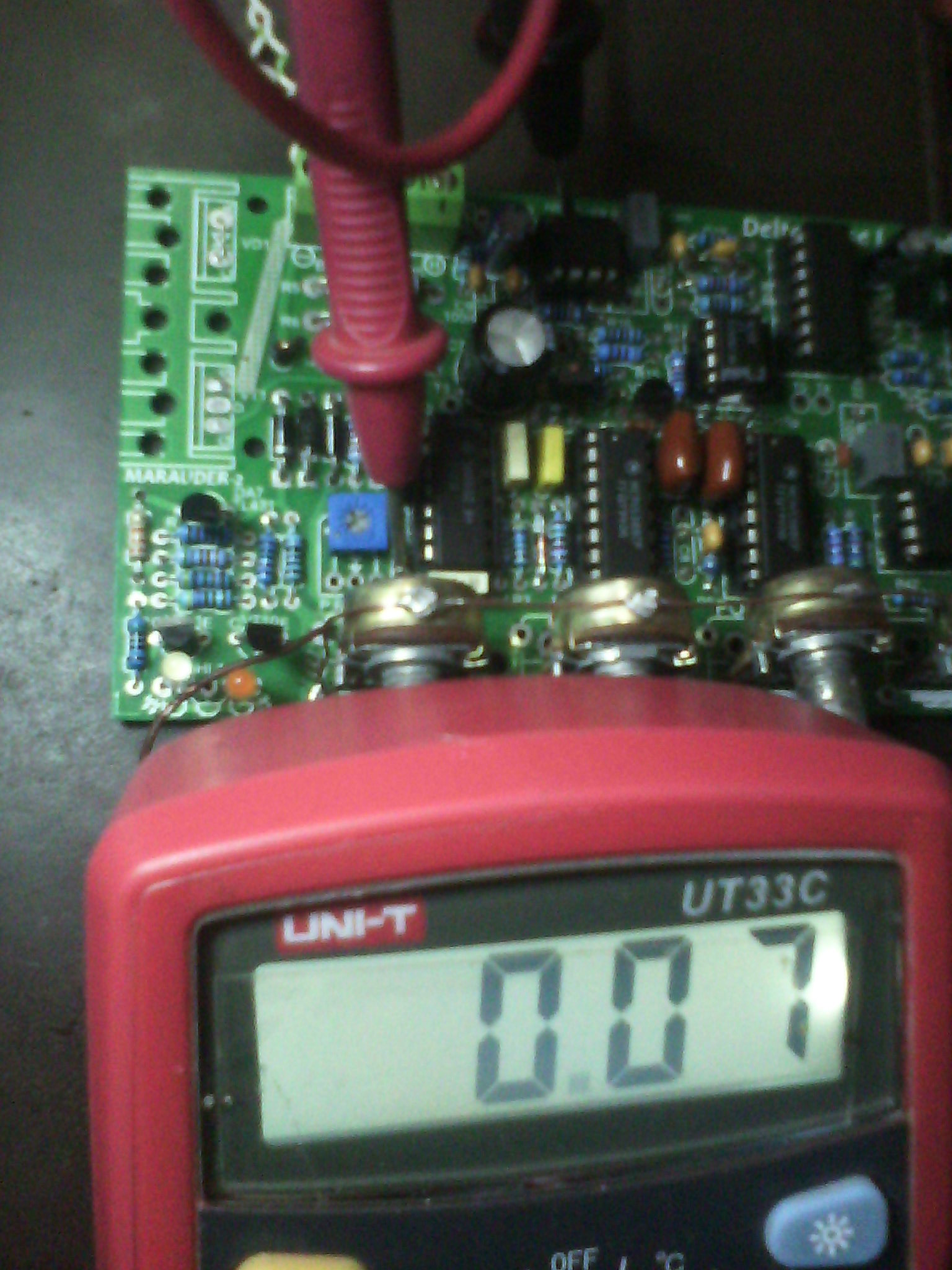

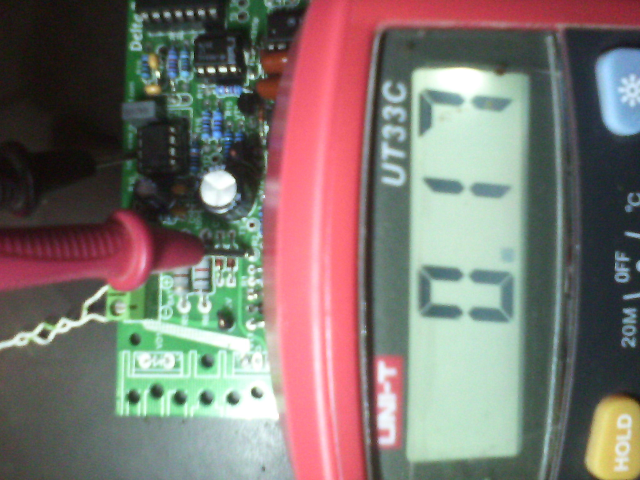

                            Next i measured -E 0.07v DC.
                            • Voltage on screws of terminal block.

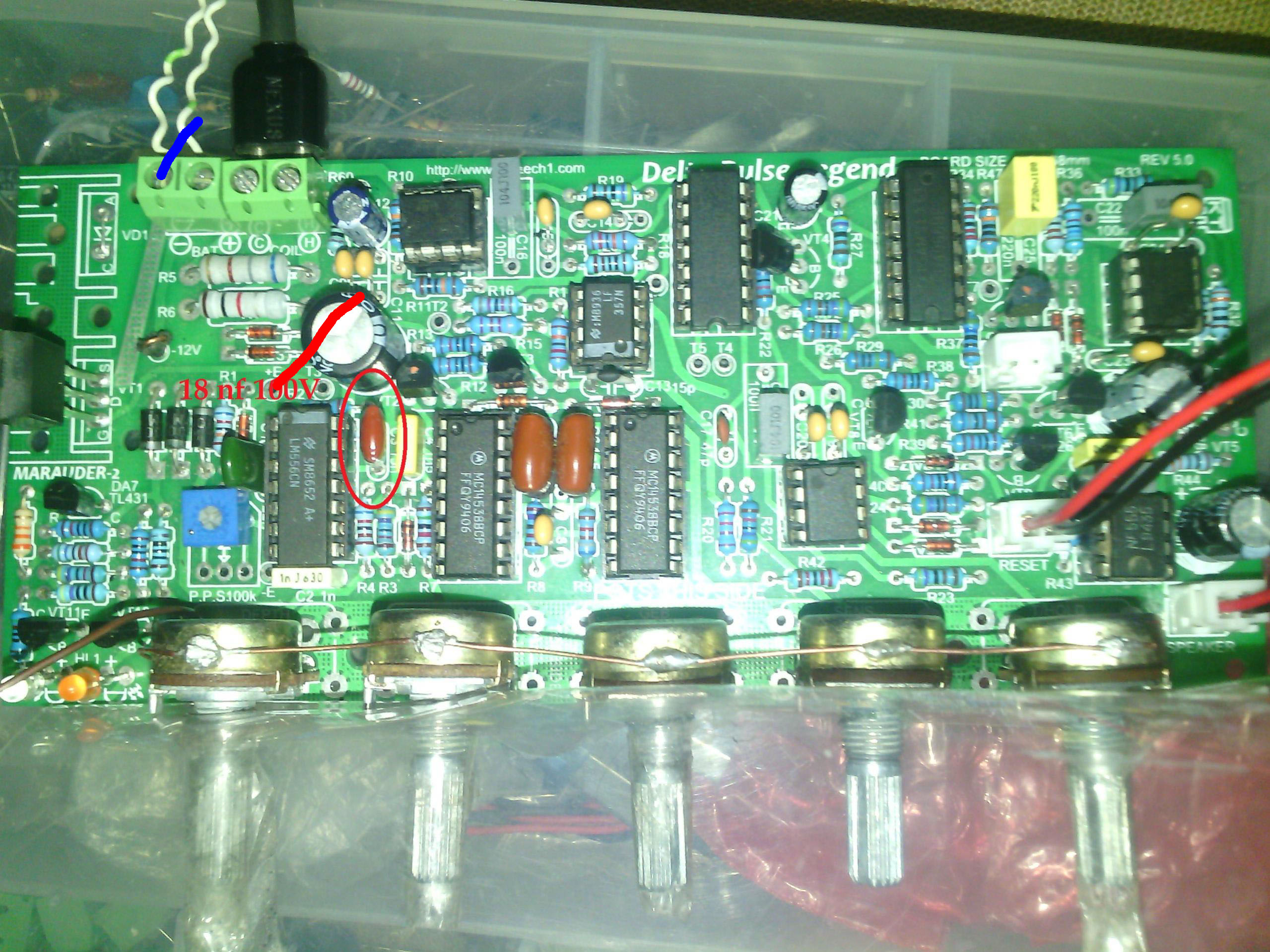

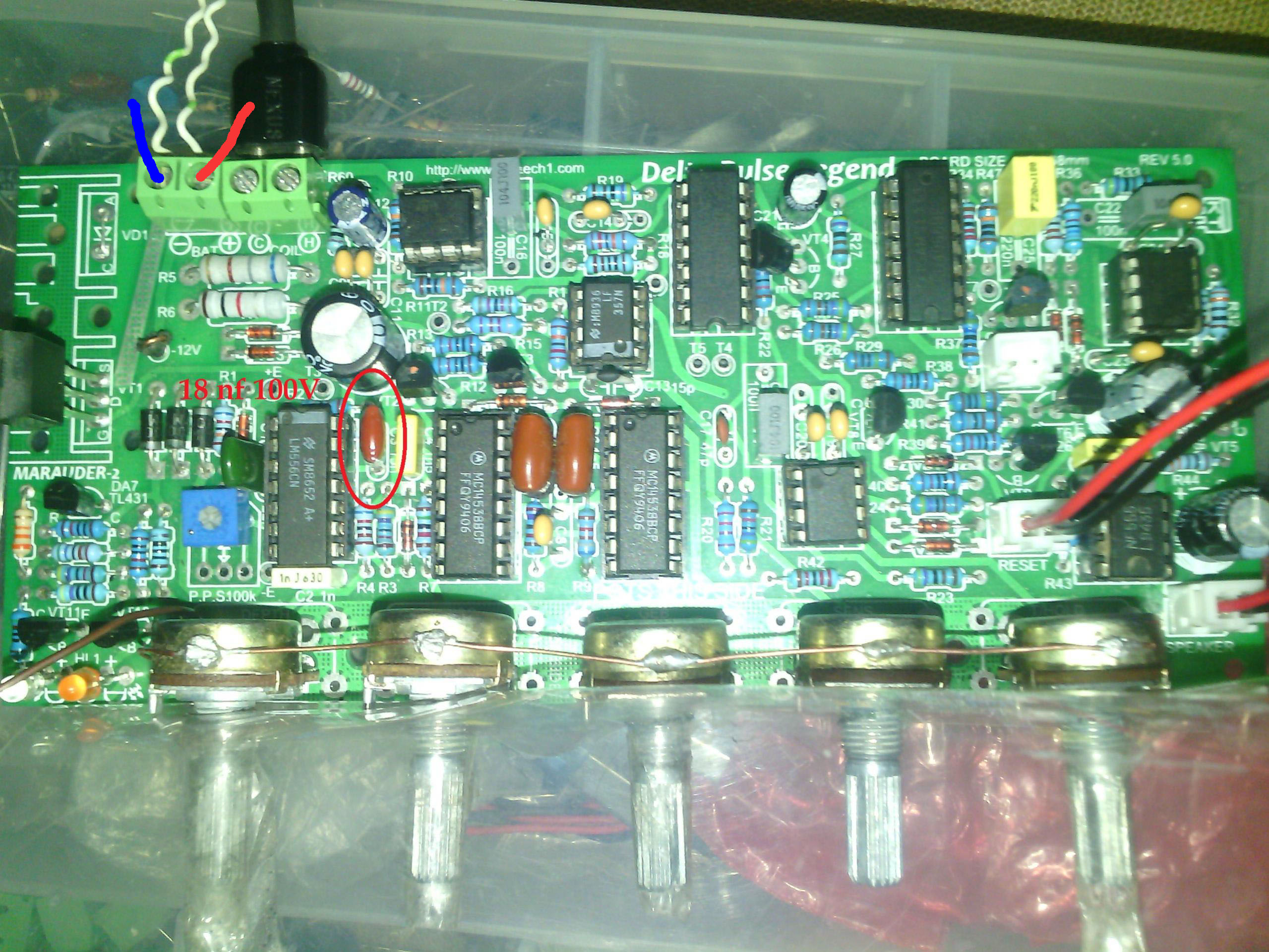

                              • i did not ask you to measure in other points. i am not interesting in a result of your stochastic wandering at pcb without any understanding of the schematic
                                and what you want to see there.
                                measure voltage on pic Click image for larger version
