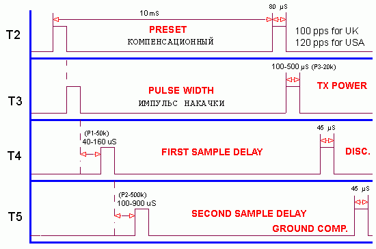

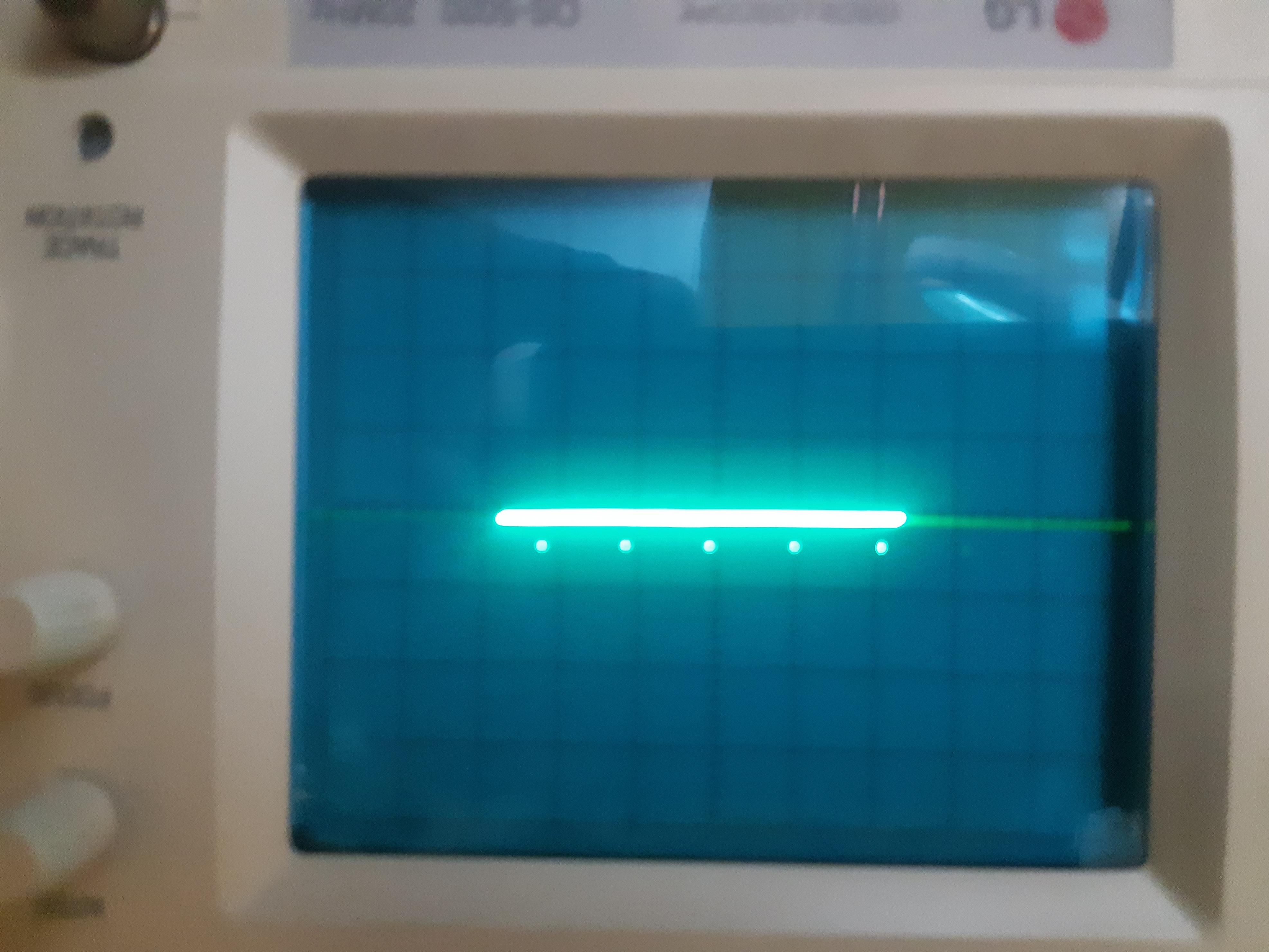

        • nosense to twist the pots if board is not working. set o-scope probe in T3. set 100 Hz by PPS trimmer.
          check pulse width changing by DEPTH pot, it is minimal value 150, maximal 500 us (MICRO seconds).
          100 Hz is period 1/100 = 0.01 s = 10 ms (MILLI seconds)
          • T3 on scope
Name:	Delta Pulse - T3  .jpg
            • this diagramm is not in scale, but you have to get same signals. that is in relation to -E, ie your GND wire of o-scope probe is connected to MINUS of battery.
              or after diodes VD8 VD9.

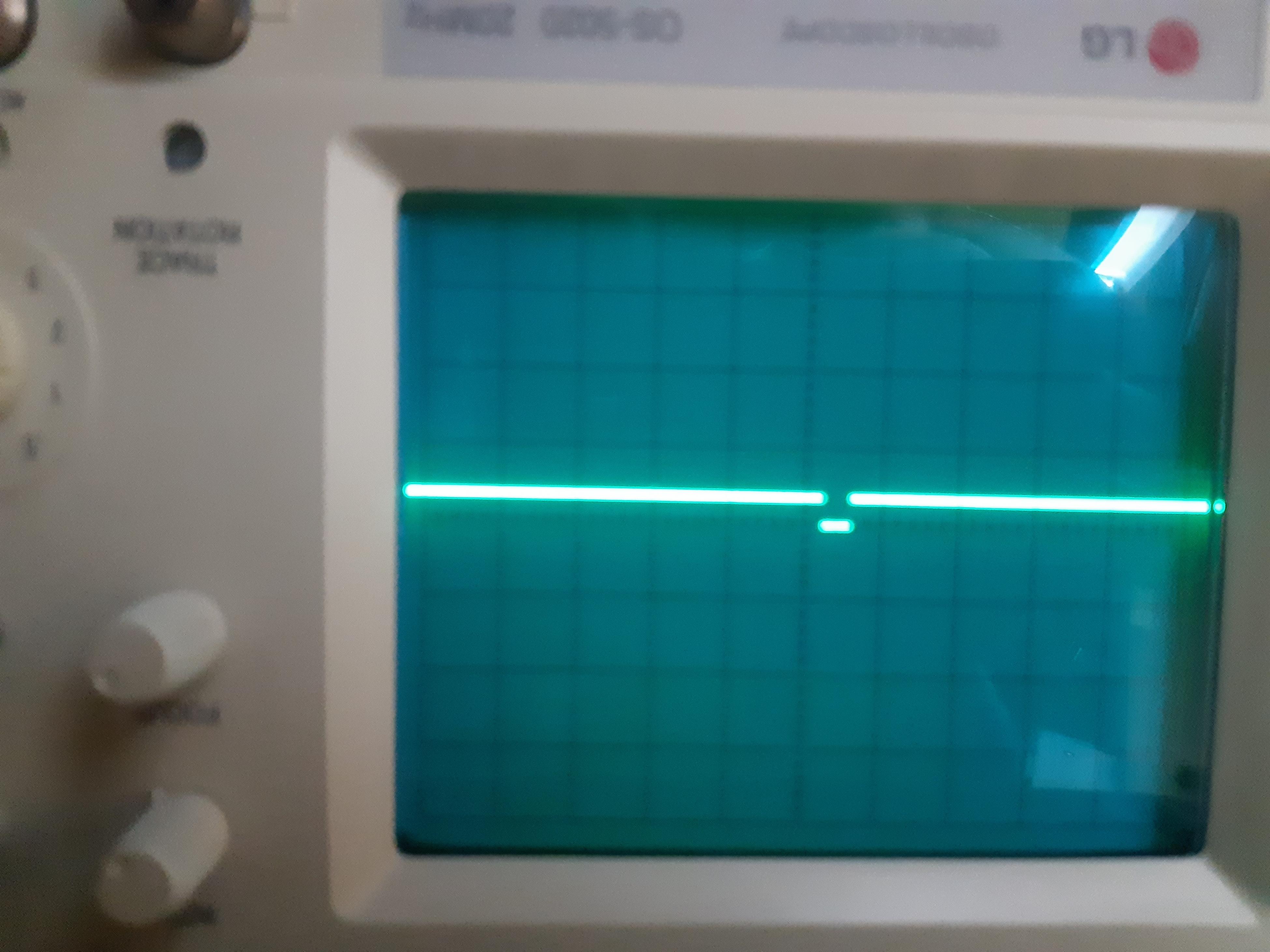

              • Sorry KT315, new try.
                2 photos, one with Depth knob at min and one at max. Hard to see in picture but there is a small difference at the length of the short part.
Name:	Delta Pulse T3 Depth at min.jpg
Name:	Delta Pulse T3 Depth at max.jpg
                • normal standart reaction https://www.youtube.com/watch?v=geX1...ature=youtu.be
                  • mosfet transistor is opened by positive signal. it is very small, in relation to period. period is 1/100 0.01 second, signal width is 0.000150 second. 150us.
                    you get strange impulse. desolder mosfet and look impulse on the mosfet's gate point again.

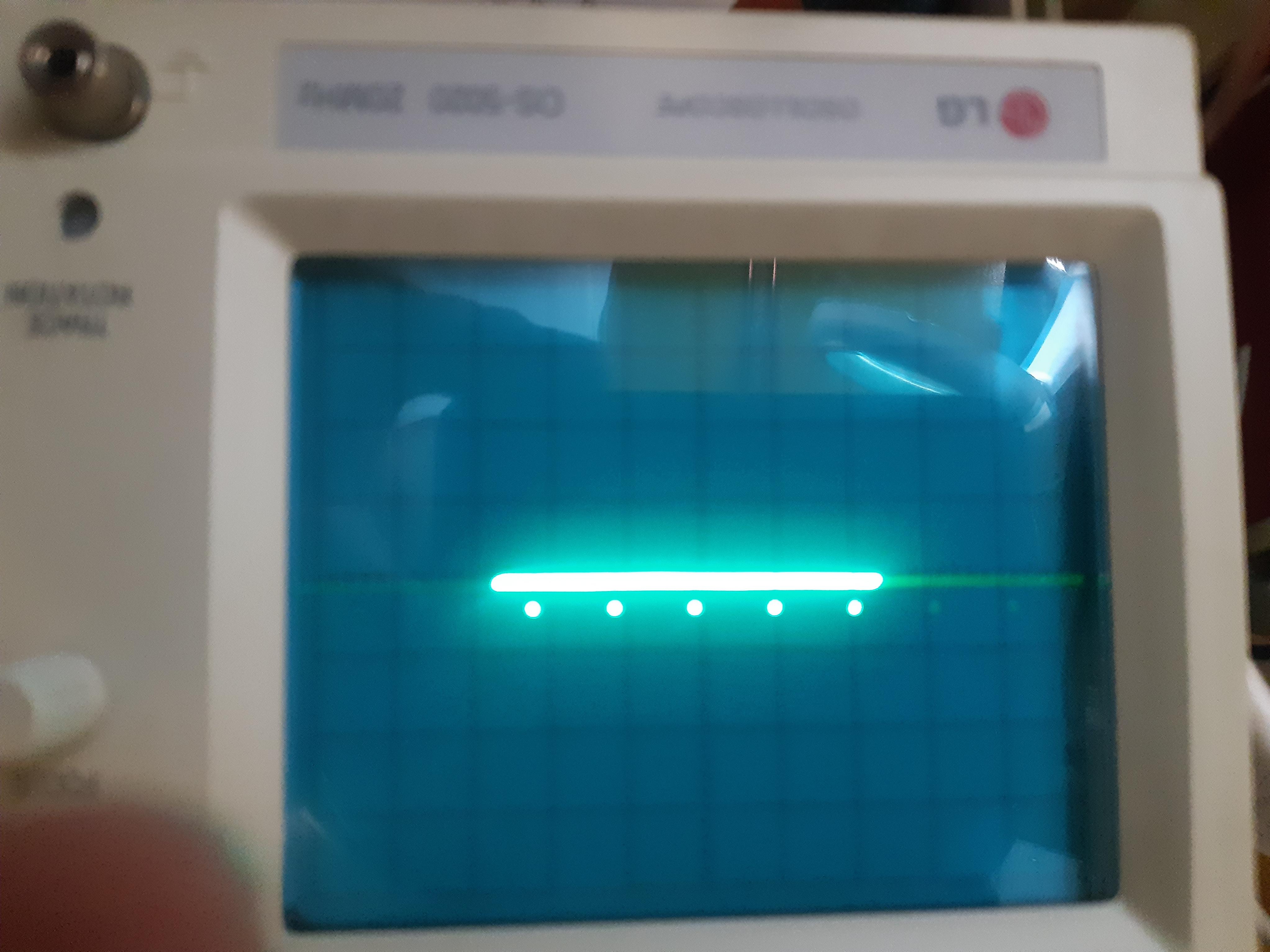

                          • Yeah, I have seen this video earlier. And I have a Bulgarien XR-71. So I know what to expect.
                            Gain point at the Mosfet is the same as T3 when desoldered, and Drain is an inverted Gain when Mosfet is in place.
                            One thing I have noticed: The R5, with or without coil, is not getting hot any more???
                            "you get strange impulse" by that, do you meen that the scope do not show a continues string of measurements?
                            If so: It is the scope that causes this brake in the measured string.

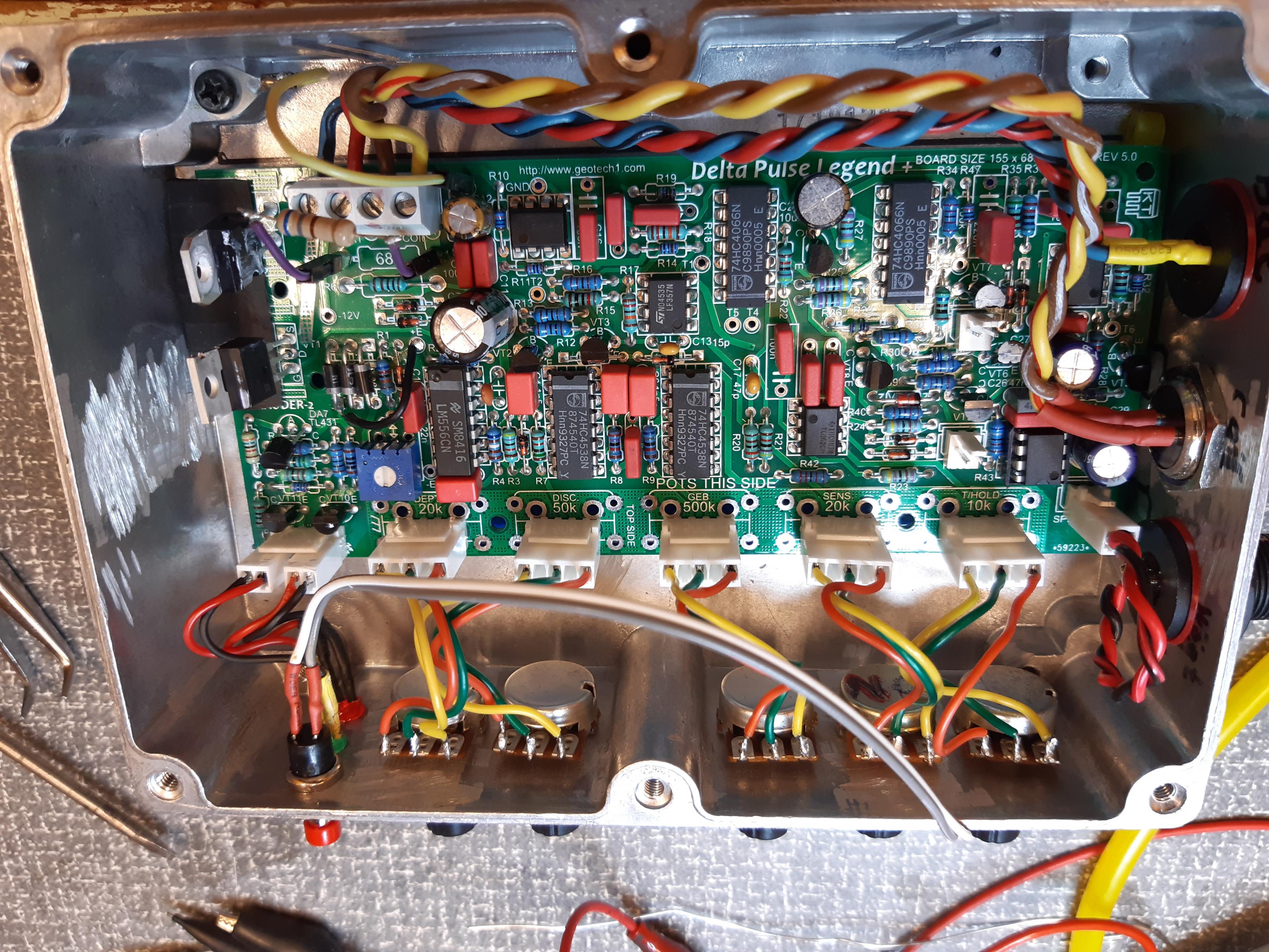

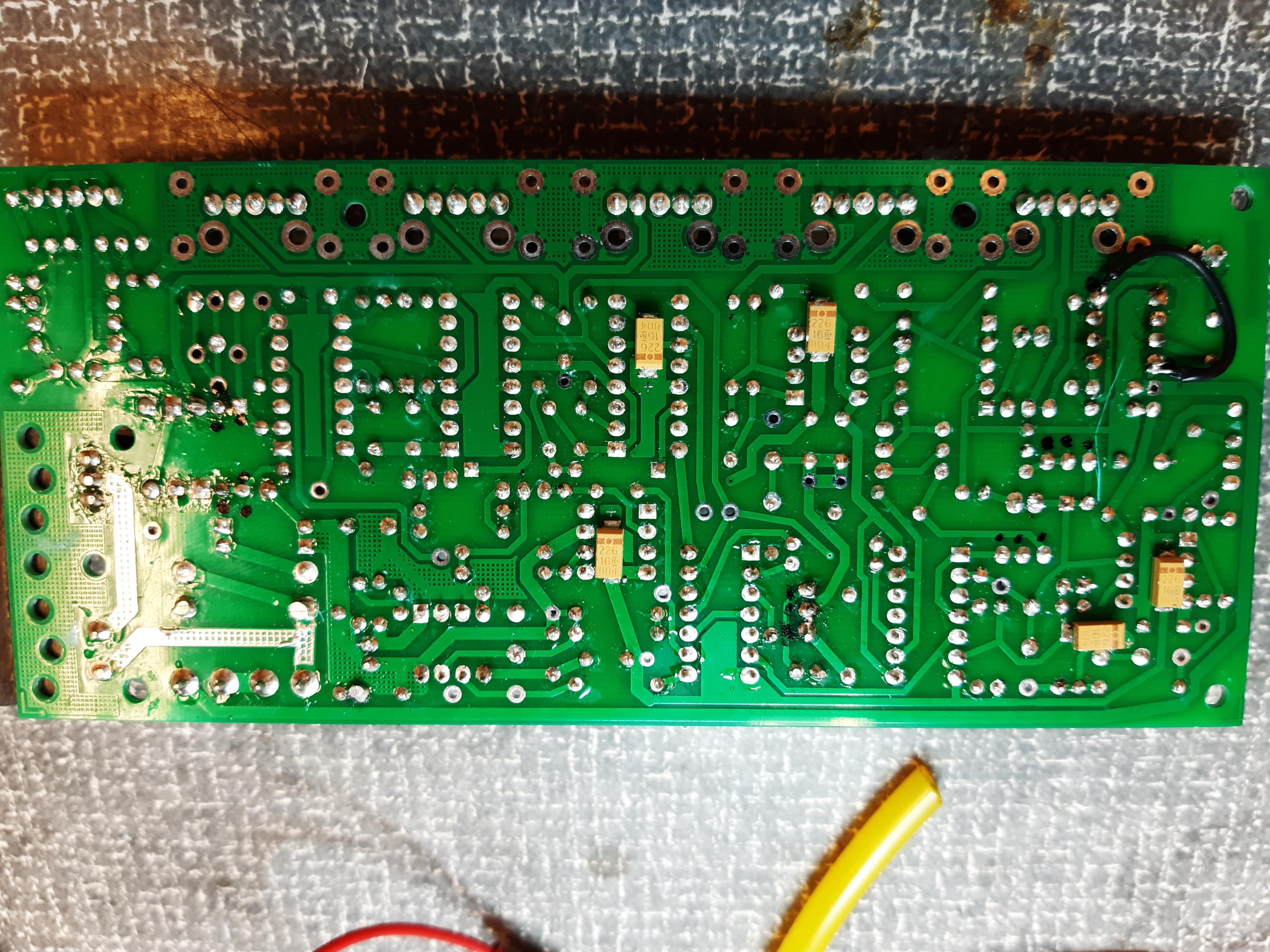

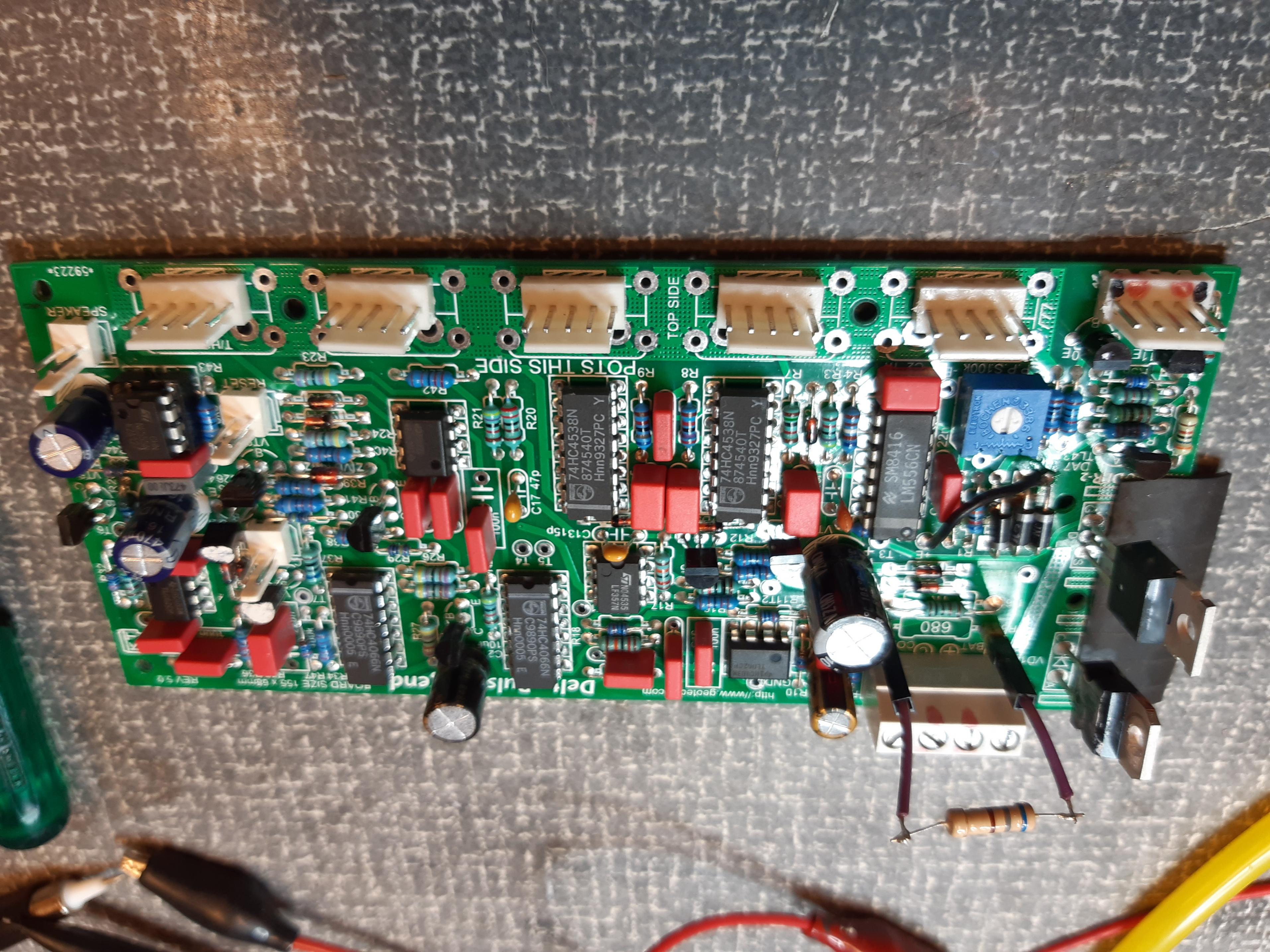

                            • do not set o-scope on drain. NEVER. you'll burn it. time to look on pics of your board.
                              i feel you do something wrong.

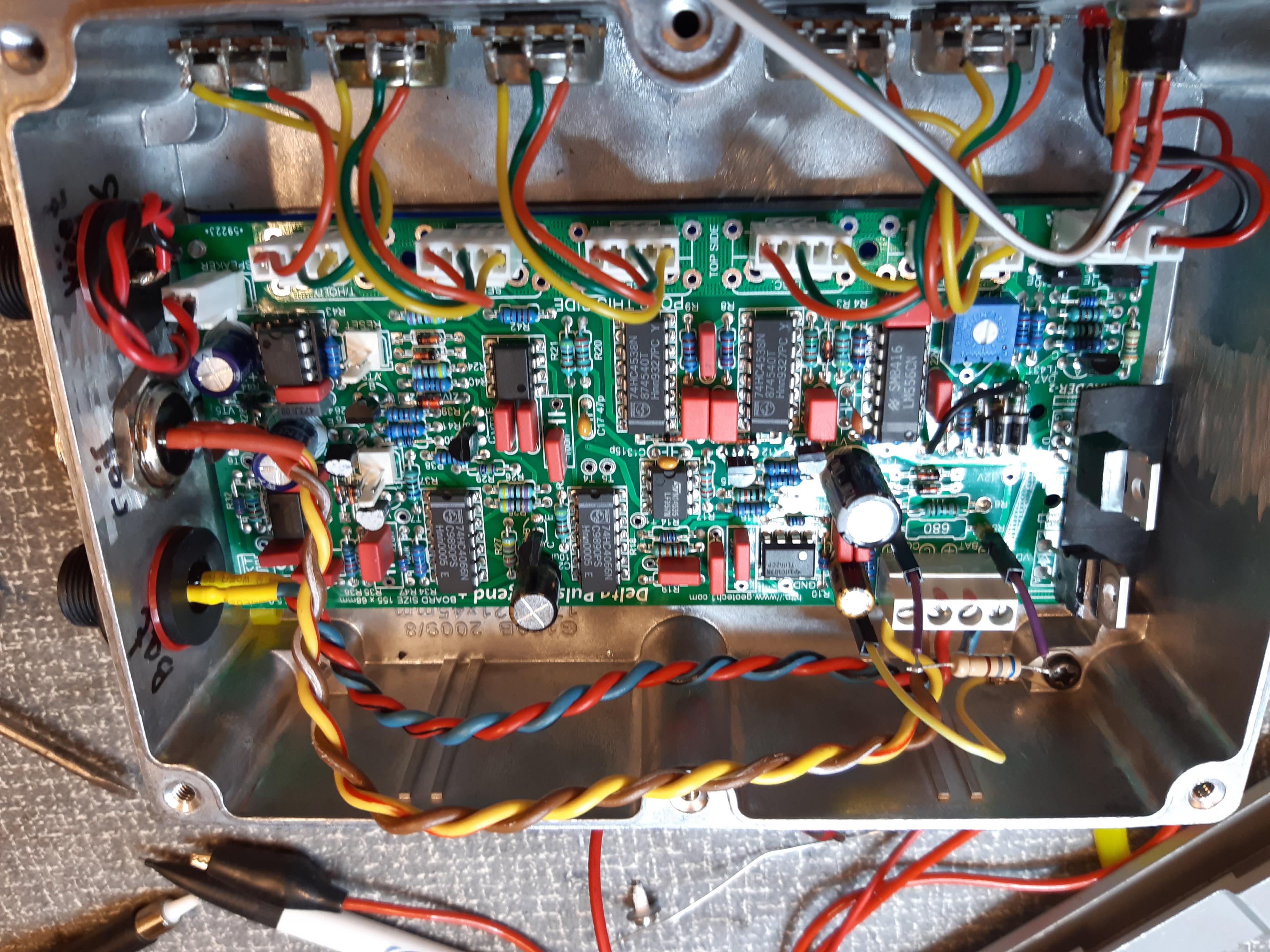

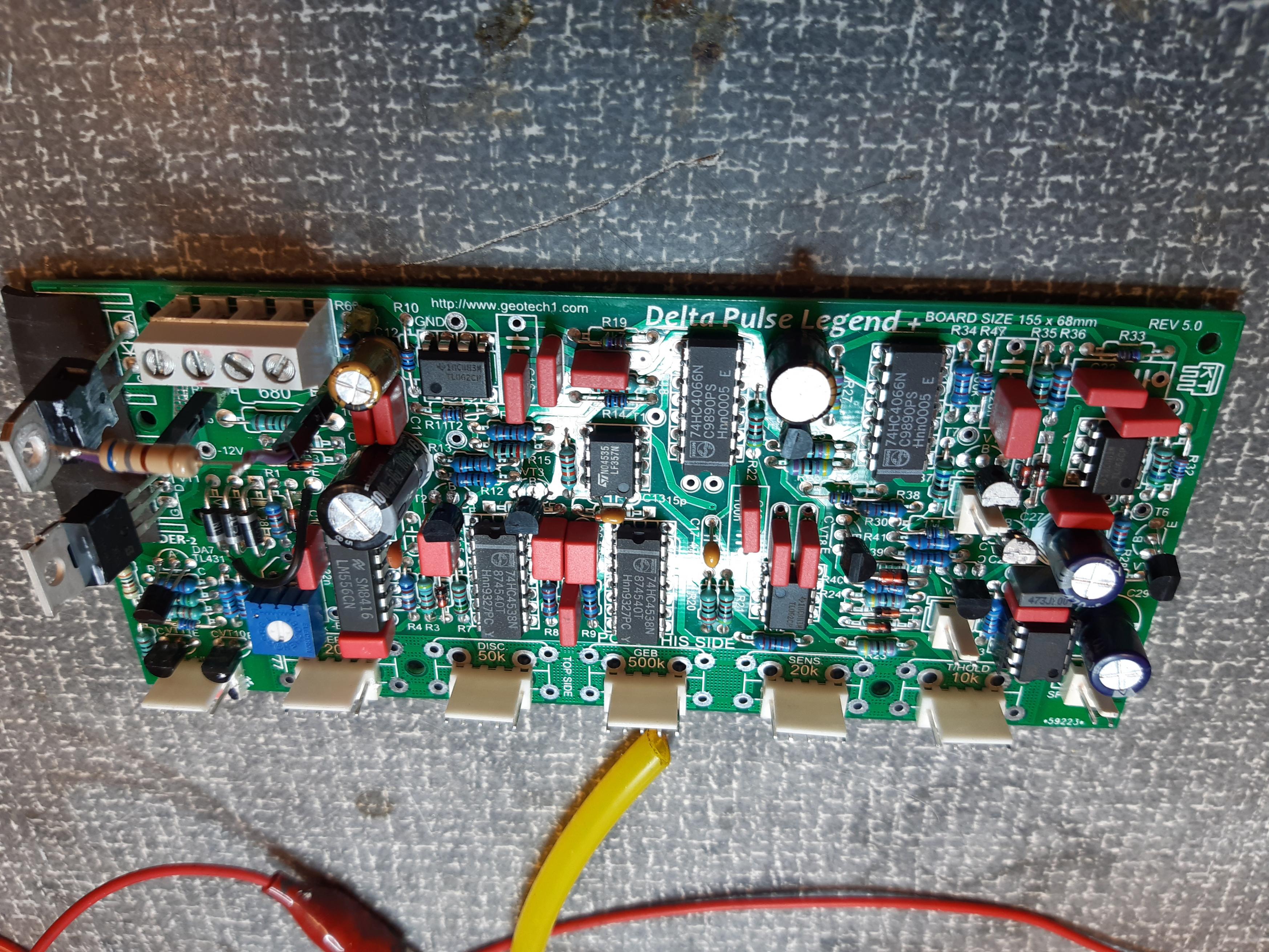

                              • Yes, here it comes.
