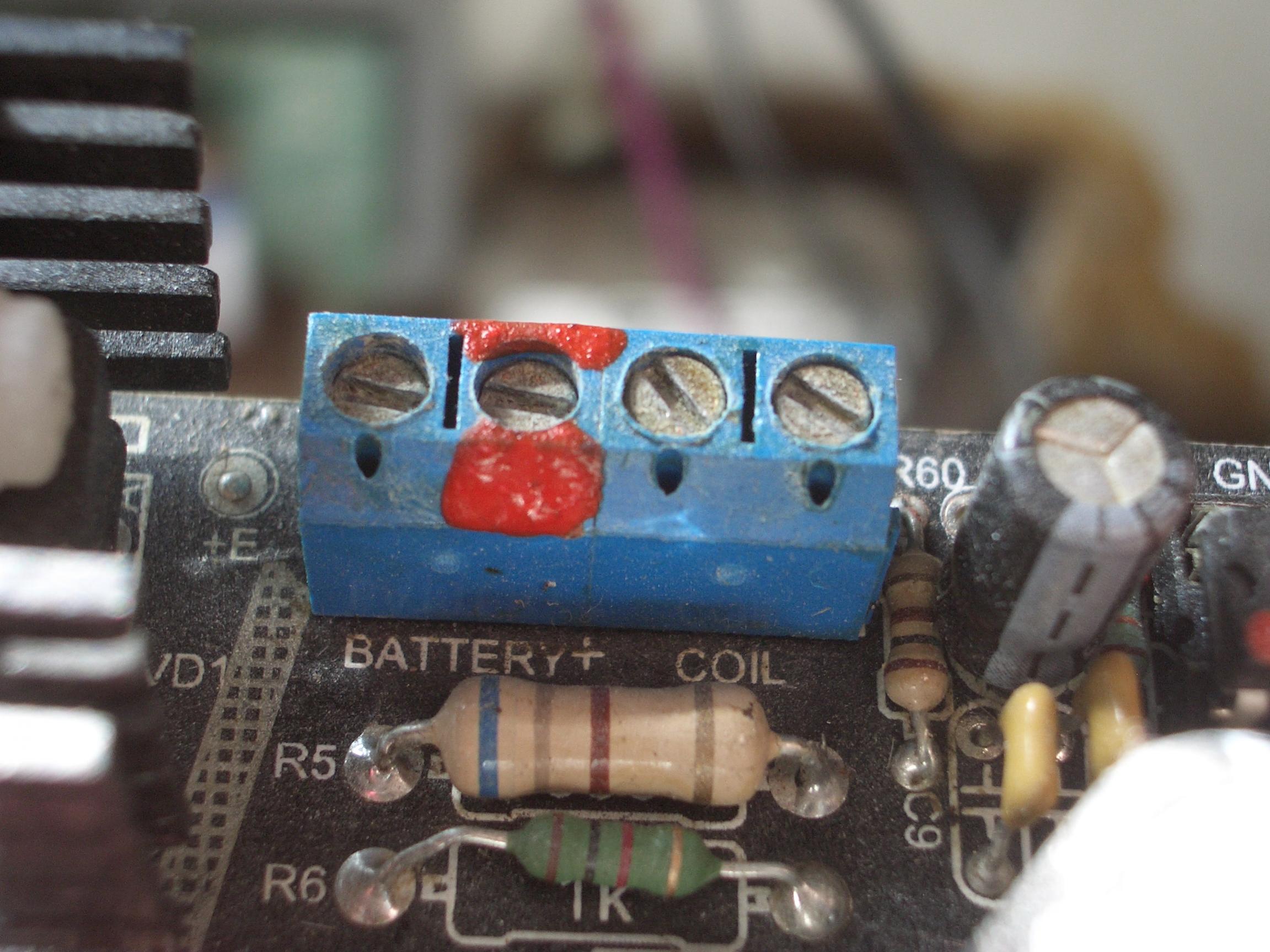

      also, use RED and BLUE paints for marking PLUS and MINUS of pins connector. mark them just you soldered it on board. i use varnish of different colors that females
      usually throw out.
      always in your life use RED wire for positive voltage and BLUE wire for negative (ORANGE - BLACK etc).
      then you never do the mistake.

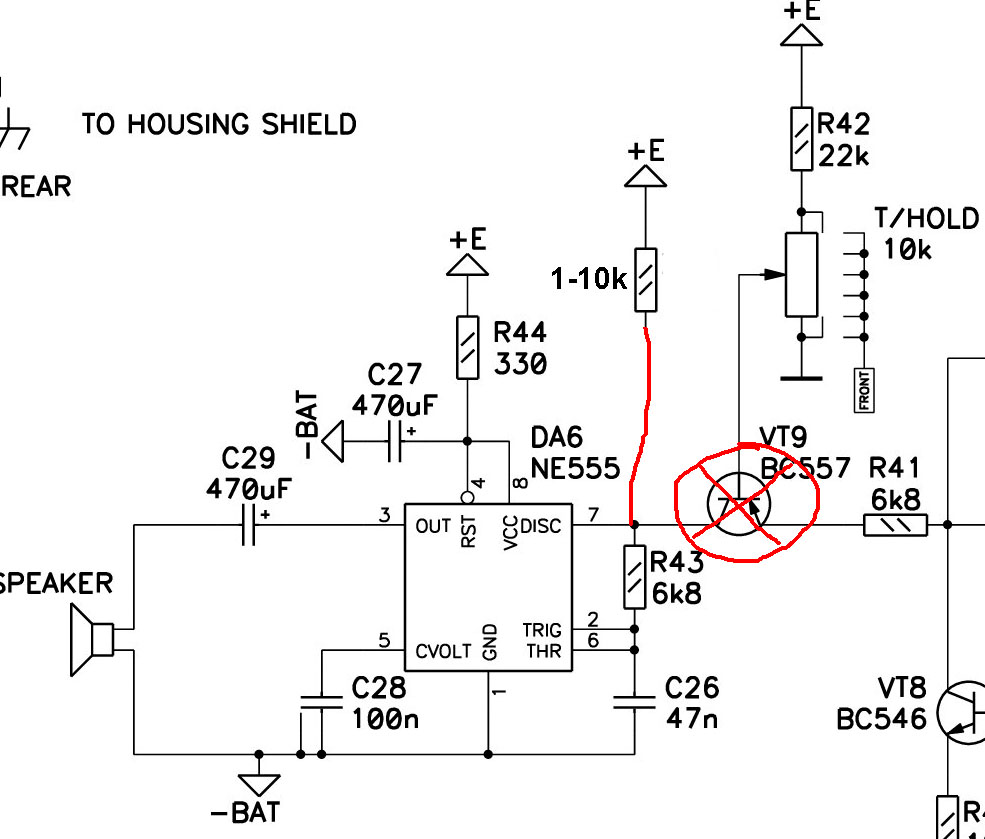

              • i suggested to people to solder just sound part at first. then check. it is simple way to check/get sound quickly in my opinion.
                no o-scope. no tester. simplest way, https://www.youtube.com/watch?v=ODtvLeWdre0
                • Kt315
                  I followed your example with the 555 and there was no sound. Desoldering and measure it, different values
                  compared to a new one. Put a new one in, but still silence.
                  Any advice on what next to check?
                  • in especial done thread i told about HOW to check NE555. buy https://www.banggood.com/it/DIY-Digi...r_warehouse=CN
                    and use.

                      • in this video i show how to check sound with all components. https://www.youtube.com/watch?v=QYlDjdhYp3E
                        YOU HAVE VERY ACCURATELY TO DESOLDER VT9. but i am feeling you will tear the metallization.

                        • you see this method is just classic generator. NOTHING SPECIAL.
                          ali has much generators on NE555 and every can be used for testing of 555.
                          buy with LEDs and you will see your 555 is good or not, looking on the LEDs. those prices are lowest -!

                            Before I desolder VT9, let me tell you that I have no Vcc to pin8 on 555.
                            I have measured the test pins, maybe that can share some light over this.

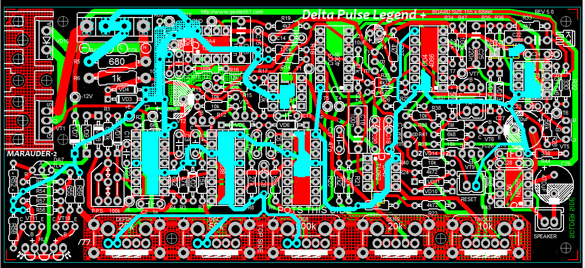

                            • sorry, you can not measure impulse signals like DC signal. all (those) test points for o-scope check.
                              check +E on all ICs and seek up where you got burnt track.
                              • +E hightlighted by BLUE color and you can check the line in every points.
