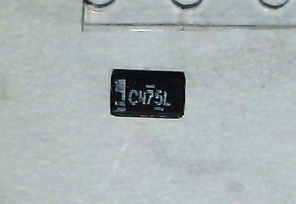

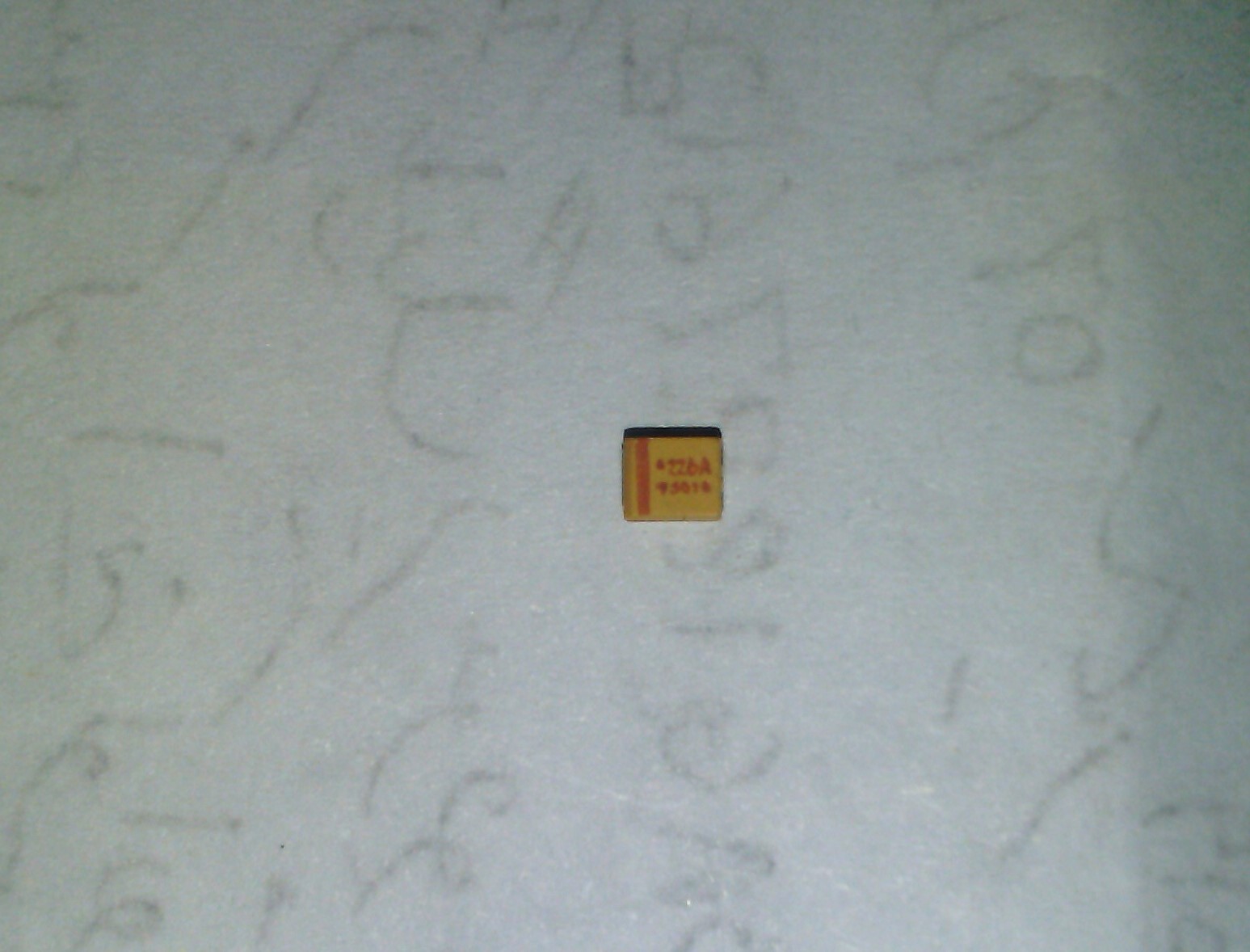

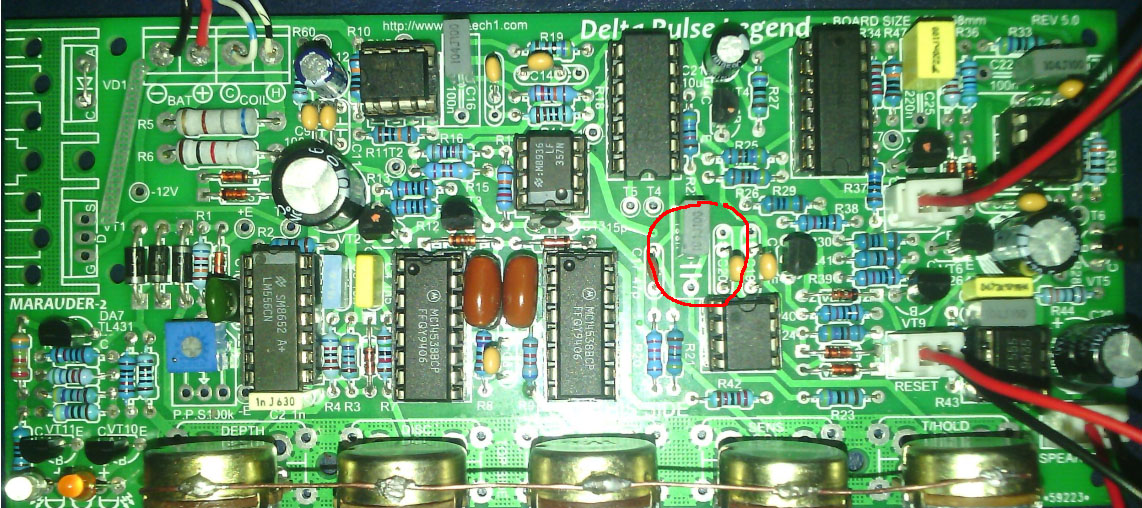

    • I have 22uf and 4.7uf Tantalum capacitors but size is 3216 case A and 3528 case B. Will these work for Delta Pulse Rev5? I think 3528 will solder but for 3218 i have to attach wires..

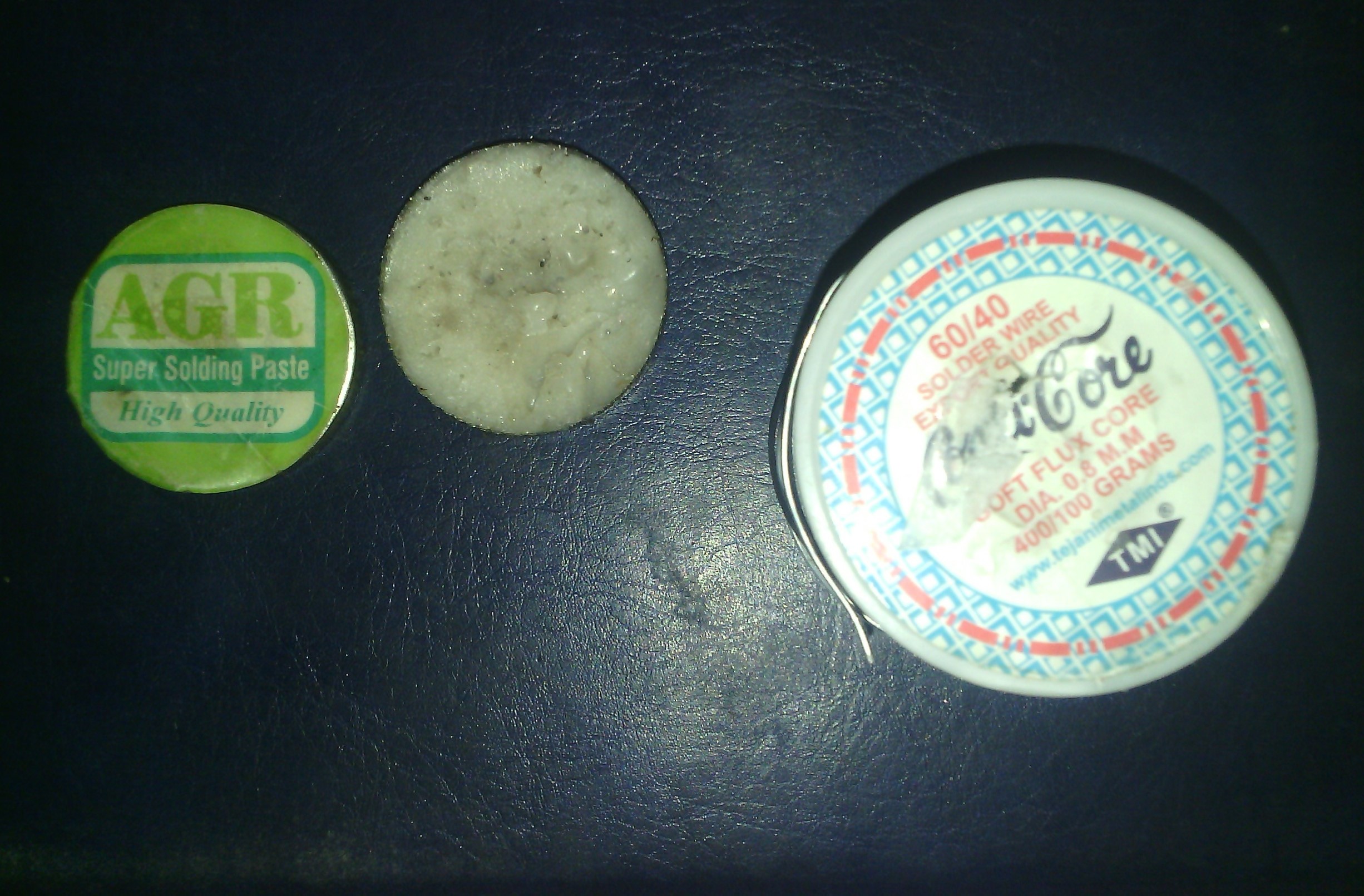

      • use https://en.wikipedia.org/wiki/Flux_(...ium_Loeten.jpg
        use standart ROSIN RESIN COLOPHONY. do not use exotic chinese flux.
        • sorry, i fogot to say. you set tantalums on last step.
            I haven't yet installed the Tantalum capacitors.
            This wire and paste i use.

              why i must give same links again and again? litera A is 10V while i CLEAR wrote to use tantalums on 16V (ie 20V is also good).
                why i must give same links again and again? litera A is 10V while i CLEAR wrote to use tantalums on 16V -
                you do not try to understand what i write. a laziness?
                I bought 10V for C42.
                Ok I see my mistake now. I am going to talk with seller about this.
                • also, you have to clean every C and R pins BEFORE soldering in board.
                  by a resin eraser that school children use everyday. on this pic best one.
                  you clean 'grey/black' oxide layer that isolates the pin from soldering. if you do not want to do that you will get PROBLEMS.
                  EVERY PIN BEFORE SOLDERING.

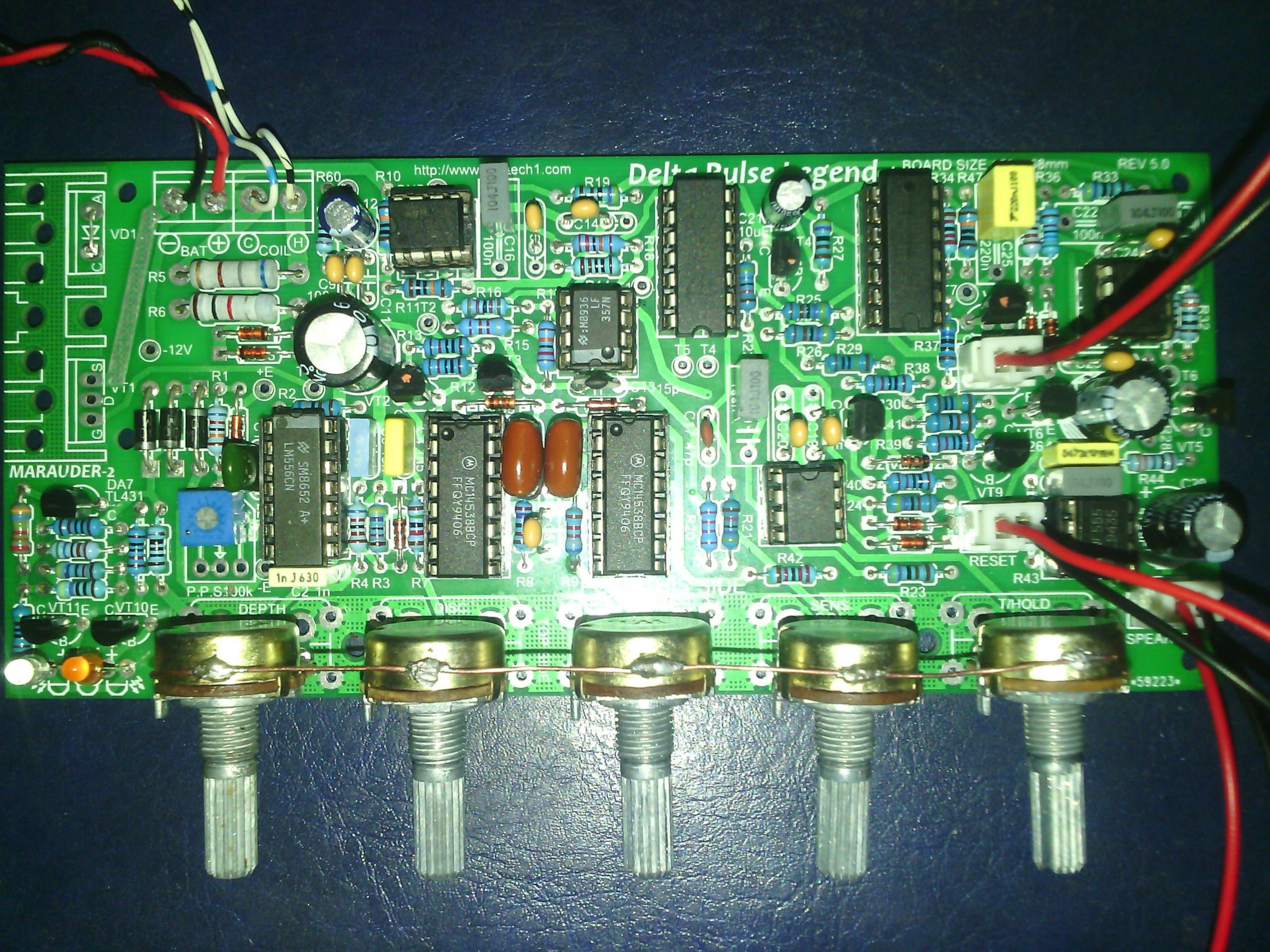

                  • I have installed all components except tantalums.
                    What is the next step?
                    • set 100Hz in point T2 - trimmer PPS. search the signal on o-scope.

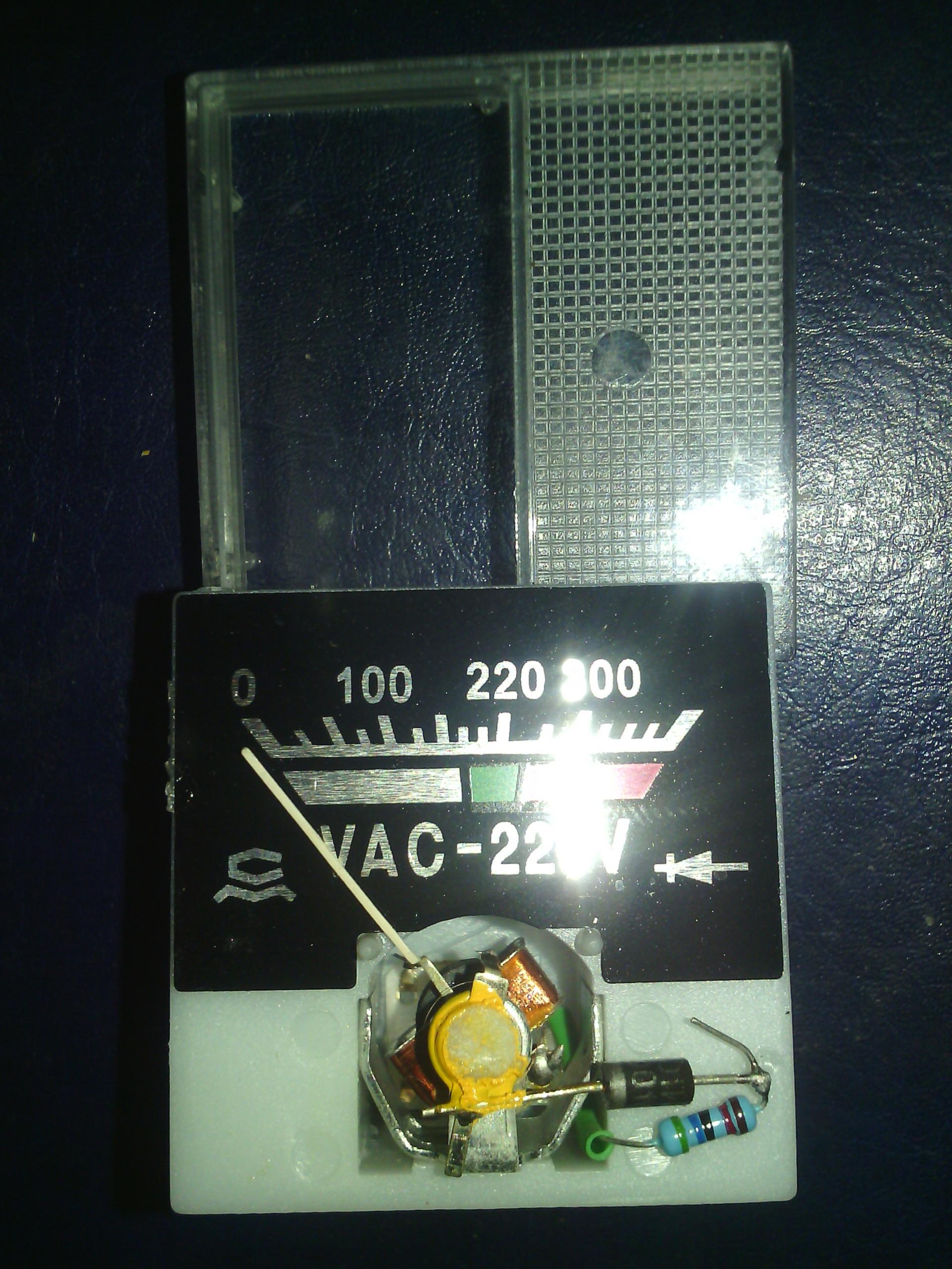

                        This test is performed without installation of MOSFET ?
                        I found a 220v meter that has 56K Ohms resistor and a 1N4007 diode. Can this be used as a uA meter if i remove the resistor and the diode?
                        • chuubaba;262239]This test is performed without installation of MOSFET ?
                          ye, without MOSFET. i write that 3 time. WITHOUT MOSFET.
                          probably yes. at first step do not connect it (to the pcb). it is not so important for work of DP.

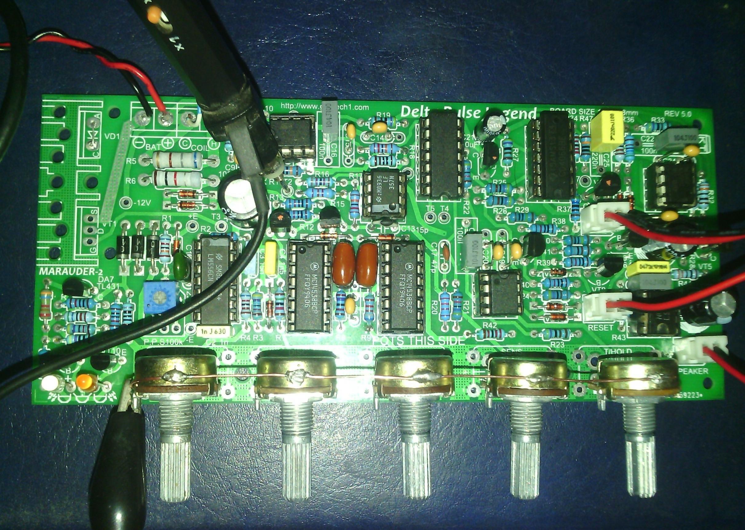

                            • good, but mistake.
                                good, but mistake.
                                Tank you KT. I could not have corrected this mistake without you supervision. I have corrected this.
                                Now i need to know Time and Volts settings for o-scope...
                                I have set the probe to 10x and ground is connected to potentiometers and probe is inserted in T2.
