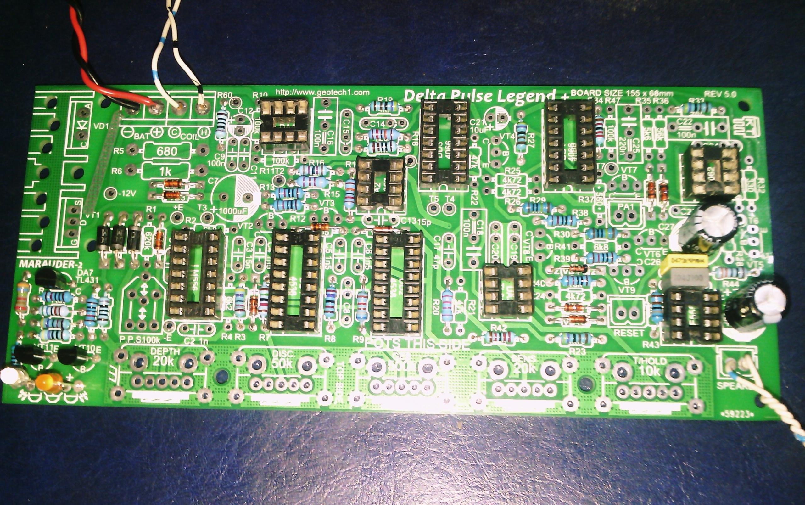

  • solder all except MOSFET transistor.
    • You mean solder all components OR all transistors except MOSFET?
      • all components and all transistors except mosfet.

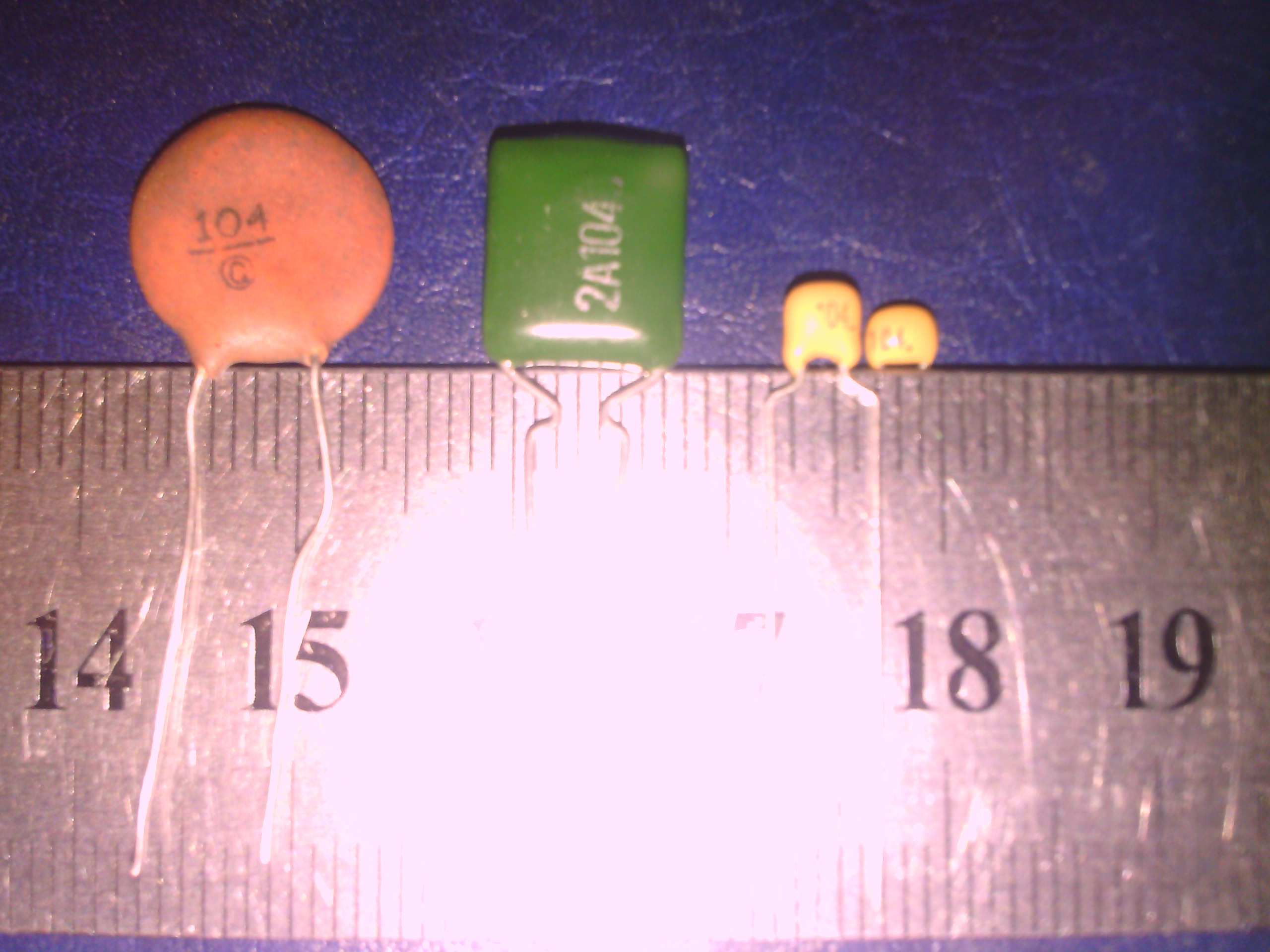

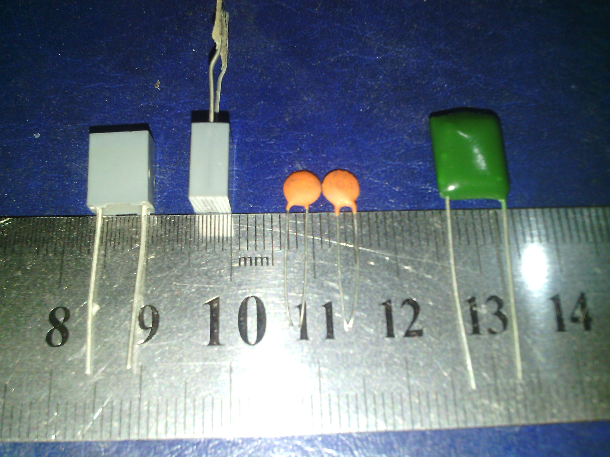

          • Which capacitors to use on Power Line of Delta Pulse? These are 100nf and 150nf.
              • I am trying to make 6k2 resistor by coupling two resistors of 3k 5%. The multi-meter shows the combined value as 6k56. Can i use this for R2 on Delta Pulse Rev 5?
                Also i can't find R1 620k ? How can i make this resistor?

                    What other values can be used for R1 and R4?
                    • Most of this waste is used laptops. The most common fault is a dead battery or a broken display or a faulty USB port. These are repaired and then sold.
                      • any values. you must get 100Hz frequency and 100-500us range PULSE WIDTH.
                        so a sence not about values here.

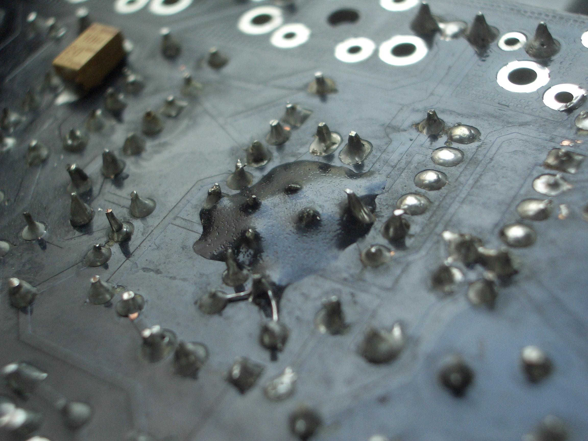

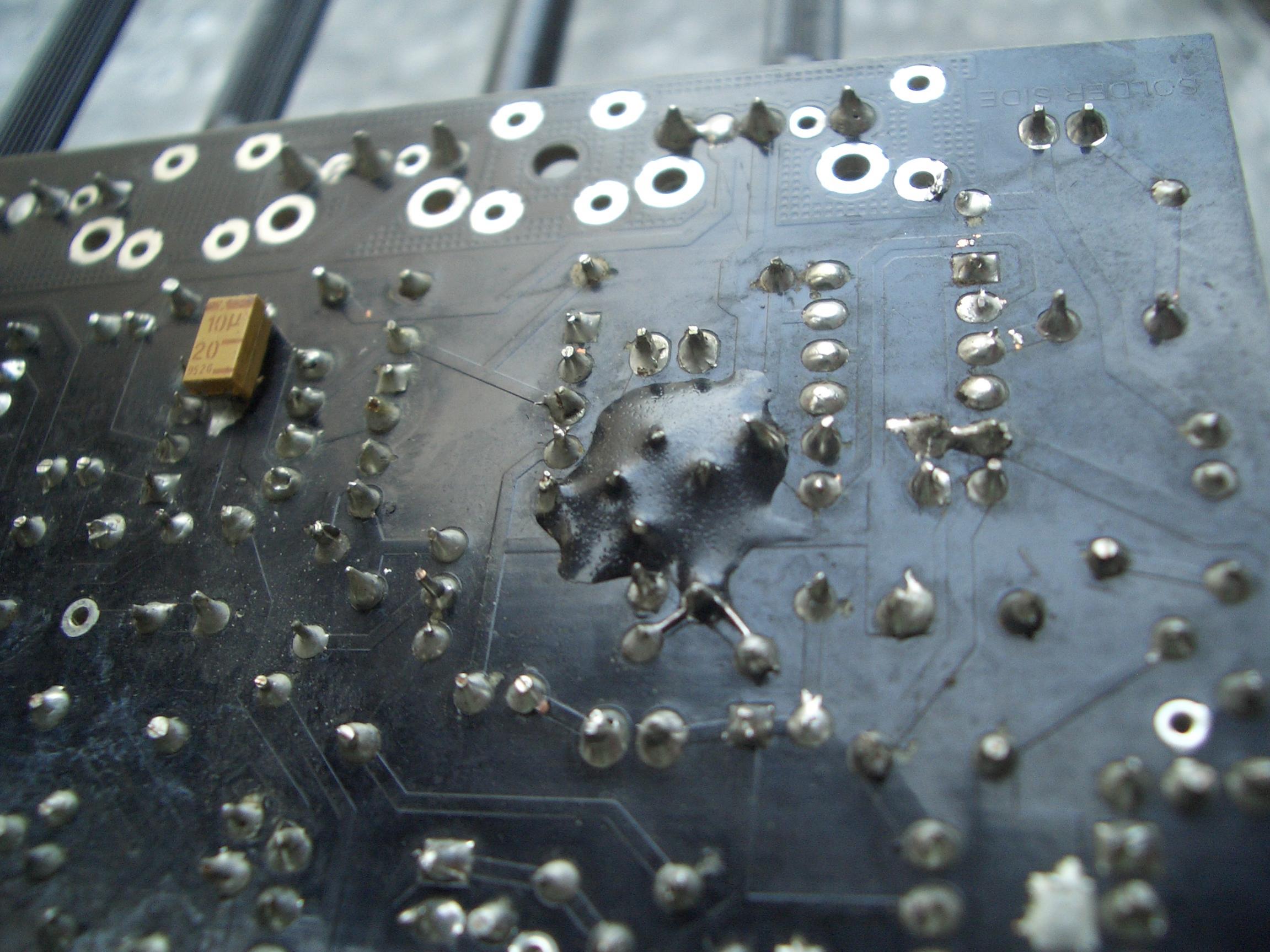

                          • i fear you set now for example 560k then later you will want to change it on other value. but practic had showed people
                            do not able to solder and desolder. they kill board tracing/copper layer (i reminder you that boards were ordered in China, not in USSR where
                            the copper/gold/silver were like a trash metal. soviet boards were done with fat layer of the metalization). i get this board in repair and see the horror.
                            those people rush me to fix their pcbs as fast as possible -!!! amazing people... why you do not want to hear what i say you everyday???
                            learn to solder on kits before to do metal detector.
                            • the board of customer after my repair. DO NOT BEND PINS OF COMPONENTS ON PCB BOTTOM SIDE
