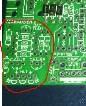

  • yes, do next. solder voltage indicator part.

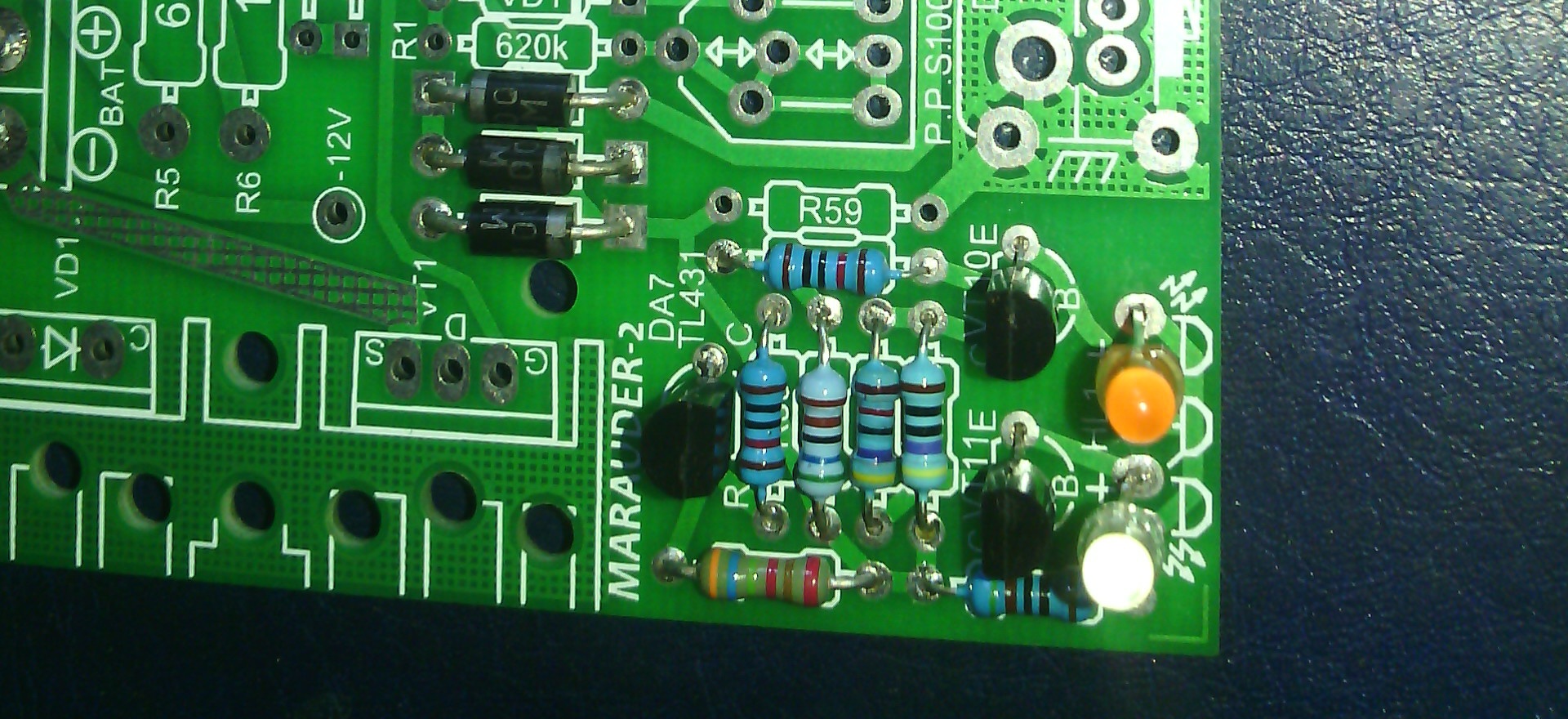

            What components make the voltage indicator part? Any pictures or videos?

                    Is this the voltage regulator part?

                    • not. this Click image for larger version

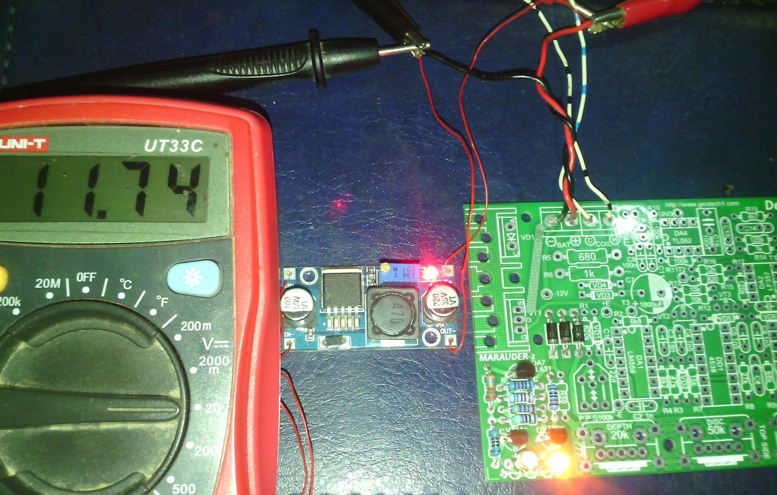

ID:	355303Ok. I have completed power regulator as shown in your picture. How to test this?
                        • turn on your power supply and change voltage from 11 to 12V. you must see how red color changes on green.
                          • Do I need to install NE555 for this test?
                            • The red LED is ON after voltage drops below 11.75V.
                              I performed this test without installing NE555 and loudspeaker.
                              • What is next step to build?
