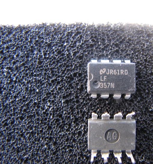

        • As noone reply on my post for LF357 i source them from Bulgarian online shop. How genuine they are is early to say, so will let you know once the machine is running. For now will try to share photo so the experts can say their word. The price was around 3 euro.

                            • Here we are. The national semiconductor sign looks a bit strange. Is there a way to test these ic's on a bench?
                              • Originally posted by nonkapo View Post
                                The original national semiconductors chip has a stripe on it.
