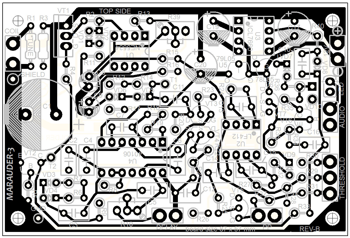

            • #96
              in new board i did small corrections
              - one cap removed on 0.254mm aside (LOL)
              - added + symbol on bottom side to tantalum (LOL)

                Originally posted by abdennour View Post
                I bought several PCB of Silver Dog, I want to know which is the best between your PCB and Geotech Baracuda (Rev-A) ?
                Both boards will provide similar performance as they're based on the same design. The Geotech Baracuda incorporates a number of changes to fix several design issues, but with the idea of keeping as close as possible to the existing design. I believe that KT315's version now contains the same fixes, or at least is capable of being modified. It's basically down to which board size is best for you, and which one is easier to purchase from your location. Silverdog provides both blank PCBs and complete kits, and (correct me if I'm wrong) KT315 provides blank PCBs.

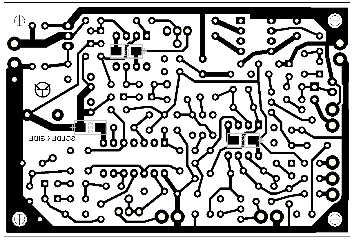

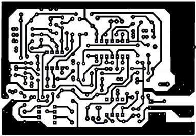

                        • Lets also see both sides PCB design in any format. One last time
                          this upload i do especially for George ONLY. noticed some people do not follow my posting and do not read what i write.

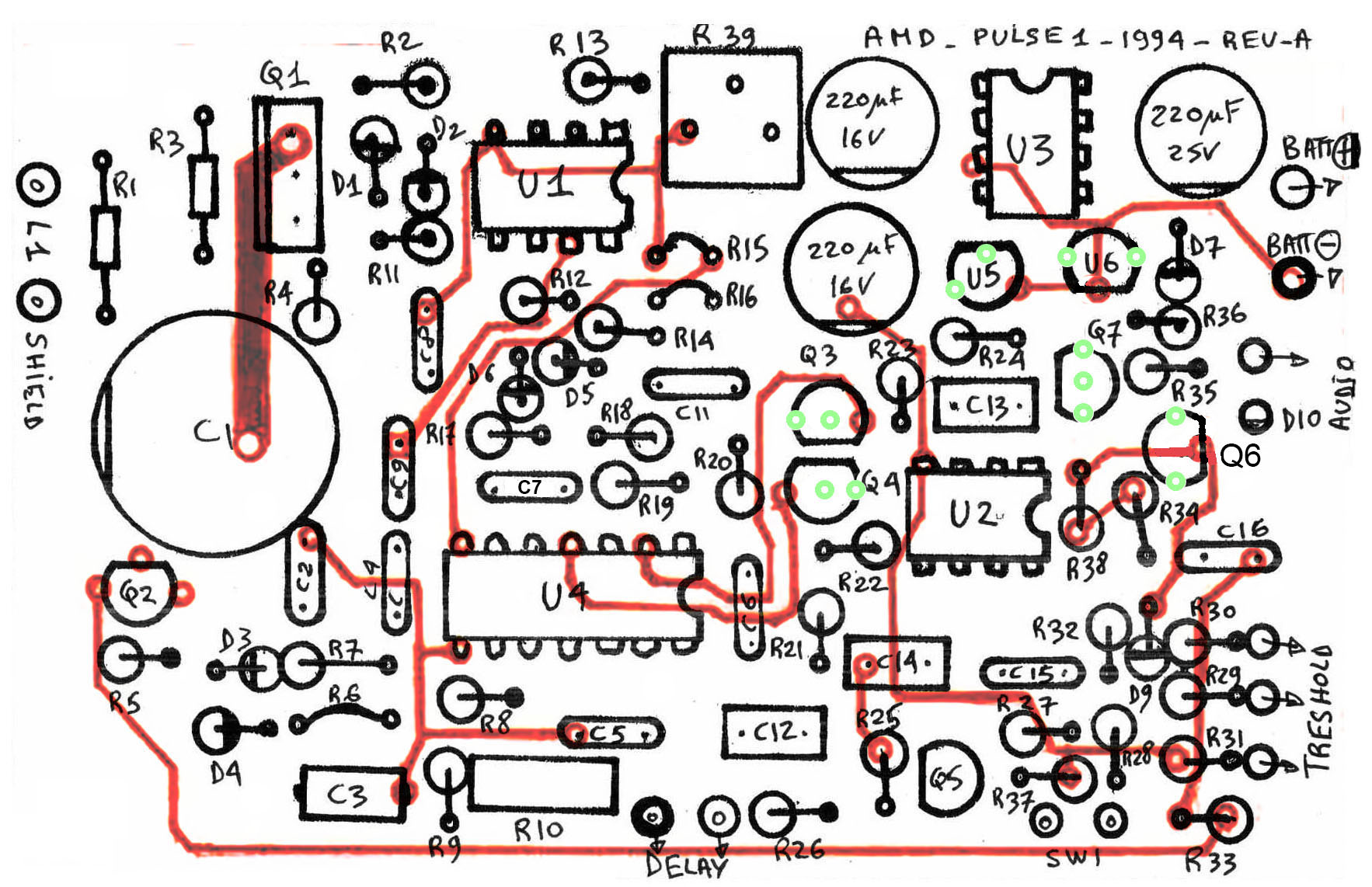

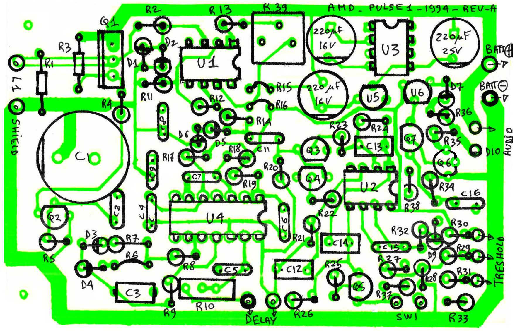

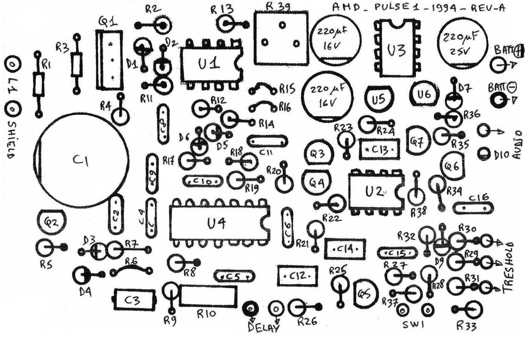

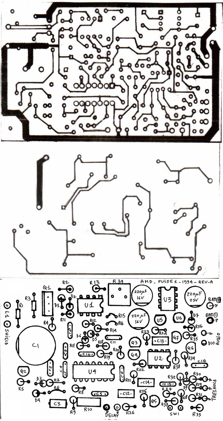

                          • both side
                            • original board. drawed by PAPA ALEF with mine superposition of layers.
                              • PAPA ALEF
